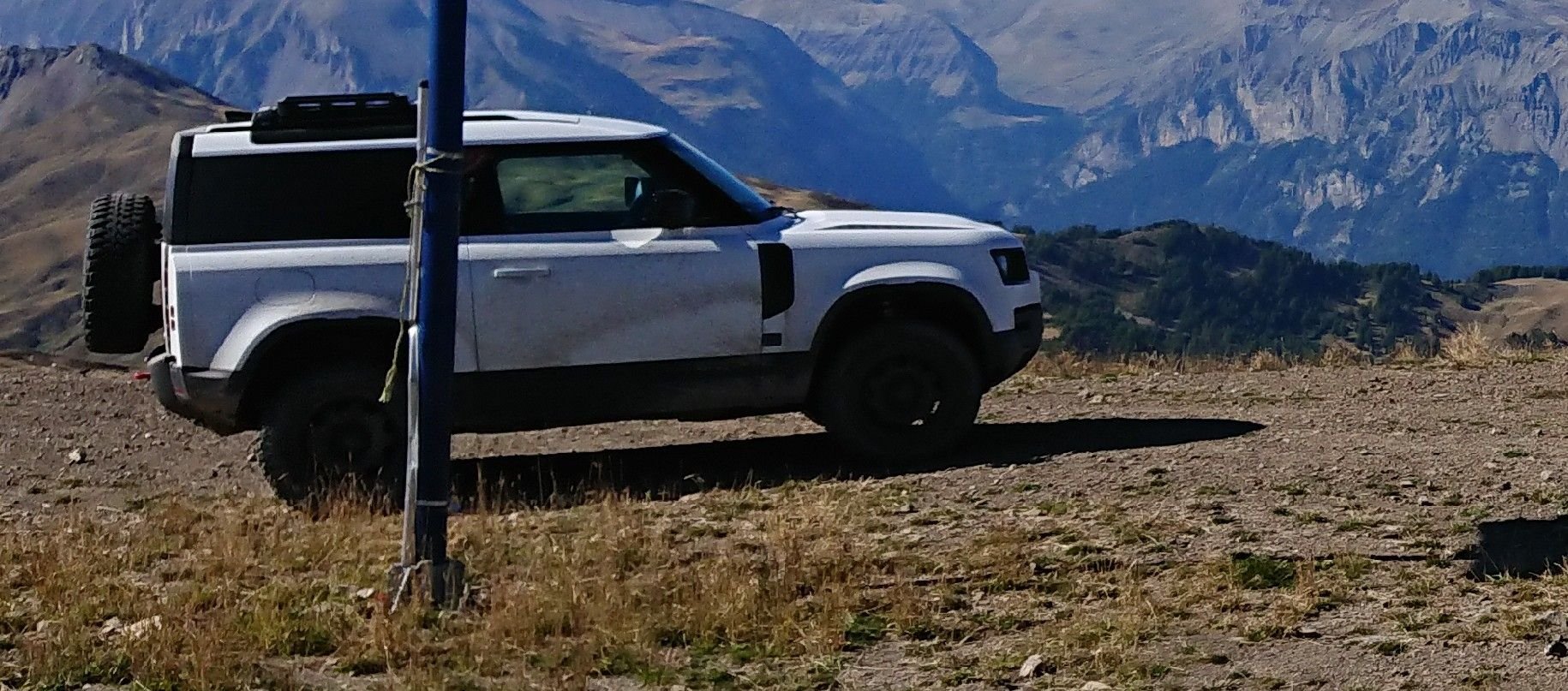

Some options:
1. Just use spacer rings, enough thread left for securing the wheel.
2. Space the carrier, 1/4" no problem, some work.
Picture down here with just spacer rings
