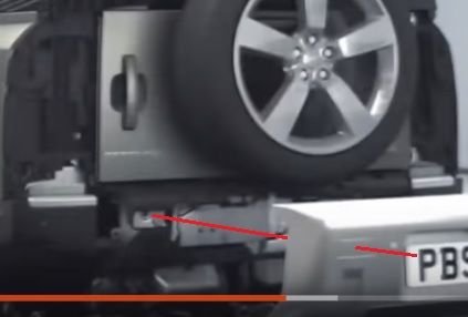

Thats the bumper cover, I am talking about the actual bumper that seems to be missing from images. One with no cover would make help explain things a little better.
This image shows the bumper cover removed. There are no rear recovery points under it but there appears to be a single large bolt hole behind the rear bumper knock out that could accept a perhaps separately supplied eye bolt with the tool kit. This would suggest that if stuck and can't access the front recovery point (if it is stalled from the factory and under a removable fascia) you would have to remove the rear bumper knock out and bolt in a recover eye. Seems ridiculous. I'm hoping if the exposed recovery points do not become available as factory ordered accessories for models other than the X that the recovery eyes can be purchased as separate parts and installed after delivery.

Well I dont think it took five hours to get the plate off, its just quarter turn plastic screws like on the LR3. I just think that during the recovery it was an issue brought up that they decided to address. I am sure in short order there will also be aftermarket plates one get install, like on the LR3/4, that expose the front recovery point.
I found all this simply searching Google.
I wish these images showed the rear bumper, but its not even installed for some season. The front, however, you can see the clearly integrated recovery point.
