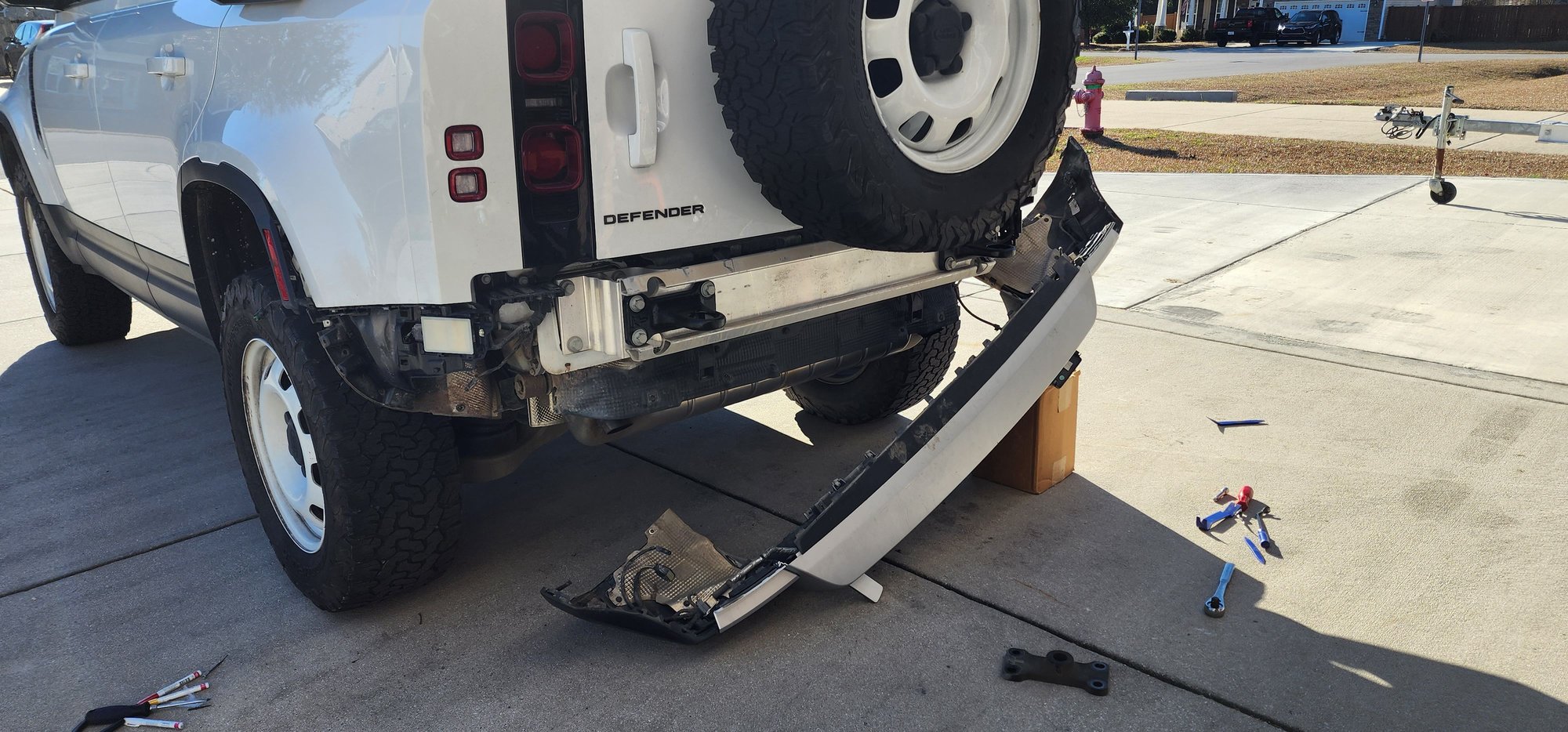

From what i remember they're kind of hidden up there near the centerline of the bumper. I missed one of them due to it being relatively out of the way compared to the others
The little bracket things

If you don't have the flaps, it is a relatively straight-forward affair. Knocked it out in under an hr with basic hand tools. Probably would have been faster if we weren't goofing around stopping for refills on our adult beverages.
Can't imagine it is much more involved with the mudflaps.
Pretty much the extent of the tools used.
