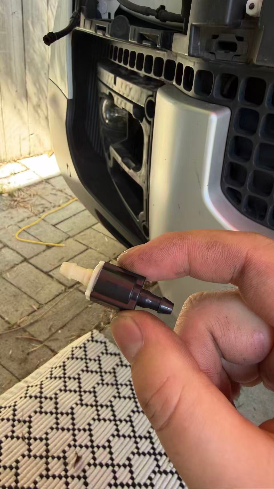

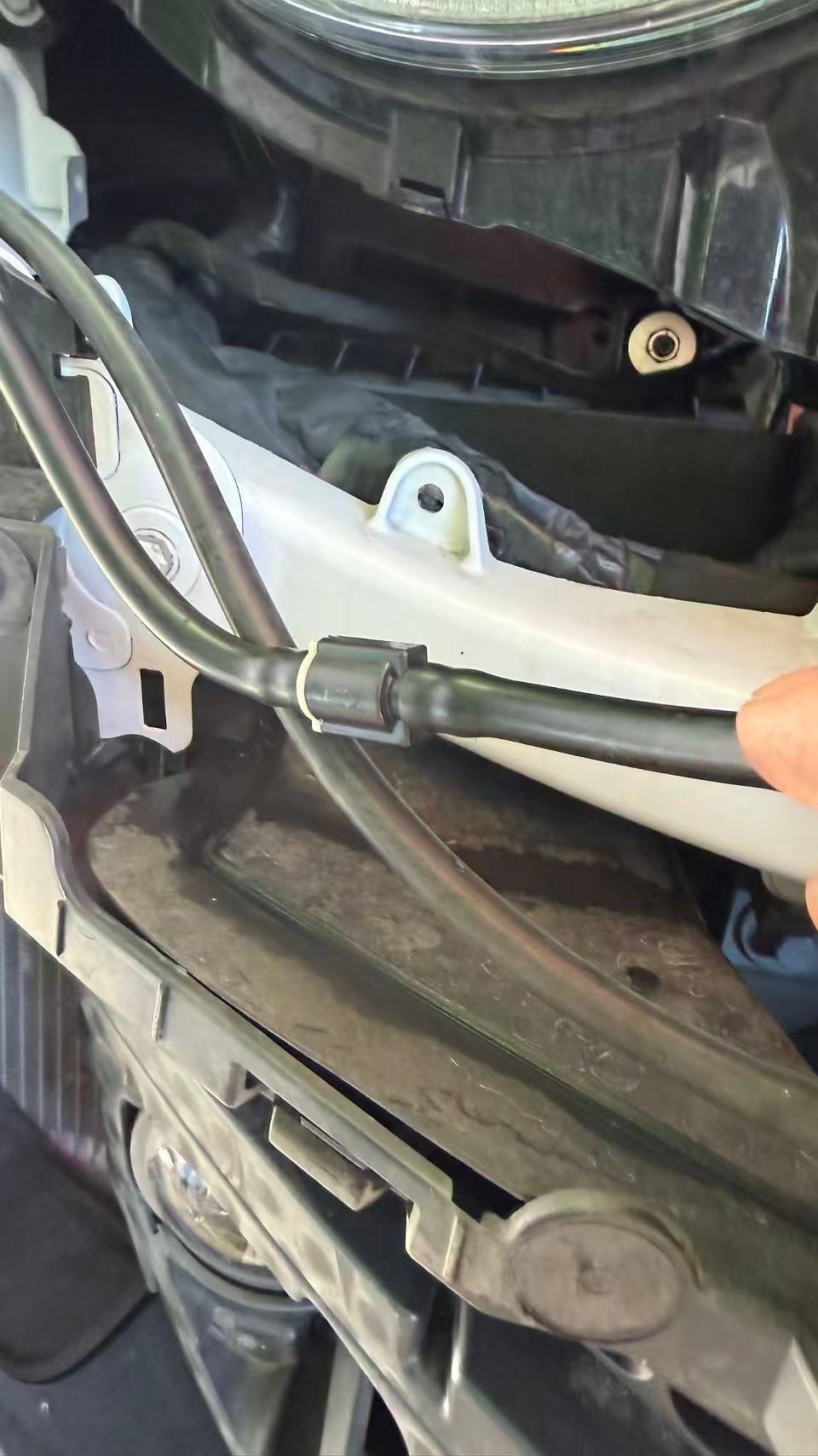

I own a 2021 P300, and I had been constantly plagued by a leak in the washer system for the right headlight and rear backup camera. I’d like to thank the fellow forum members who guided me on how to resolve this issue. I purchased a windshield washer check valve and installed it. I simply located the front end of the leaking hose—right at the nozzle—cut it, and attached the new valve. The problem is now perfectly resolved!
