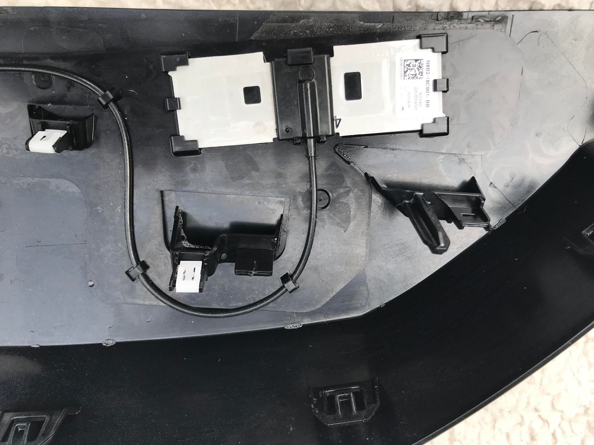

(took this after I removed it but spraying liberal dish soap/water solution in the cracks)
No broken tabs
What the trim piece looks like removed. Will store in garage.
PS - Annoyingly clearly the dealer broke this when they replaced the X taillights under recall last year. Wasn't me!

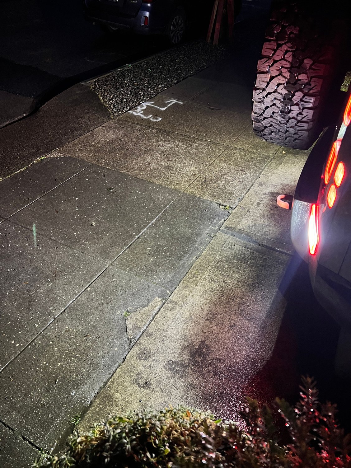

ARE THEY BRIGHT?
Yes, decently bright. A noticeable improvement from stock reverse lamps in illuminating the ground behind the car. I can now see the ground and sides of driveway when backing up whereas before I could not. Rear camera view on the center Pivi screen is more useful. Clearsight mirror camera - not so much (it's more useful for a couple car lengths behind the car anyways).

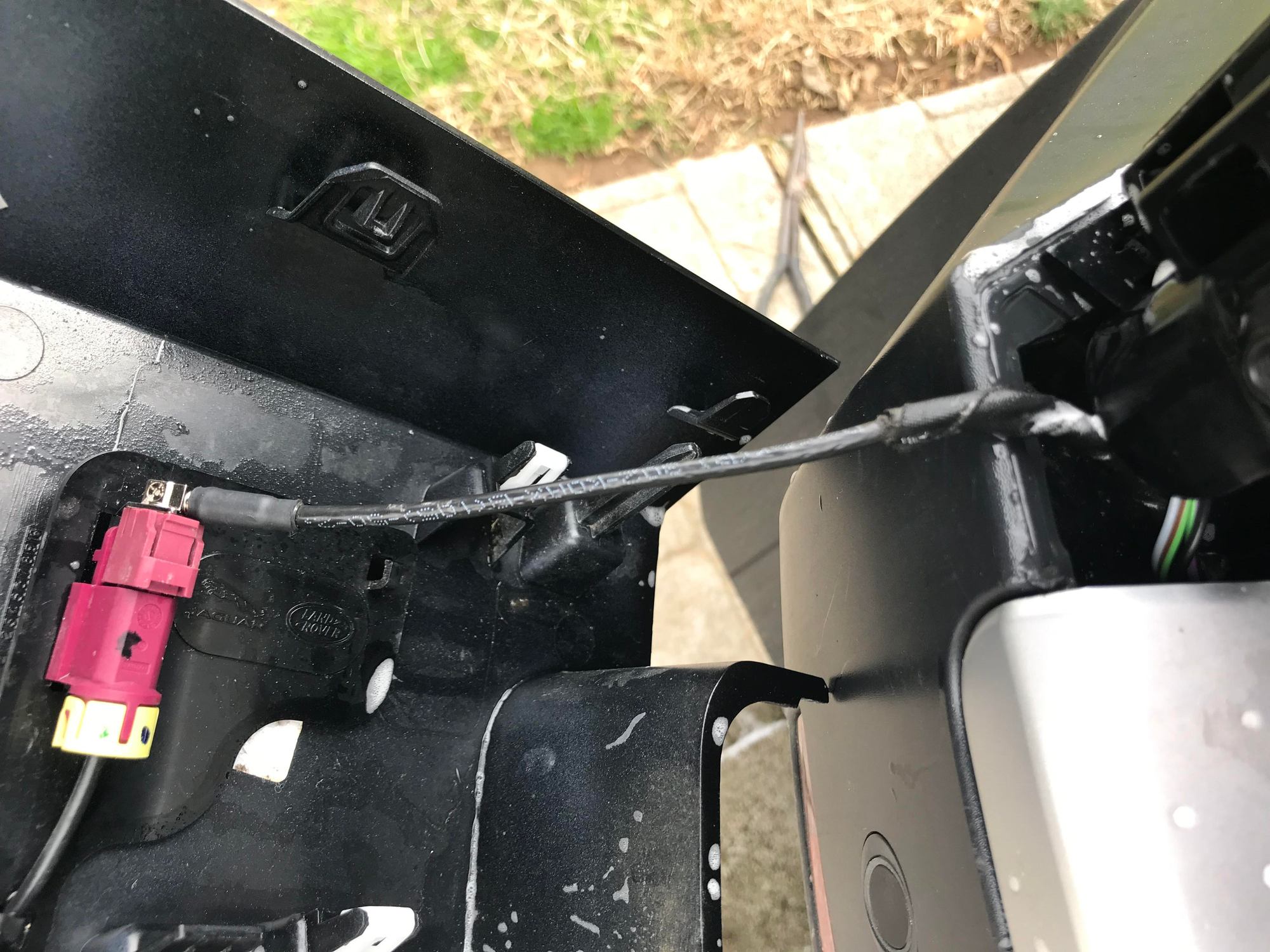

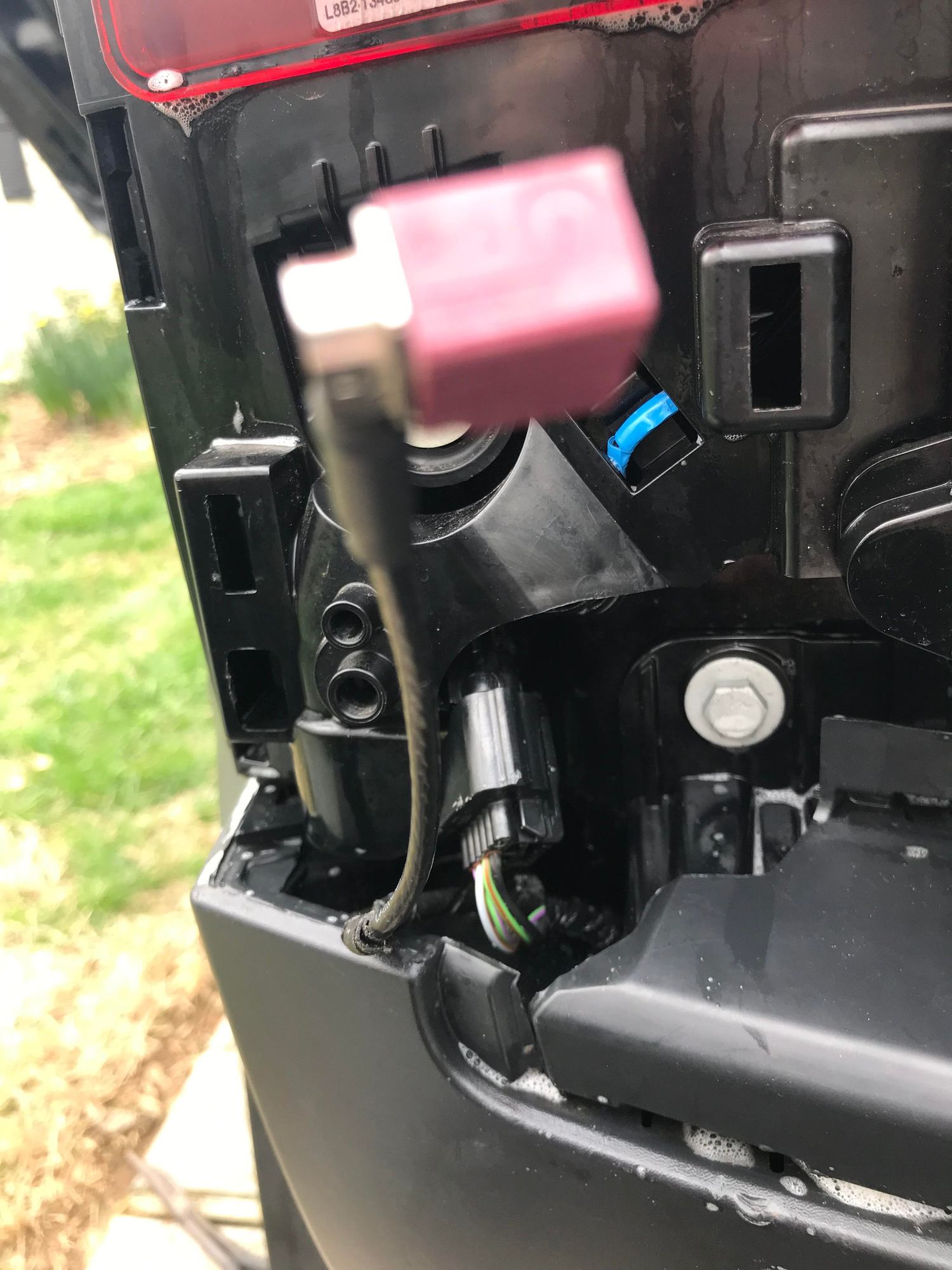

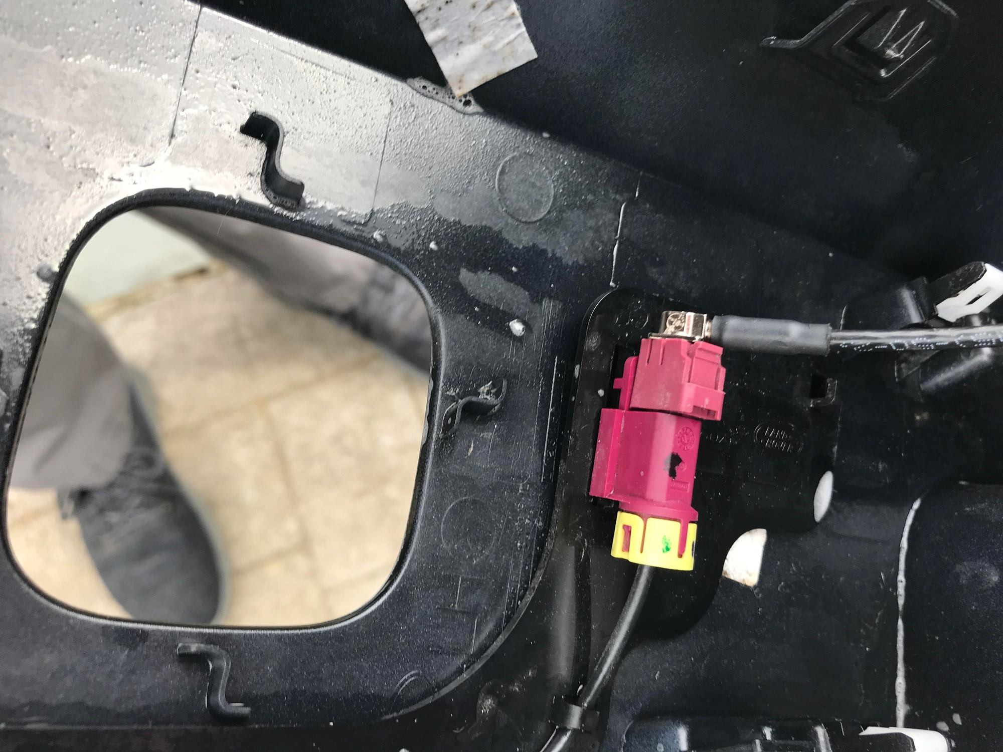

I got the left side rear lights cover off (tnx for the soapy tip, nashvegas!) and to my surprise saw this wire:
Unknown wire
Not at all sure what it does and have not seen it mentioned anywhere. The wire on the right comes from the bottom of the lights area and makes this connection on the inside of the cover.
then goes up the cover and terminates here:
I tried but could not get what looks like a QR code to open anything.

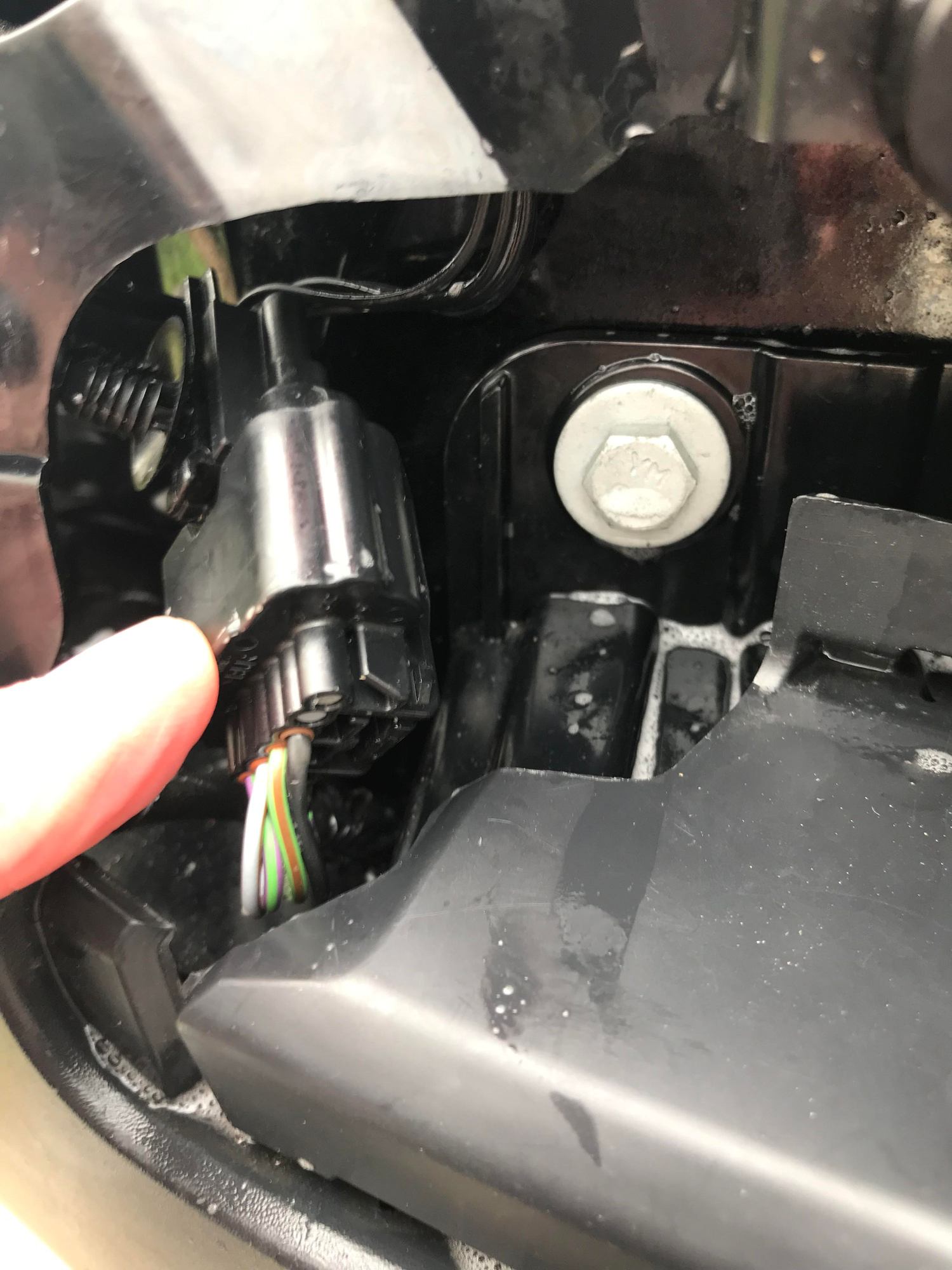

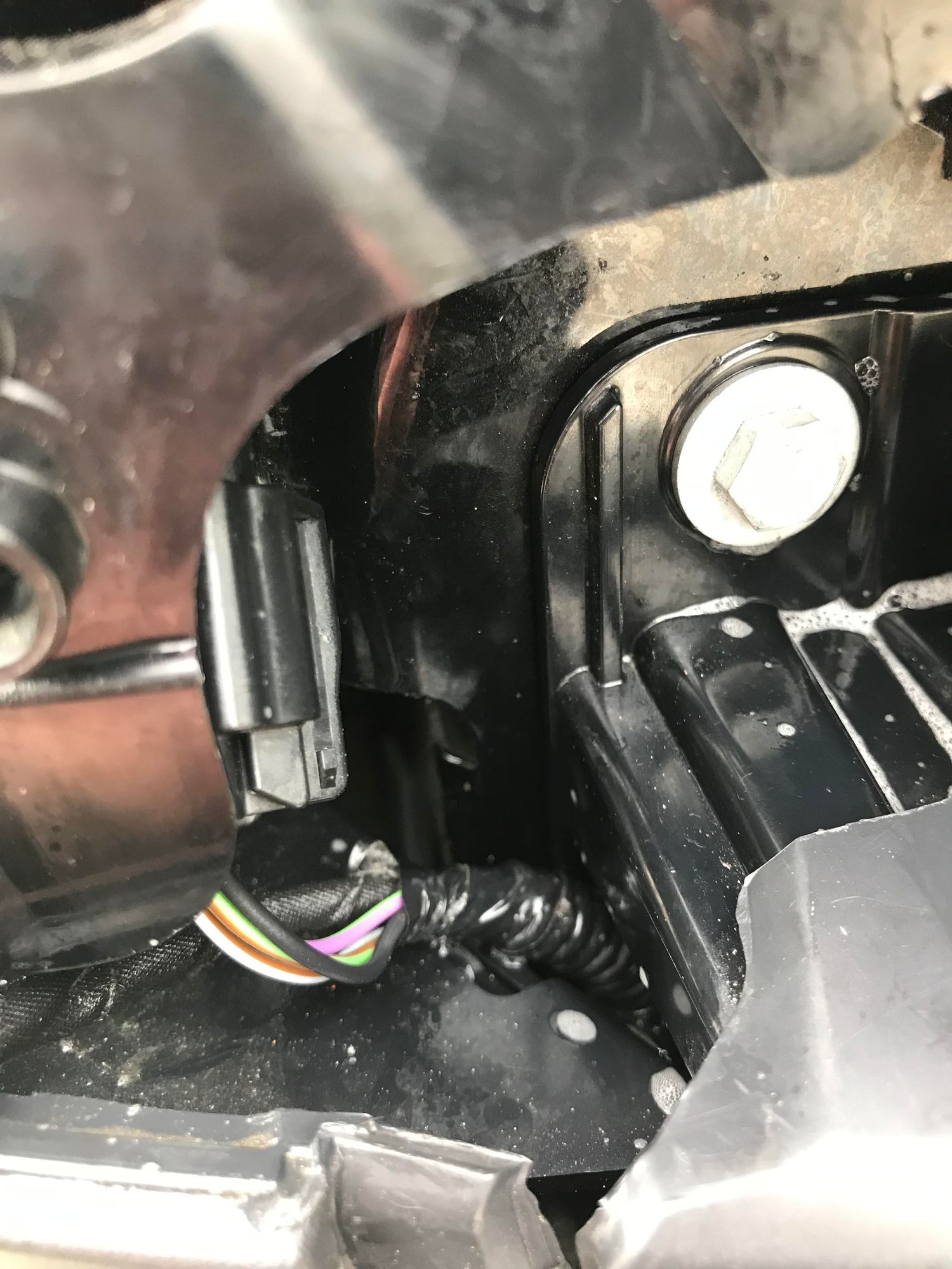

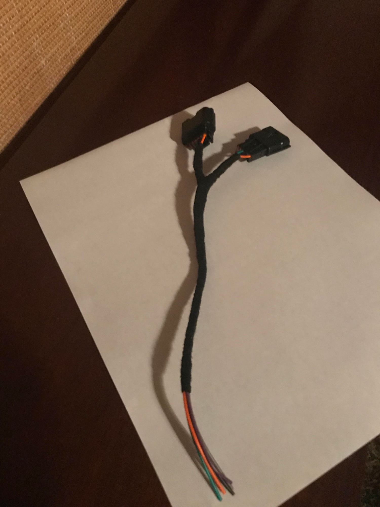

In addition, the two-pronged wiring (see photo below) harness does not resemble any photos or videos I’ve seen. This is the only part that comes from up above:
The loom in Simon’s upgrade video comes from the top and is pretty easy to get at. Mine seems to be down below the shelf area and after many attempts I gave up trying to pull it out. There really doesn't seem to be enough room to get it out unless more is dismantled.

1) I have read that this is the "cellphone signal booster" but I am not sure. I would have thought my X (fully optioned) would have a cellular booster -- but I didn't have that on mine. Maybe it started in 2021? Anyway, there's an option that is "wireless charging with cellular boost antenna" or something of the sort. I think that's likely it. Do you have that? Those connections to me look like standard car optical / fiber optic cables, like you might find on stereos, amps, instrument cluster, HUD.. .and certain antennas.
2) I had the same issue about where the harness and wiring was. In the PowerfulUK video it's simply up above and he just digs it out. Mine was also stuck completely behind the bumper below. Exactly where yours was. I forgot to mention this in my writeup. That said I was able to get it out as I only needed to put the connector on it. Did you not get a male/female connector to jumper in between where the main plug is?

How did you get it out from behind the bumper??? I tried fingers and long needle-nose pliers but stopped as I was fearful of pulling and wiggling too hard, not wanting to break anything.
Is the “main plug” the connector shown in photos 4 & 5 in my post? The one that does come from above? That doesn’t seem right but is the only connector I can actually hold.

Yes, I got two of these:
Anyway, thanks for your help.

Yep, all you need to do is remove that "main plug" from its two mounting prongs, then disconnect it from itself. (a bit tricky but there is a tab to push).
Do not I repeat do not use pliers or vise grips or anything like a screwdriver to prise or forcibly disconnect these modern LR connector housings. They break / the wires break. Once you depress the right spot, they'll unhook. Also only pull on the connector plastic body, not the wires. (this may be obvious but I am experienced and recently broke my main front radar connector doing just this...)
You're then left with a male end and female end unplugged. Install the corresponsing plug ends you received from Powerful on that, and then you wire the dangly wire bits to your reverse lamps! (which is easy to do off the car / away from the cramped space)
So really - you should be fine. You only need access to the "main plug" in your pics 4/5 above.
