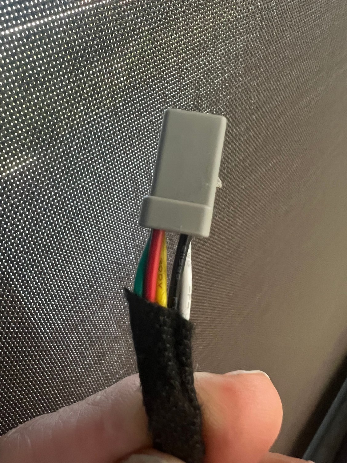

Interesting. The Sal-Man reverse lights I received have a 5 pole connector and the color scheme was changed. Instead of Black, Blue, Red and Green, my version has Black, White, Yellow, Red and Green. I too wanted to clip the surround light and leave only the reverse lights to come on, but am uncertain at this point if the Red and Green still control the surround light. Does anyone with the "updated" five pole connector know which wires control the surround light?
Best way is to ring them out with a 12V power supply. Using a pigtail, or short piece of wire, hook up Black to a ground point, then attach each of the other colored wires to +12V and see which color wire lights up the corresponding light, either White, or each level of Red.
