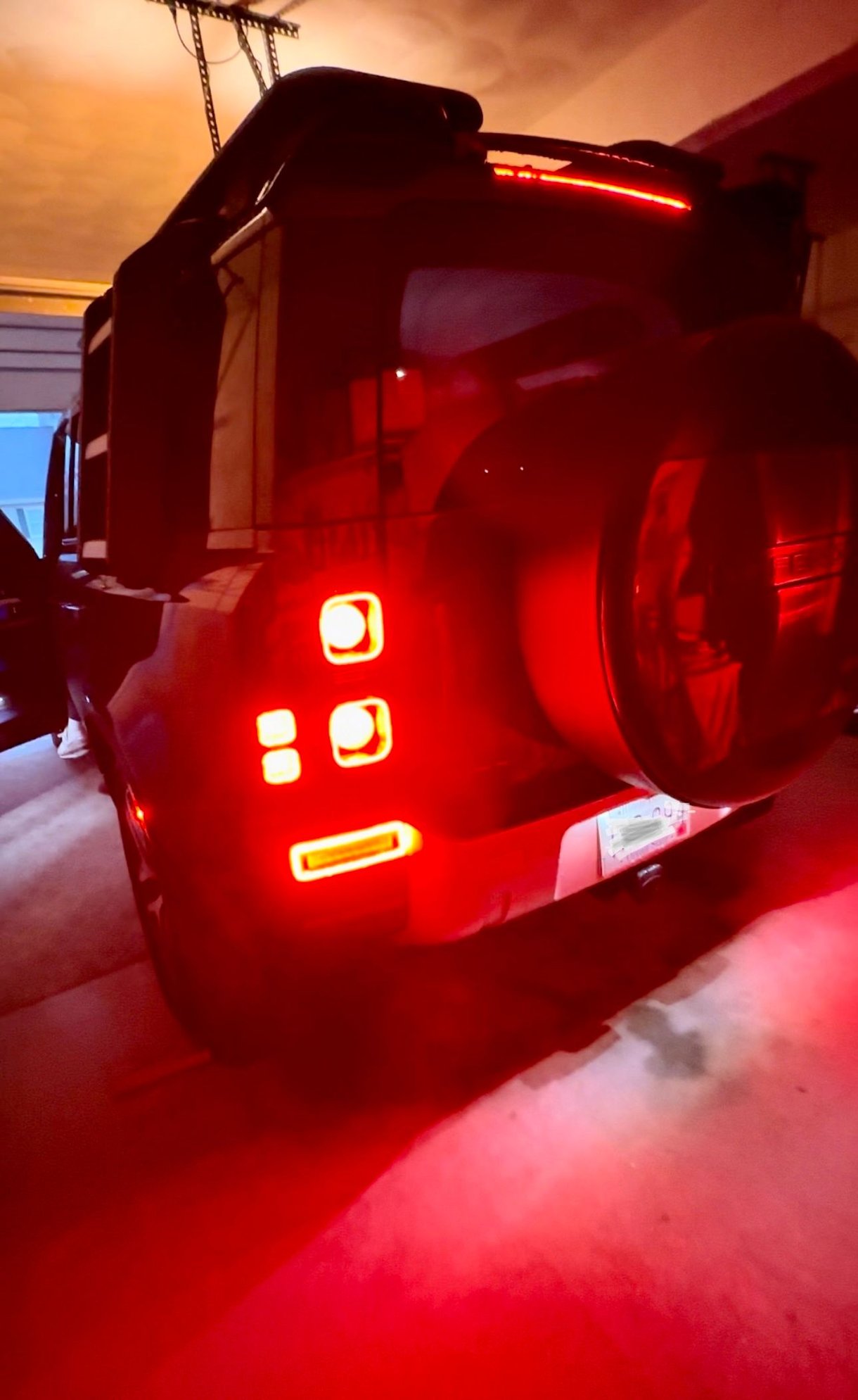

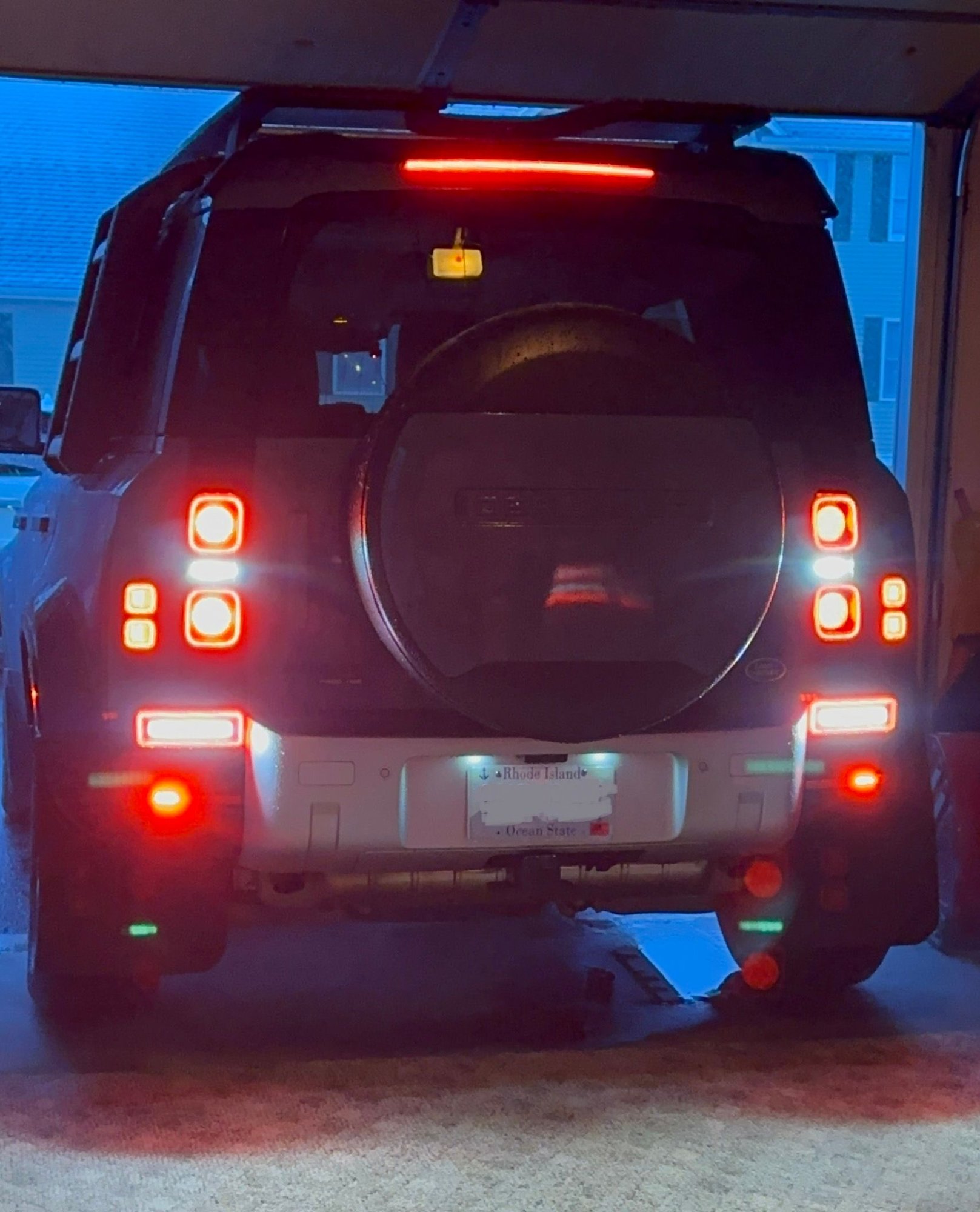

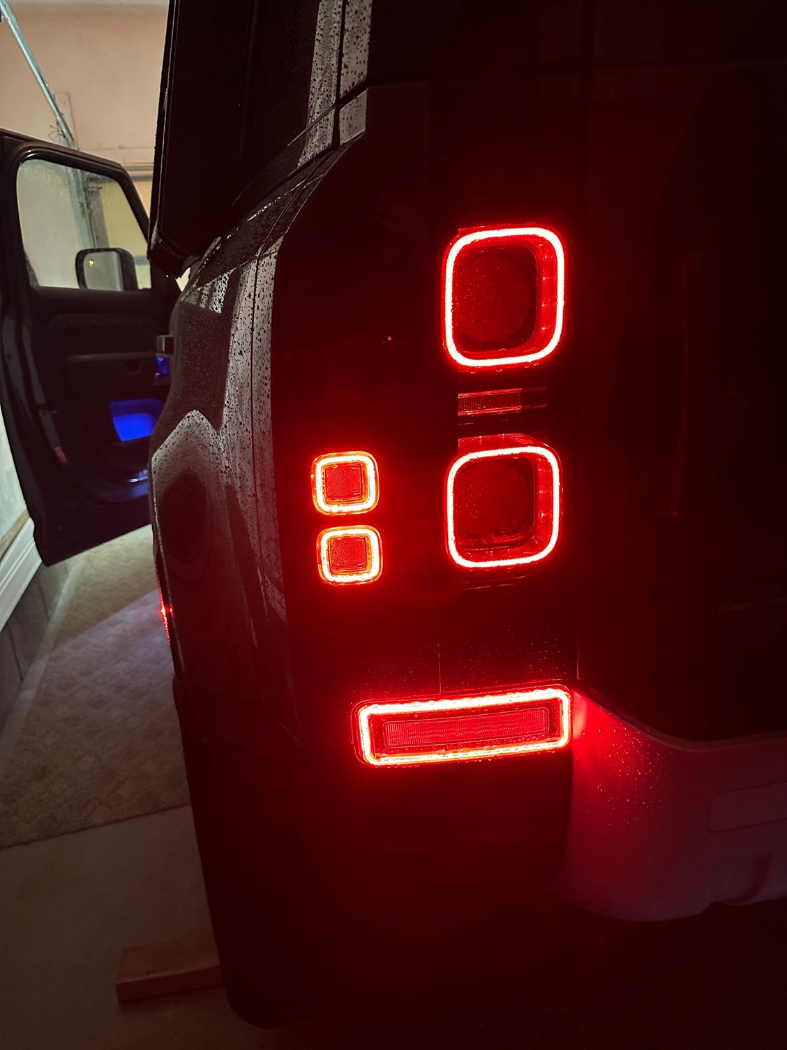

Default Just installed…
…..and so far so good. The colors match well including the red led compared to the OEM ones above….

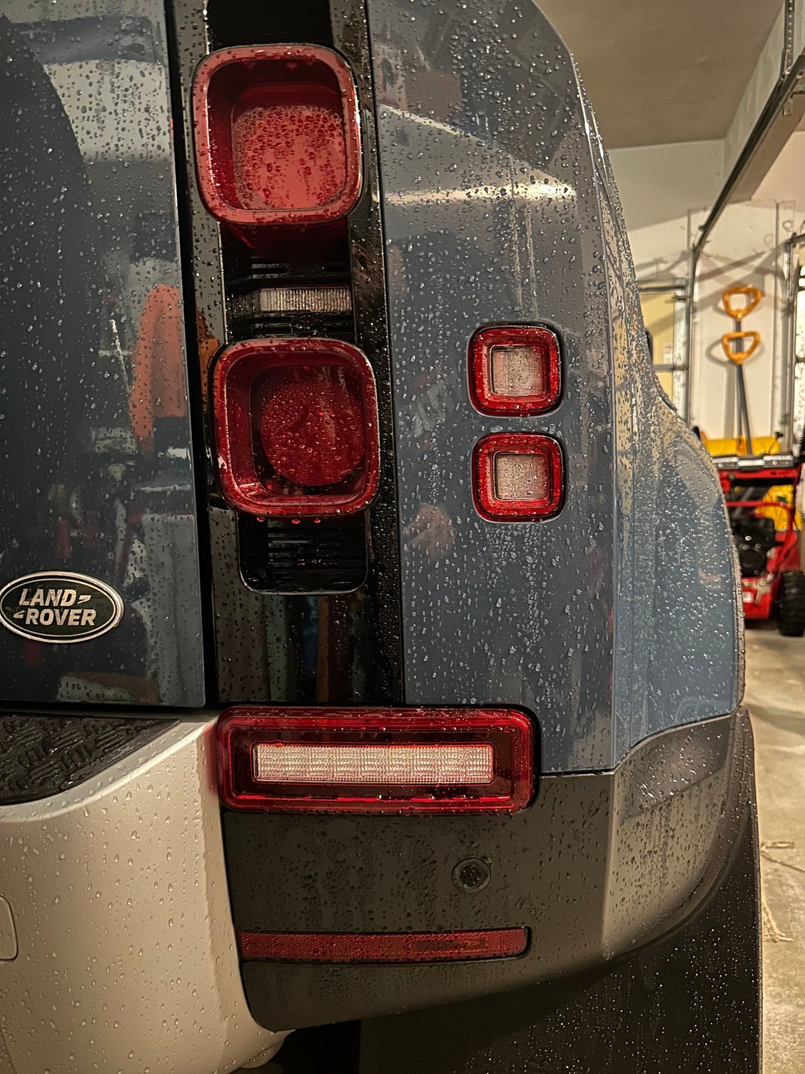

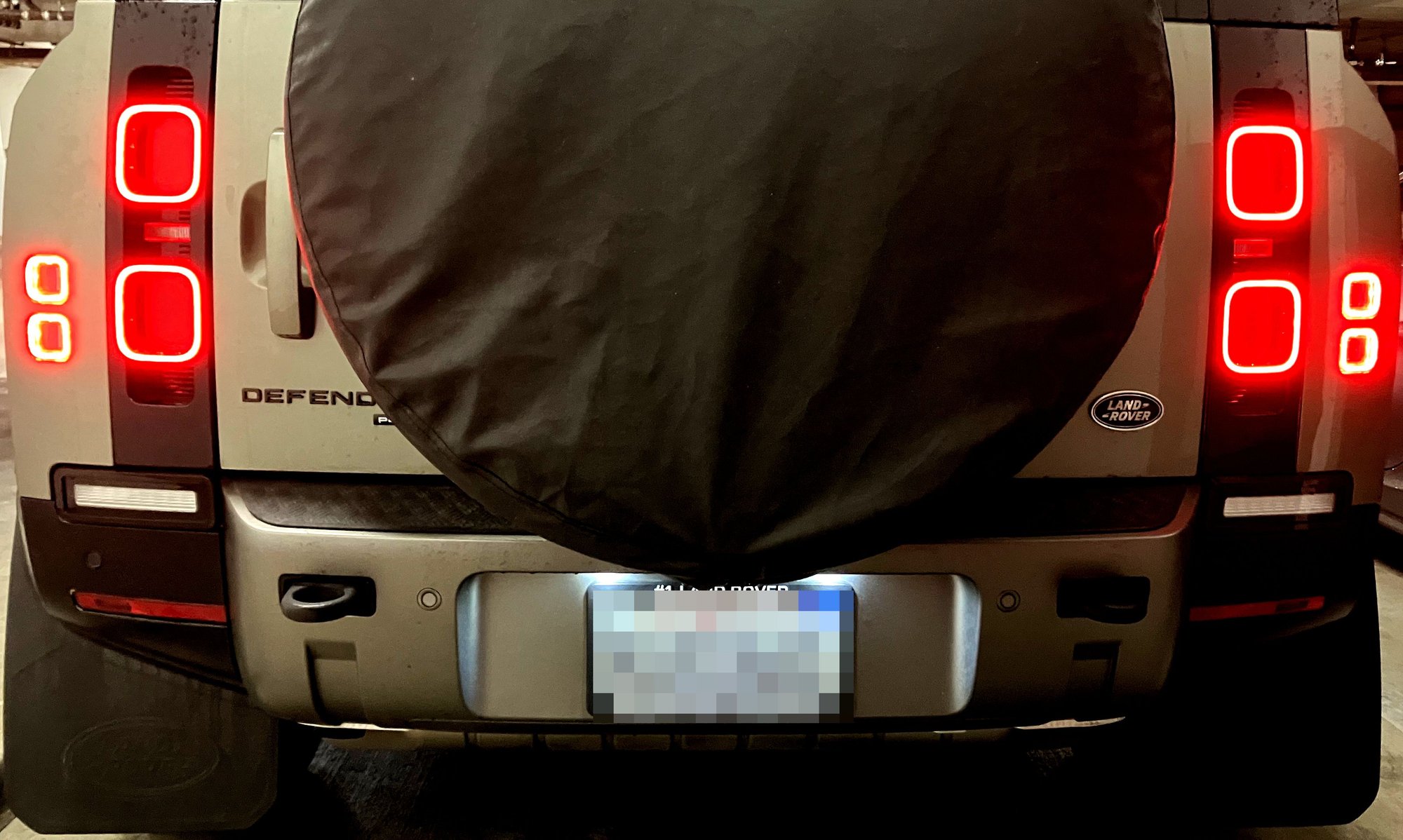

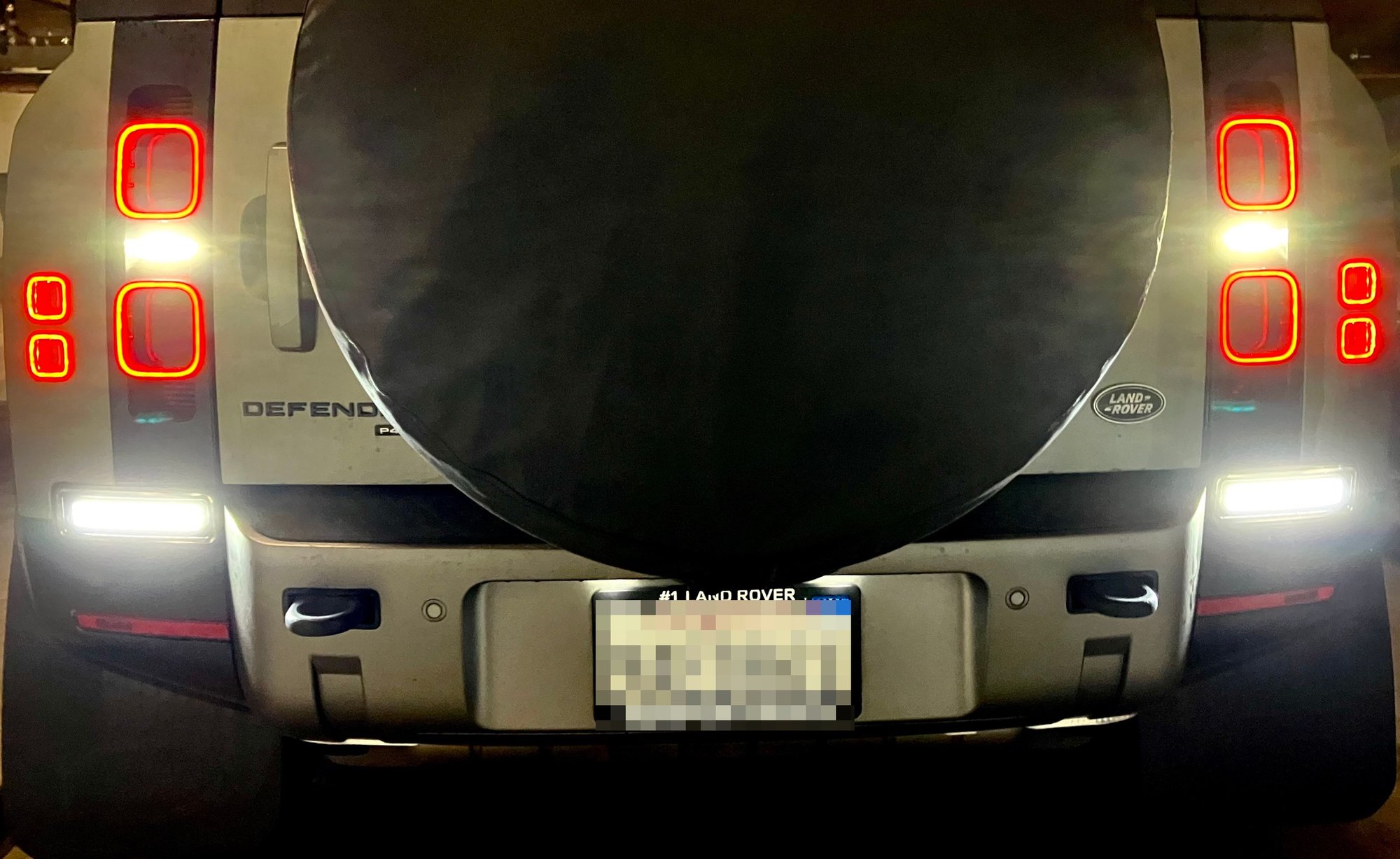

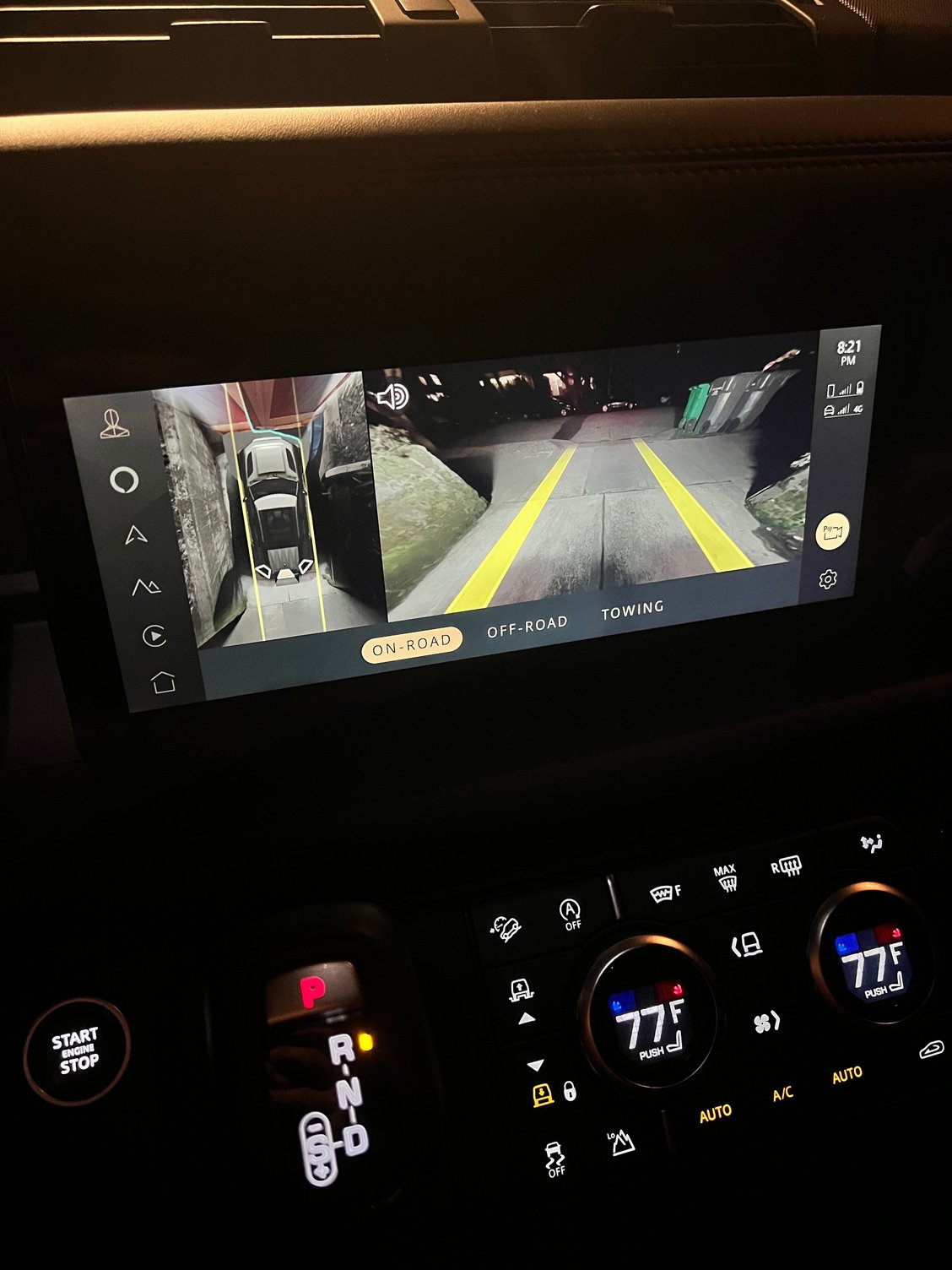

Pic of these from the cameras..
The only reason I went with these over the Powerful UK lights was the fact that I didn’t have to deal with the wiring harness. And I was curious.
Still planning on snipping the wires that make the red lights operate. They look fine but no need. Just want the white reversies.

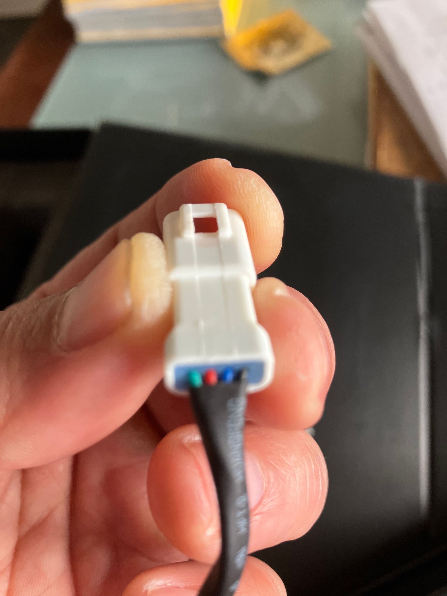

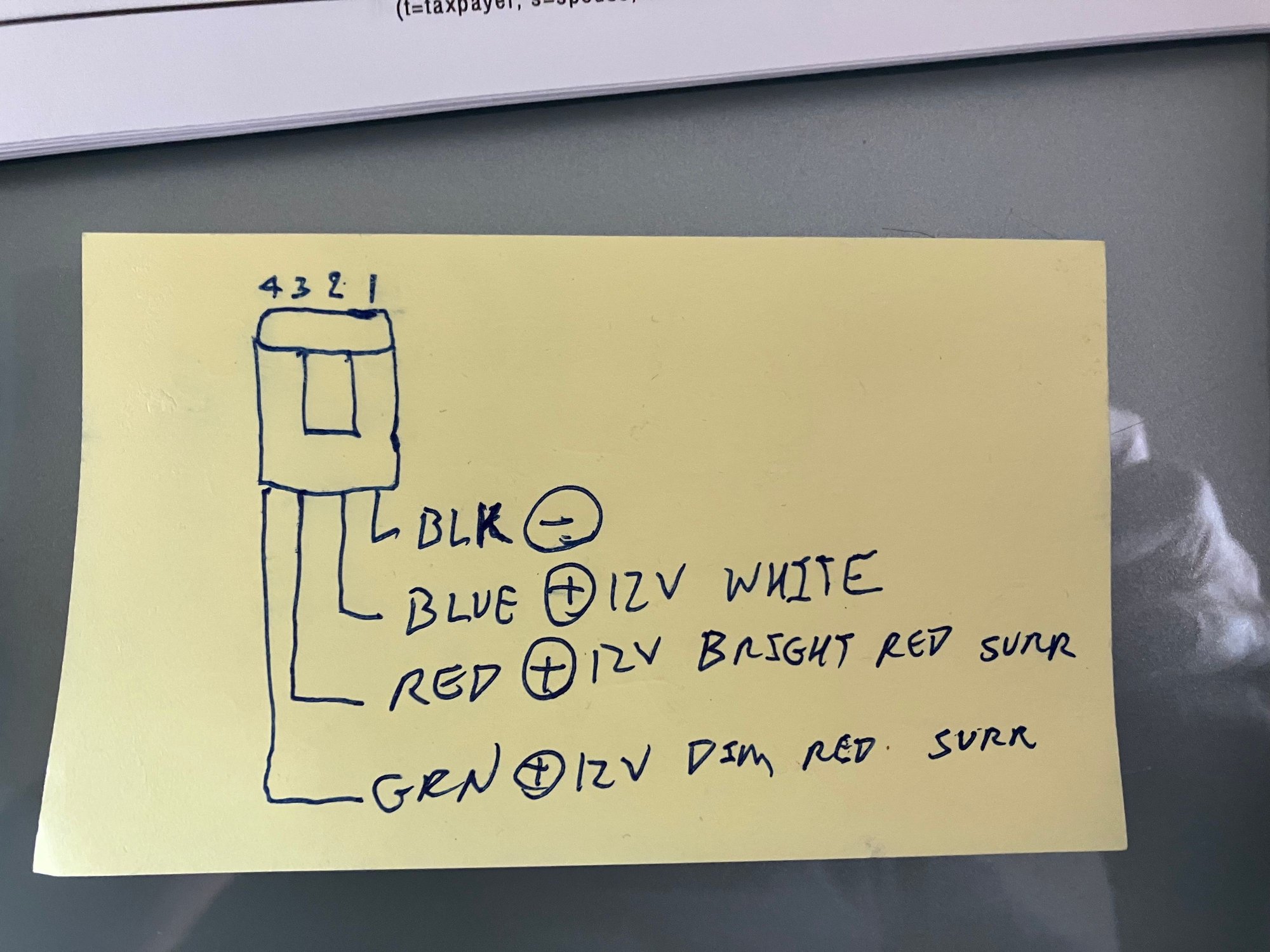

I made a test lead and hooked up the pins on the little white connector to the lamp module. Here is what each of the pins/wires are hooked cup to:

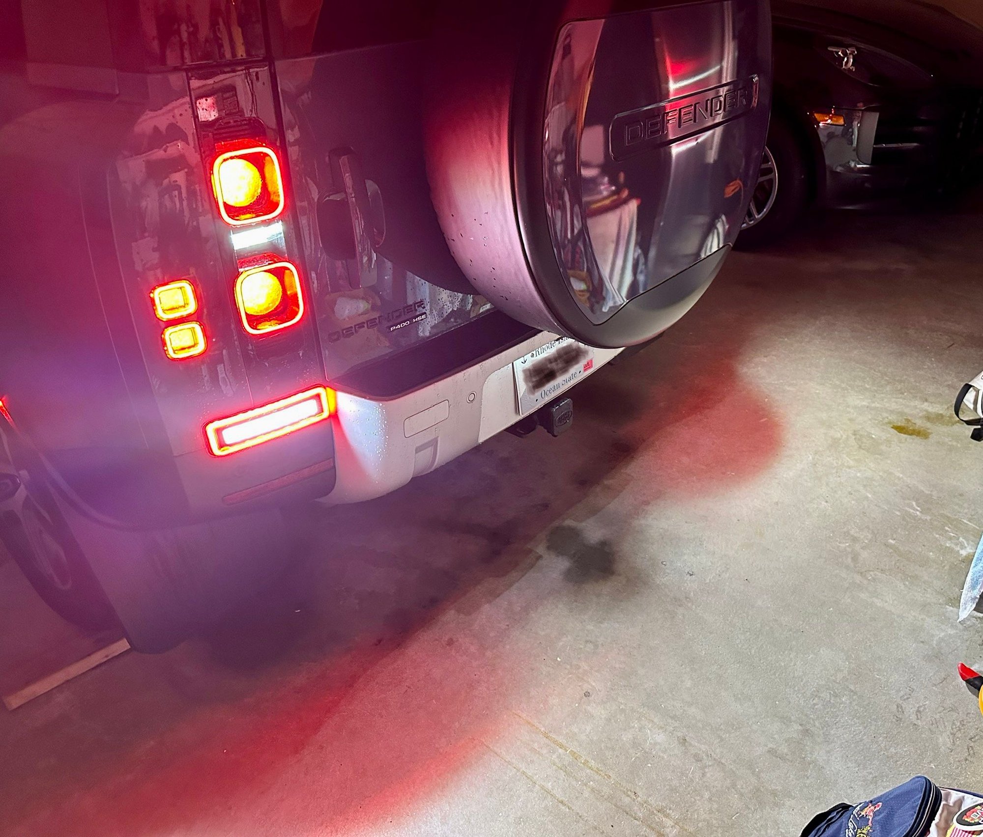

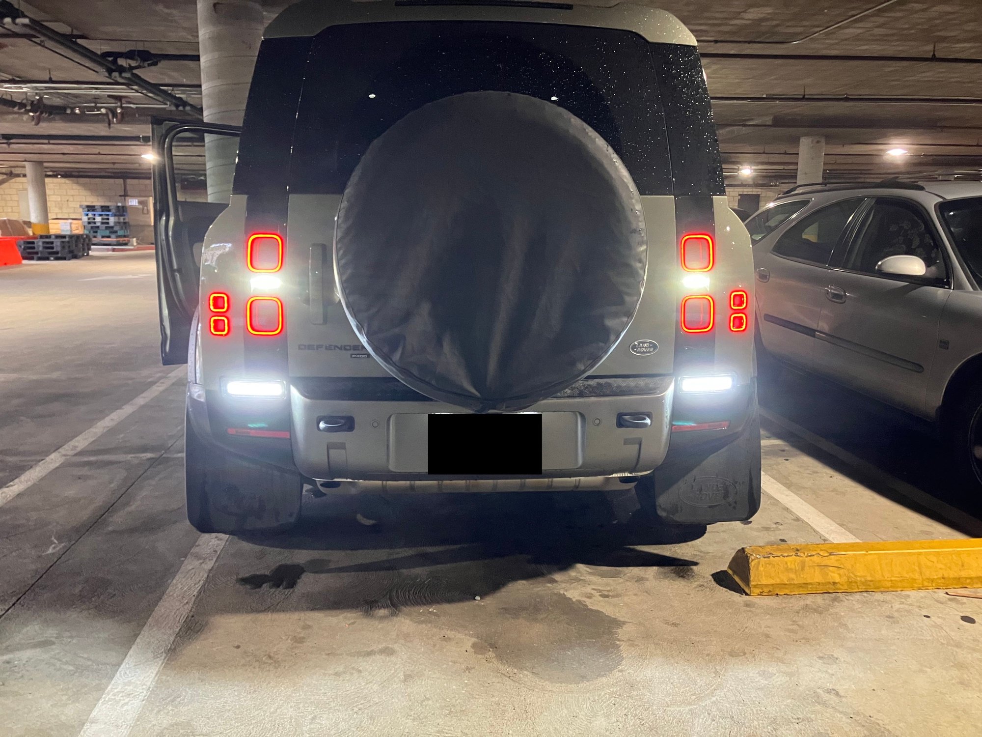

I like how it looks w/ the red LED's in the black surround disabled.
Without the red surround LED's these extra backup lights really blend in nicely : )
