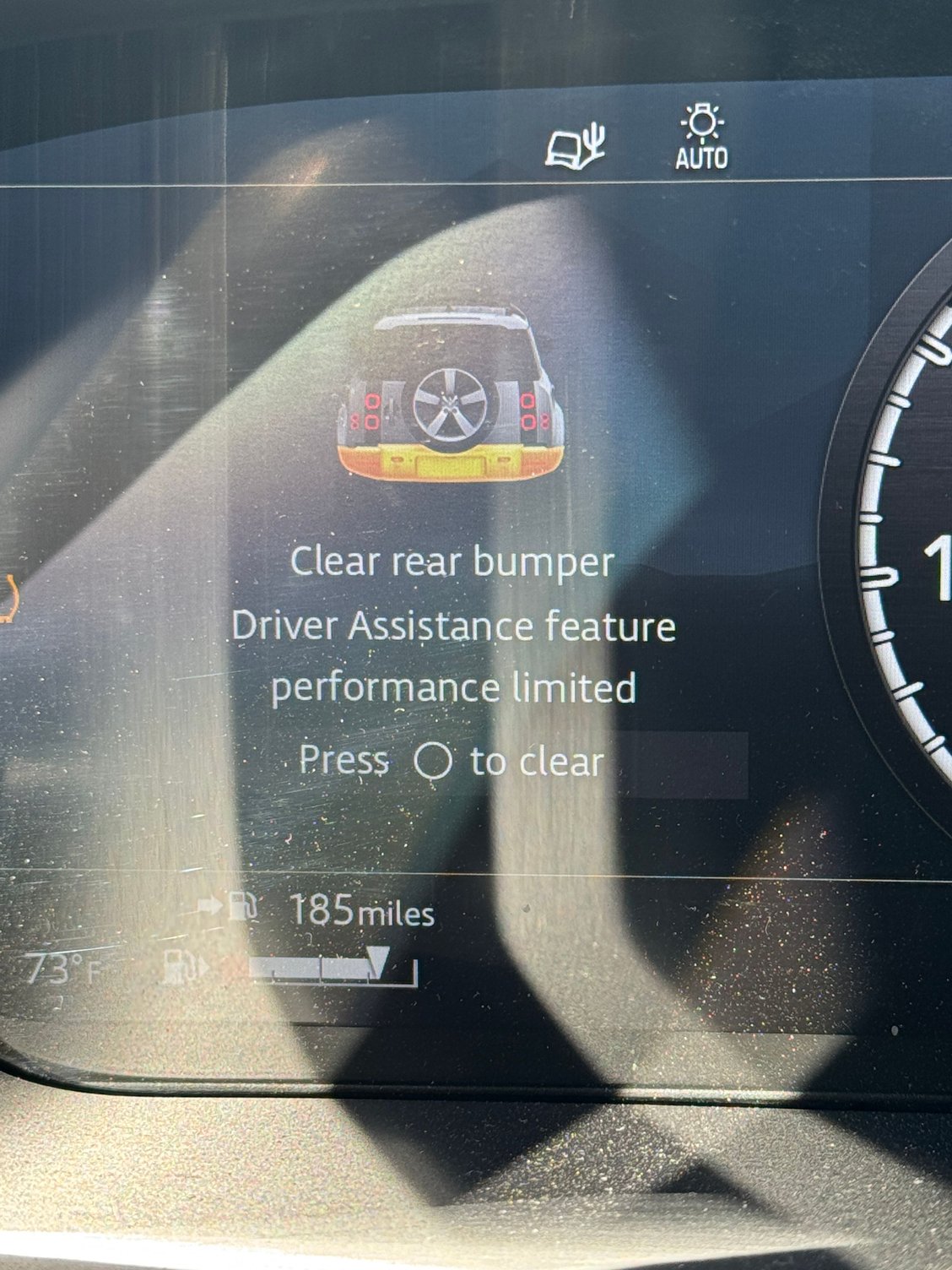

Hi Everyone,
I took my 2023 Defender 130 on the beach for the first time in almost 2 years and before going on I brought the tires down to ~20psi. I then switched it into sand mode, drove it on the beach and after about a 1/4 mile warnings started flashing saying stability control and other driver assists were off and the truck switched out of sand mode and into comfort mode. Oddly, I could not get it back into sand mode despite turning the car off and on.
I had no problems driving in the sand so I just did my thing and when I finished I filled the tires back up. After the tires were filled, I drove about a 1/4 on the road and the lights went off and it was back to normal.
Anyone else have a similar issue? I remember a while back when I was on this forum more often someone saying Land Rover instructs you not to lower the air in your tire even when beach driving. That seems counterintuitive and the car didn't give me these errors when I was last on the beach two years ago.
Any insight is appreciated and if my question has been solved elsewhere, just tell me. Thanks!

Thanks for the reply, even if I'm following up a bit late. I'm on stock 19" rims and air down to about 20psi on the beach and haven't had a problem before this instance. I think I narrowed it down to (electronically) raising the truck. I think it actually may have been raising it following the air down while on a bit of asphalt then driving onto the beach. Those that have been on Assateague know what I'm talking about.
When I didn't raise the suspension fter airing down I had no warnings. After riding on the beach for some time, I chose to raise it and didnt get any warnings. I also always had it in sand mode (not auto).
In short, i think the issue comes from lowering the tire pressure while on more stable ground, like asphalt in my case, then raising the suspension followed by moving from asphalt to "unstable" ground like beach sand, based on my different tests. I don’t need to raise the suspension to get on the beach or really while on the beach (just like it ) so for others hopefully this serves as a guide if you're facing similar warnings in similar situations.
