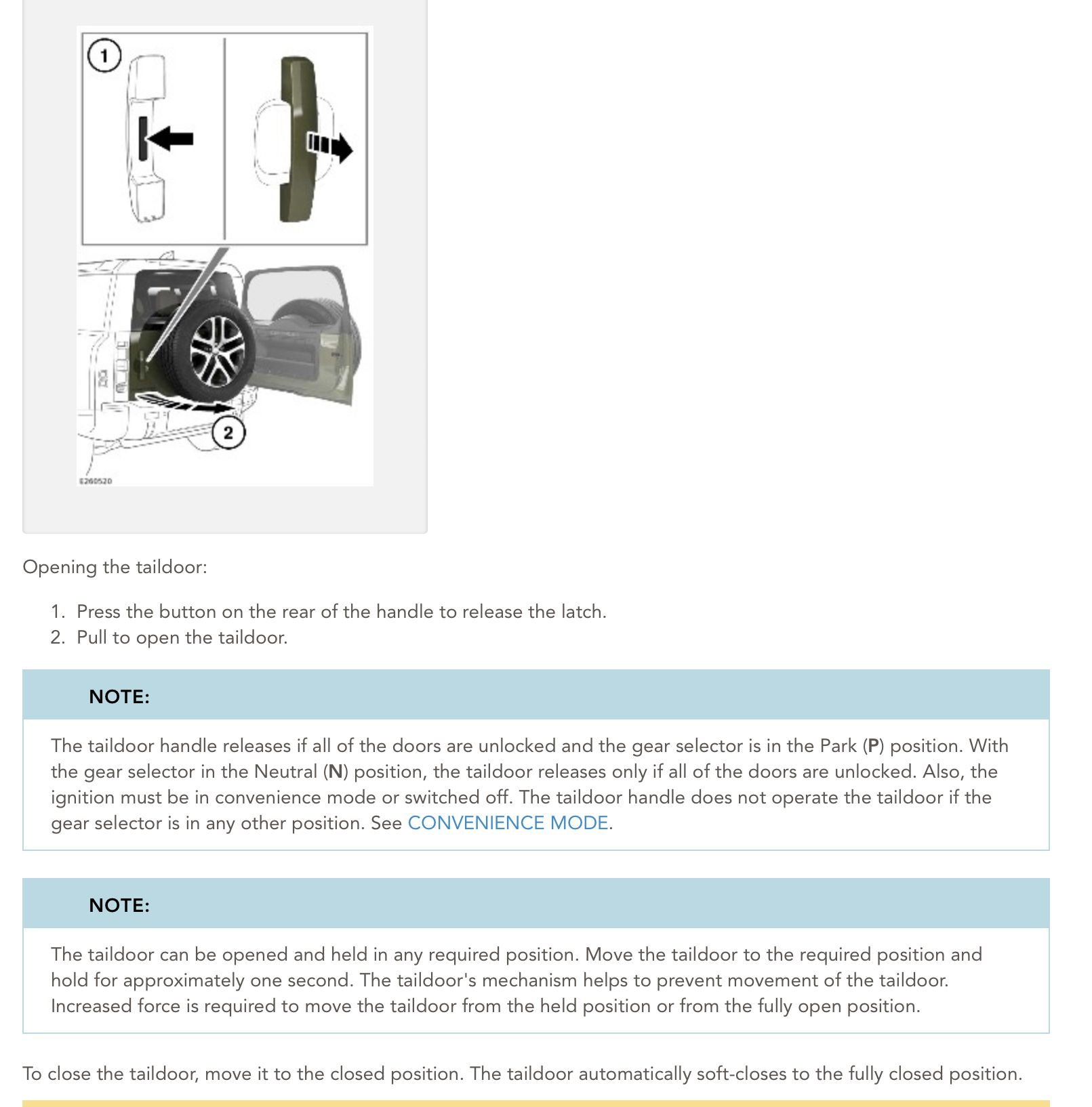

From the manual. There is no action by pressing the latch button on the handle, as suggested, which locks the door in the desired open position.
Interesting - that note describing open and hold doesn't show up in my version of the iGUIDE. I cannot remember where I read about pulling the release lever, but obviously what was happening when I did that was that I was effectively holding the door position for a second or two, triggering the hold function. Thanks for clarifying.
Yeah, I didn’t think so.

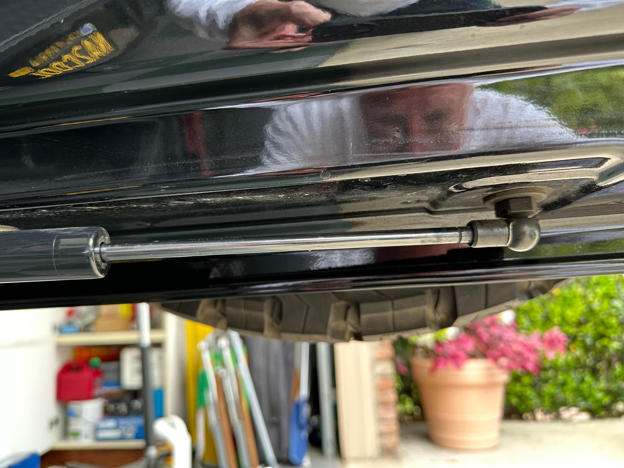

Old May 22, 2024 | 08:17 AM
longtrip68's Avatar
Joined: Jan 2019
Posts: 180
Likes: 30
From: Northeastern USA
OP here. So, turns out my gas strut was bad. The only reason I realized this was that I was at Dealer and opened tailgate on a new showroom defender and noticed that the tailgate “locked” into position as soon as it was stationary - like the manual describes. I ordered a new gas strut and it was an easy install. Problem fixed.

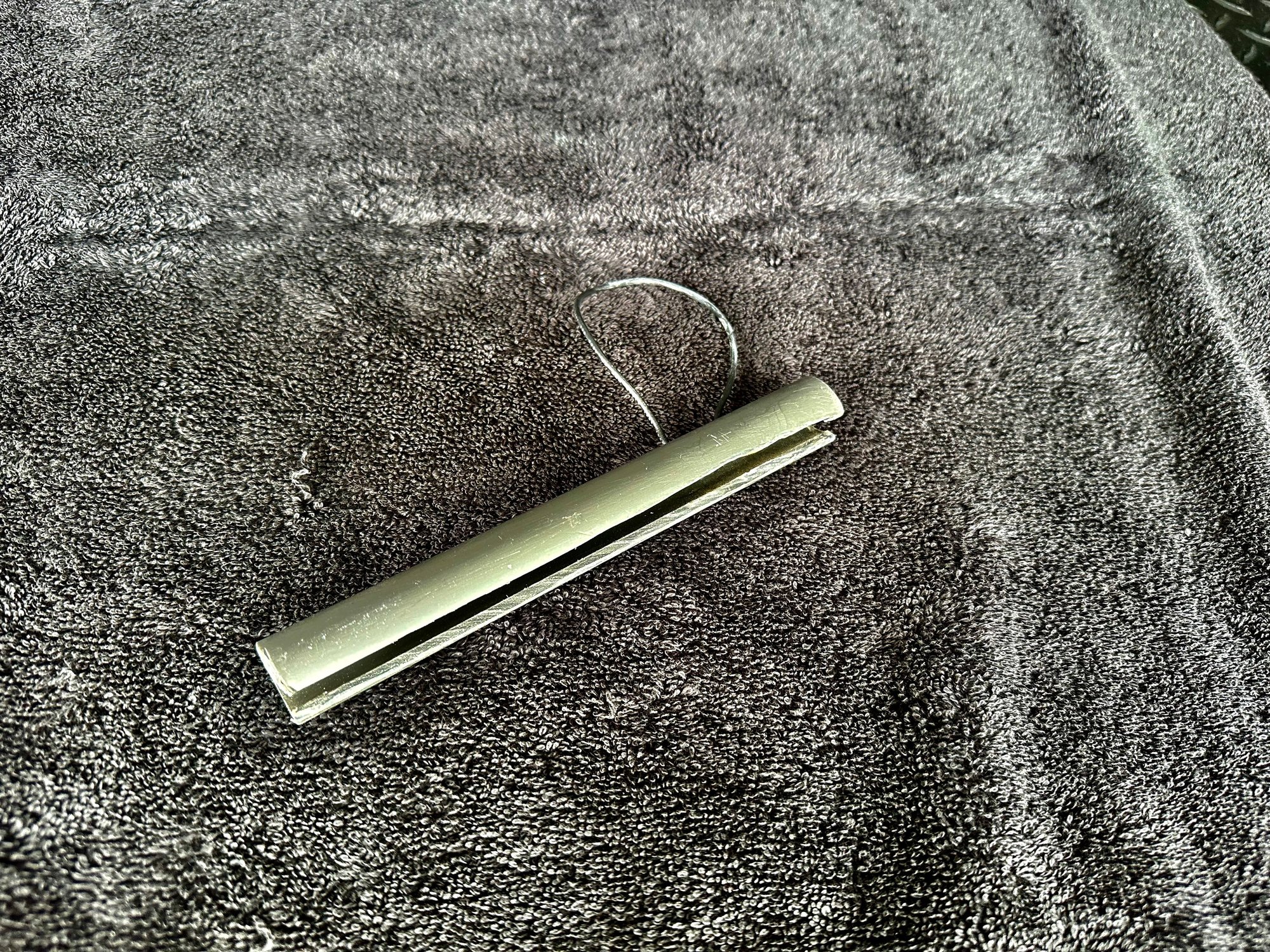

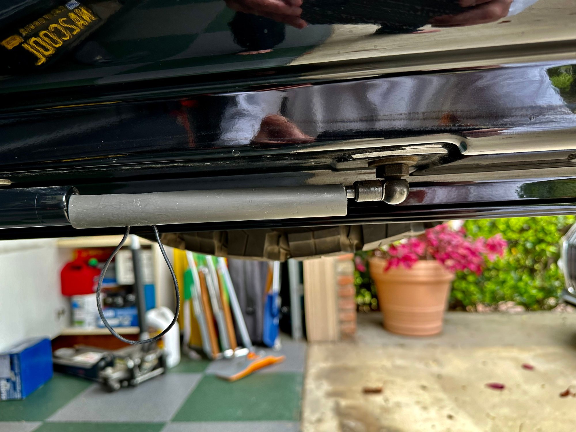

Here's the solution I came up with when parked on a hillside...
Cut a small pice of PVC pipe , slot it so that it clips onto the rod and bingo the rear door won't slam on you ever again.
When you are ready to go just give the wire loop a tug and off ya go.
