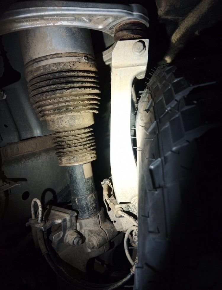

Dumb question. When I search for KO2/KO3/ATIII's by vehicle from Costco, Discount Tire these brands don't show. I've got my first LR on order with standard tires but I want to get an off road tires next. Would I need spacer for these other tires to fit?

These tires aren't available in OEM sizes. The OEM 19" and 20" tires are exclusive tires only for the Defender, hence why every tire in this size has "LR" or "JLR" on the sidewall. If you're on 20" wheels, you'll have to go slightly bigger to 265/60R20. If you search this size, you will see plenty of options. This size will fit without issues, but the clearance between the tire and the knuckle is very tight. Here is a picture of my 265/60R20 Falken Wildpeaks on my Defender with air suspension. Coil-sprung cars have a little more clearance than air. The maximum size tire you can fit on a Defender without adding lift rods or shaving fender lining is 32.6." There is no rubbing at any suspension height on tires less than 32.6" in diameter.

Thank you so much. This helps a lot, I built mine with 20". I wanted 19" to give me extra sidewall but almost everyone on here said it was a pain to find tire sizes. I don't want anything to rub, I'll stick to the size you gave.
