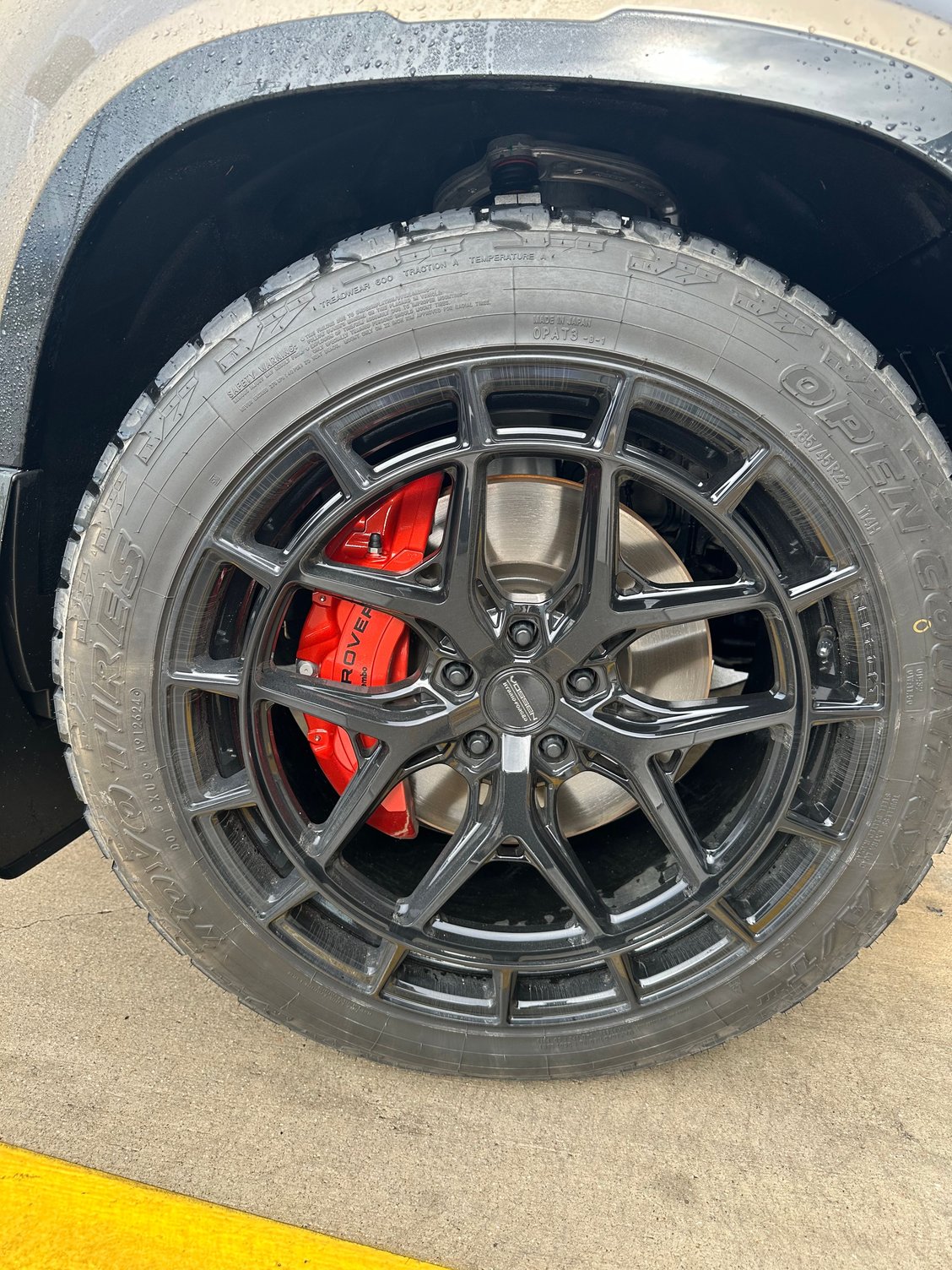

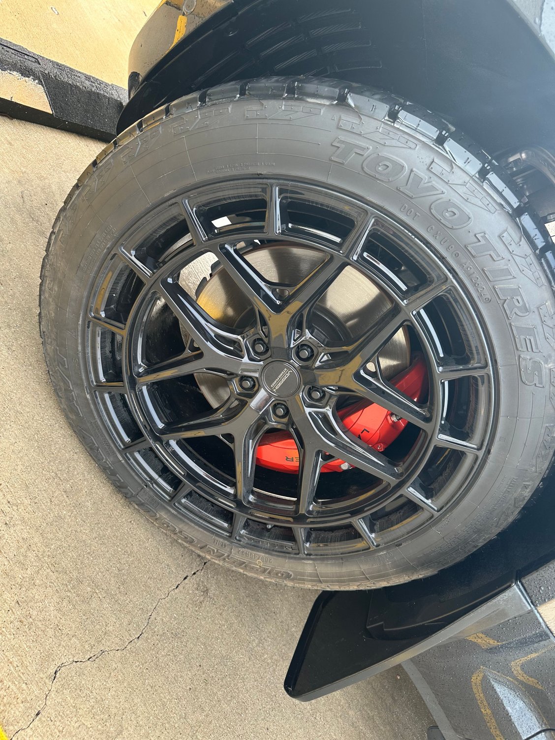

As I previously stated, I think the Toyo’s are awesome. It may be “confirmation bias” but I really think they are the quietest of the three you are considering. I had Nitto’s on my G-wagon and replaced them after 2200 miles due to the noise. The Toyo’s were noticeably quieter and frankly the ride was much better.
