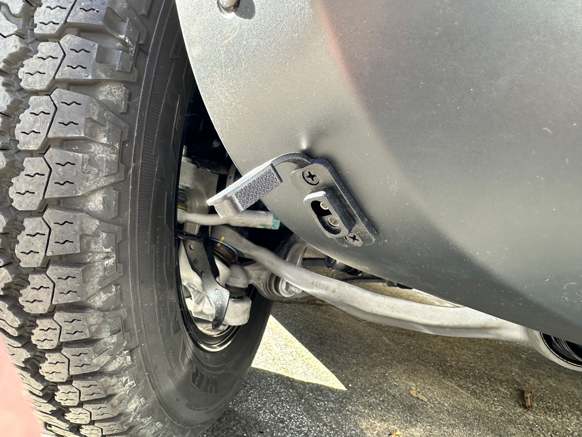

I have installed a magnetic connection on the front close to where I installed my light bar. Works great, easy to connect and if I forget to disconnect it just pops off. The plug on the car does not connect to the battery until the magnet connector is attached.
Very nice install. Do you have a link from the manufacturer? Thanks.

I purchased from Hethelsport but the magnetic connector is from CTEK so you should be able to find the parts there as well. I will say that Hethelsport was great to work with and had everything included that you would need to install
https://hethelsport.com/tools/charger-connection-kit/

Originally Posted by R-dubb
Having just had my battery replaced, and reading all these informative posts about trickle chargers and the various ways to connect, yours is the best engineered version. Love the look. Where did you get the inlet mounted on the bumper cover, and is it compatible with the CTEK?
