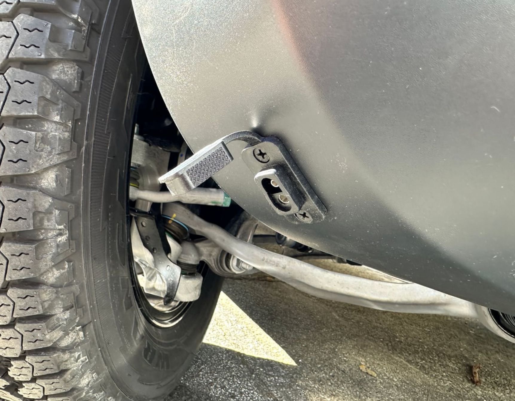

Having just had my battery replaced, and reading all these informative posts about trickle chargers and the various ways to connect, yours is the best engineered version. Love the look. Where did you get the inlet mounted on the bumper cover, and is it compatible with the CTEK?
I installed the fused harness to terminals under the hood. Drilled a hole and mounted in the skirt. It is a SAE/Battery Tender plug, not CTEC compatible.
