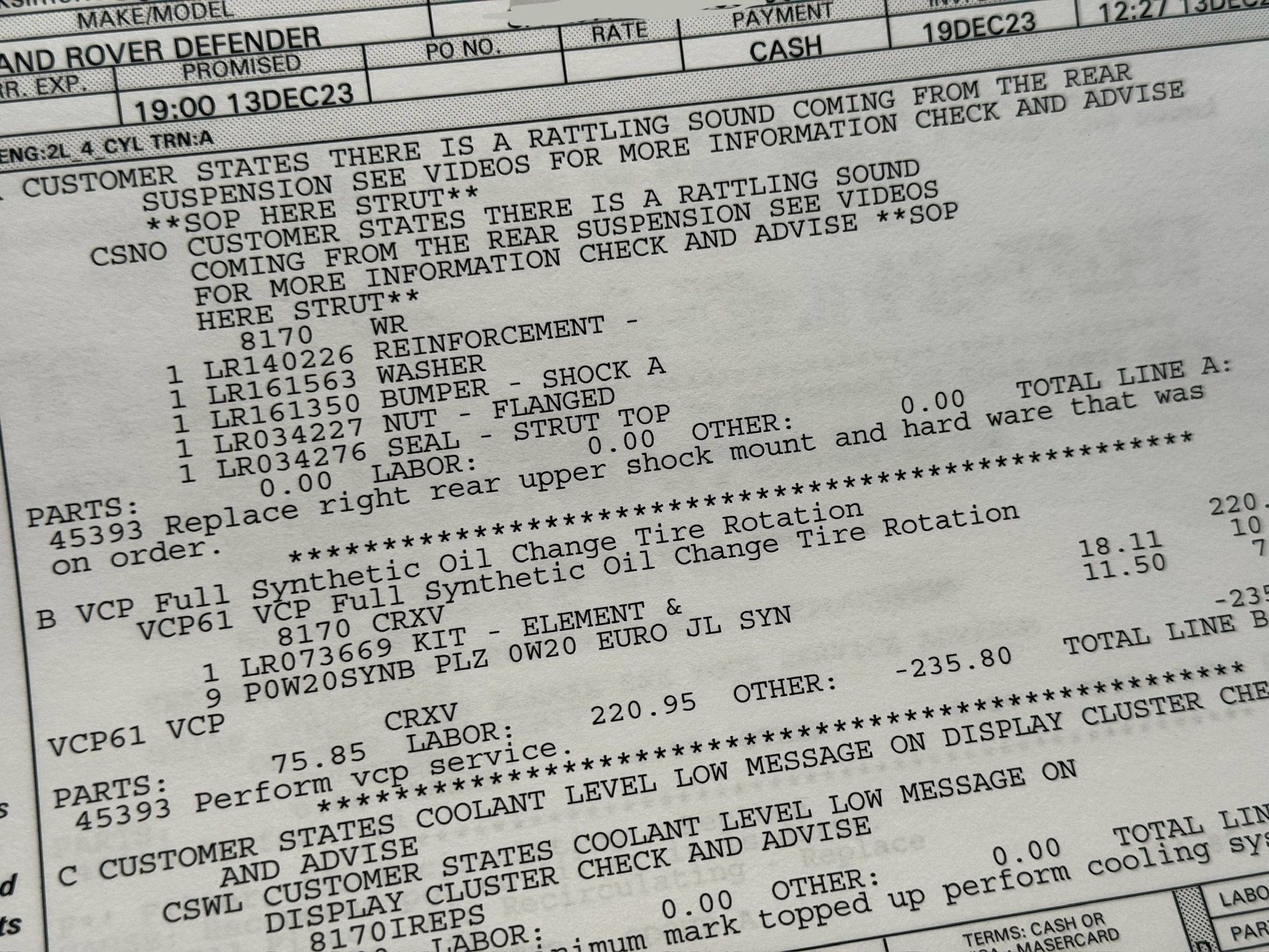

Default Rear shock resolved
yes - the dealer fixed my right rear shock under warranty. However I still get a weird rattle in the back over rough surfaces due to something else. Still have to investigate that. But the original rattle from the shock was addressed!CUSTOMER STATES THERE IS A RATTLING SOUND COMING FROM THE REAR
SUSPENSION SEE VIDEOS FOR MORE INFORMATION CHECK AND ADVISE
**SOP HERE STRUT**
CSNO
• CUSTOMER STATES
COMING FROM THE REAR SUSPENSION SEE VIDEOS FOR MORE INFORMATION CHECK AND ADVISE **SOP
HERE STRUT**
8170
WR
1 LR140226 REINFORCEMENT -
1 LR161563
WASHER
1 LR161350 BUMPER - SHOCK A LR034227 NUT - FLANGED
1 LR034276 SEAL - STRUT TOP
PARTS:
0.00
LABOR:
0.00 OTHER:
0.00
TOTAL LINE A:
45393 Replace right rear upper shock mount and hard ware that was on order.

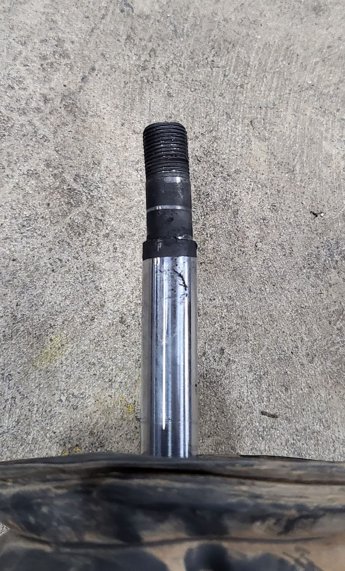

QUOTE=ponder;865631]Wanted to get a broader set of perspectives - if this will still be okay for over a 1K mile drive. (Have a quick trip next week and will be at dealer week after)
A few on instagram were helpful to mention that this could be the adaptive damper / active air suspension. Some say it shouldn’t move; definitely not rattle. Happy to have anyone else confirm what it may be.
I have nearly 30k miles on my rig. The noise started to happen a week+ ago from the rear; and today I took everything out and had someone sit in the back to find out what the rattle was… and it was this thing.
Left side (driver) moves but is silent; right side (passenger) is way louder when it moves. Moves when I’m on roughy roads. Silent on smooth roads (doesn’t move).
Anyone else have this happen to them?
See video here of sounds and visual:
https://youtube.com/shorts/gNXVyZZOtho?feature=share
Photos of component:
The metal bit below the wiring / plug in the center is what moves up and down; and causing the rattle. Only moves when in rough road; leading me to think it’s adaptive dampening / suspension.
Close up
Farther away.

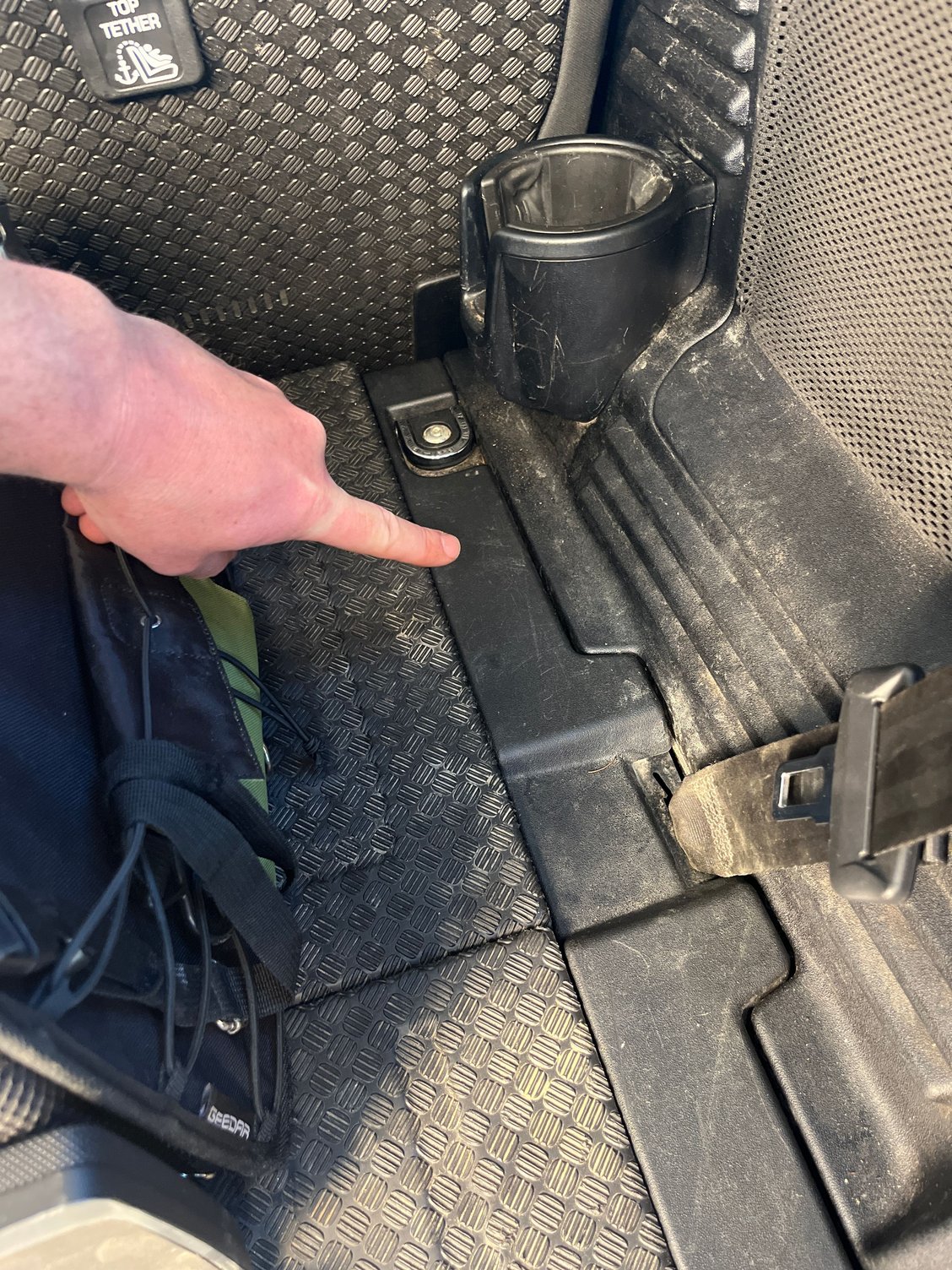

Question for those who have solved this. My dealer had the car for 3 days to do a few simple repairs and check this issue out.
the managed 2 of 3 repairs and never bothered to look where I asked them to. Really useful to have such a competent LR vendor on hand.
how do I access this area? Do I simply remove the trim beside the third row?
Old Apr 19, 2024 | 08:05 PM
tbrown's Avatar
Joined: Jul 2022
Posts: 308
Likes: 181
From: Colorado
I think you have to undo the tie-downs and then there are a couple of clips.
https://www.lrdefender.org/right_loa...panel-972.html

Gavin, were you able to check this on your 7 seater? I want to inspect my shocks due to a similar noise in the area and want to avoid taking the entire boot apart if possible. Was it as simple as removing that trim piece?
