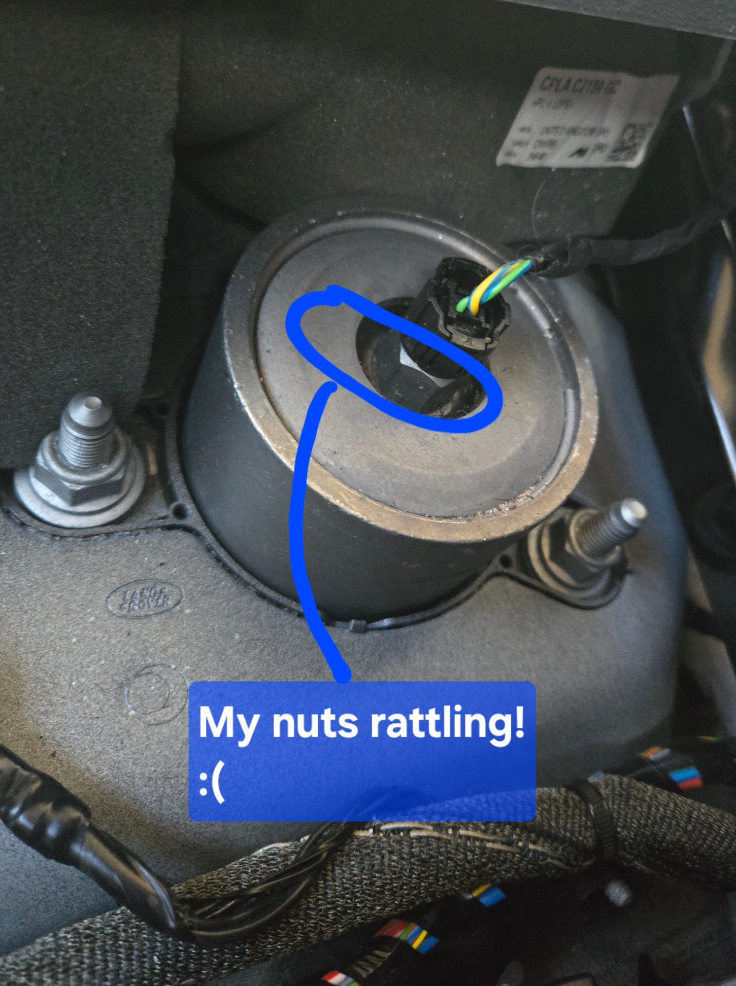

My 2022 p400 with air suspension and 35k miles started rattling about 1k miles ago. Thought it was just a loose body panel but after steadily getting worse I located the exact problem as in the original post.
The rattle is from the rear top shock mount. I can feel the nut moving and rattling as the car travels over bumps.
From reading the post, it seems that replacing the top mount may not be enough. Are there more parts that should be replaced?
