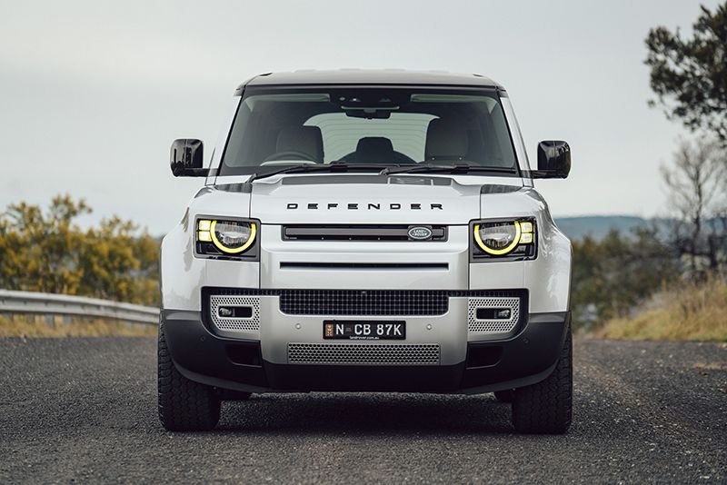

Anyone consider this? Not sure if this is even possible, and the legality of it due to the turn signals are so close but i think the mockup looks sick

There is a CCF setting that you can change that will change the outside square DRL to amber. (it lights up the turn signal)
The round headlight surround would need a light source change from what I can tell.
There is someone here that posted that they changed the square ones to yellow though.

The color should not be an issue, other cars have other colors. One of the KIA or Hyundai SUV's has kind of an orangey yellow cast. The LED's go off, by law, on the side the turn signal is doing its thing. Since you have actually mentioned it in public, somebody on Ali Express is making it as we speak, they are very fast followers.

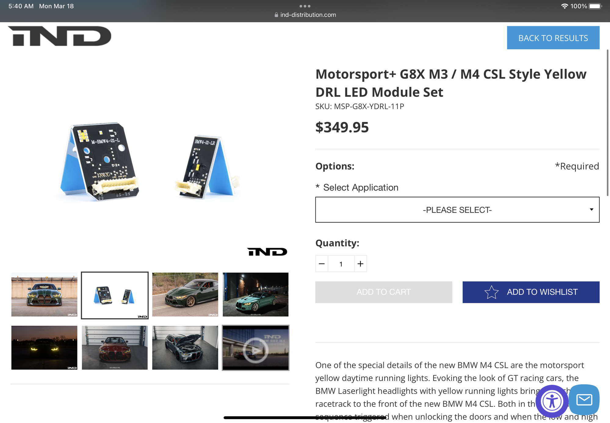

I wonder if there is a chip for the color like BMW?
https://ind-distribution.com/product...led-module-set

The turning off function can be adjusted as well in the CCF’s. They can be set to be on all the time or to only dim when turn signal is on. I have mine set to dim. Won’t worry about it being legal unless I get pulled over for it which they have been this way for a year now with no issue. A color change would be interesting as well.
