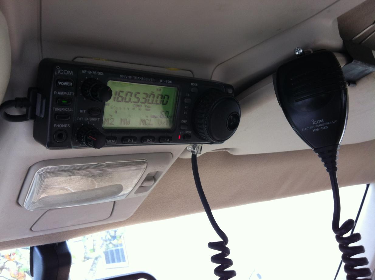

Well it's been a few months for this thread but here goes:
I've been a ham for about 5 years now I guess
KI4OIU General Class
I just mounted an Icom 706 in the Rover yesterday - body of the unit in the glove box and head unit on the over head console where the larger plastic panel pops off.
1/4 wave mag mount on the roof until i fabricate the side mount.
I normally run an Icom auto tuner with a 102 inch whip for HF and 27mhz, and a dual band 1/4 wave for UHF/VHF. But on this truck I think I will keep it simple with a 1/4 wave dual band on one side and a 1/4 27mhz (CB) on the other.
BUT I mounted a Kenwood D700A under the passengers seat with a fused power block and the gps. The Head on on the console giving me APRS capabilities.
