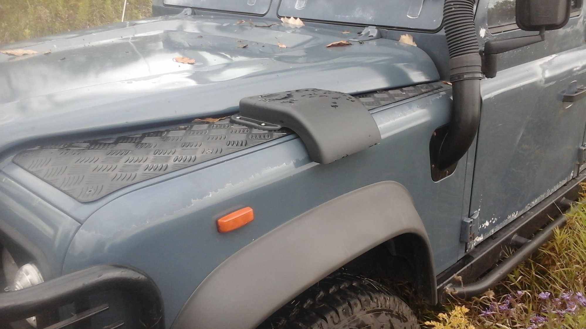

Added a snow cowl (heater intake cover for fender), ladder, window guards and a clear foglight lens(that will be used for reverse light).
Getting closer...
Brian.

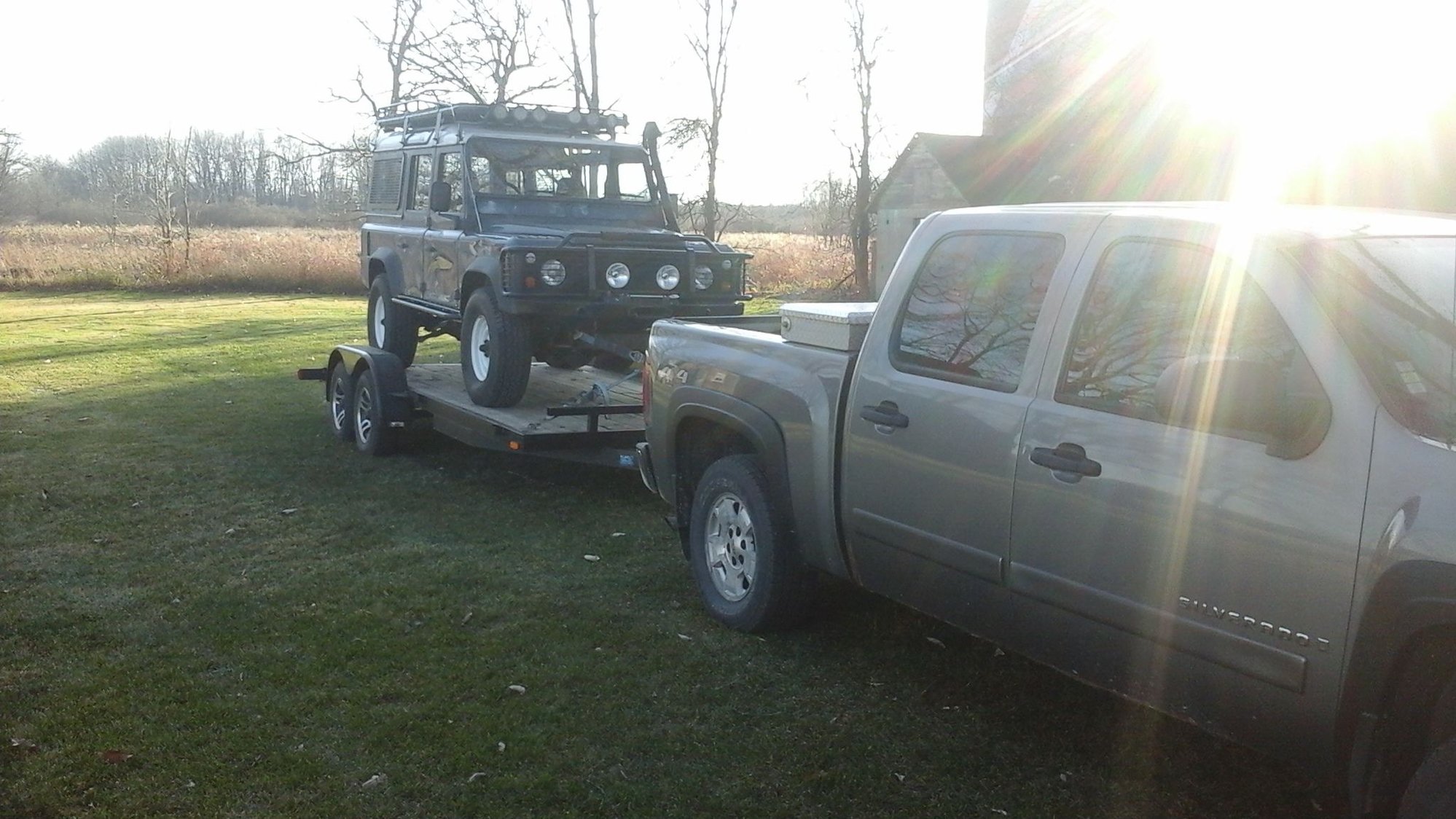

Heading to work for an engine swap. Out with the 2.5td (87 hp) and in with the 200tdi (110 hp). The 2.5 just wasn't getting it done...and l've not even added the weight of my sleeping/cabinet build inside. Pictured myself with the 4-way flashers on all the way to Alaska...lol. Not that l'm in a hurry, just have to be practical about the whole thing.
