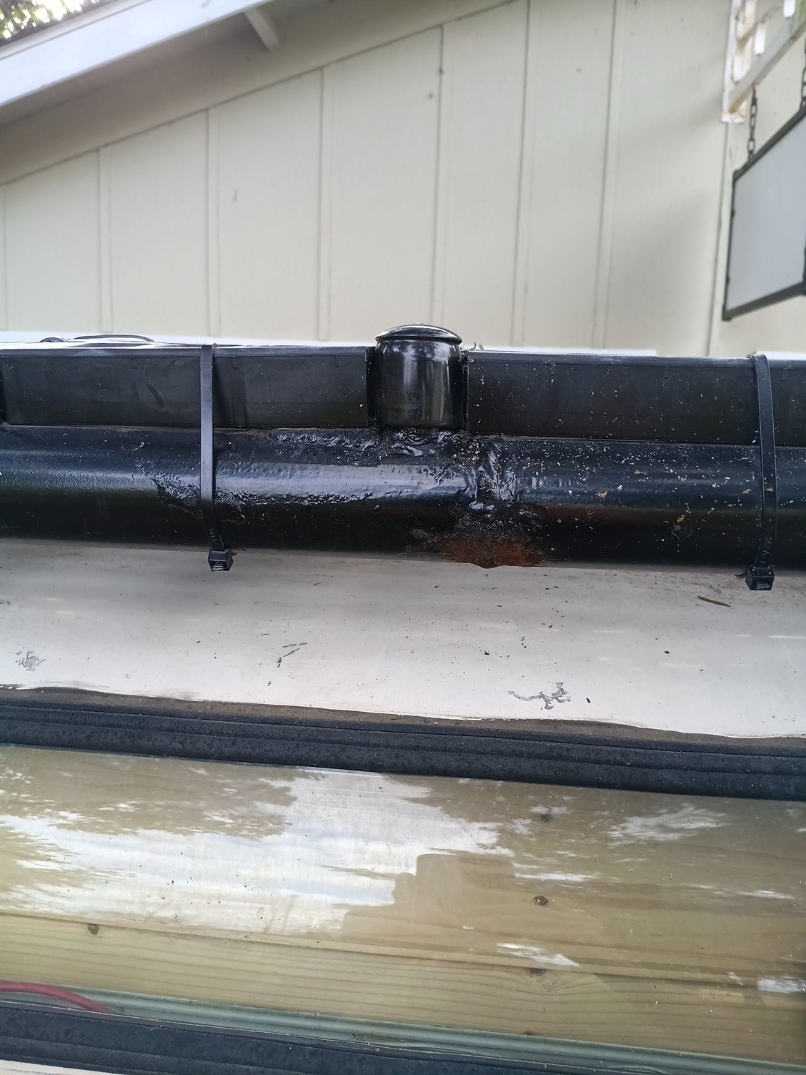

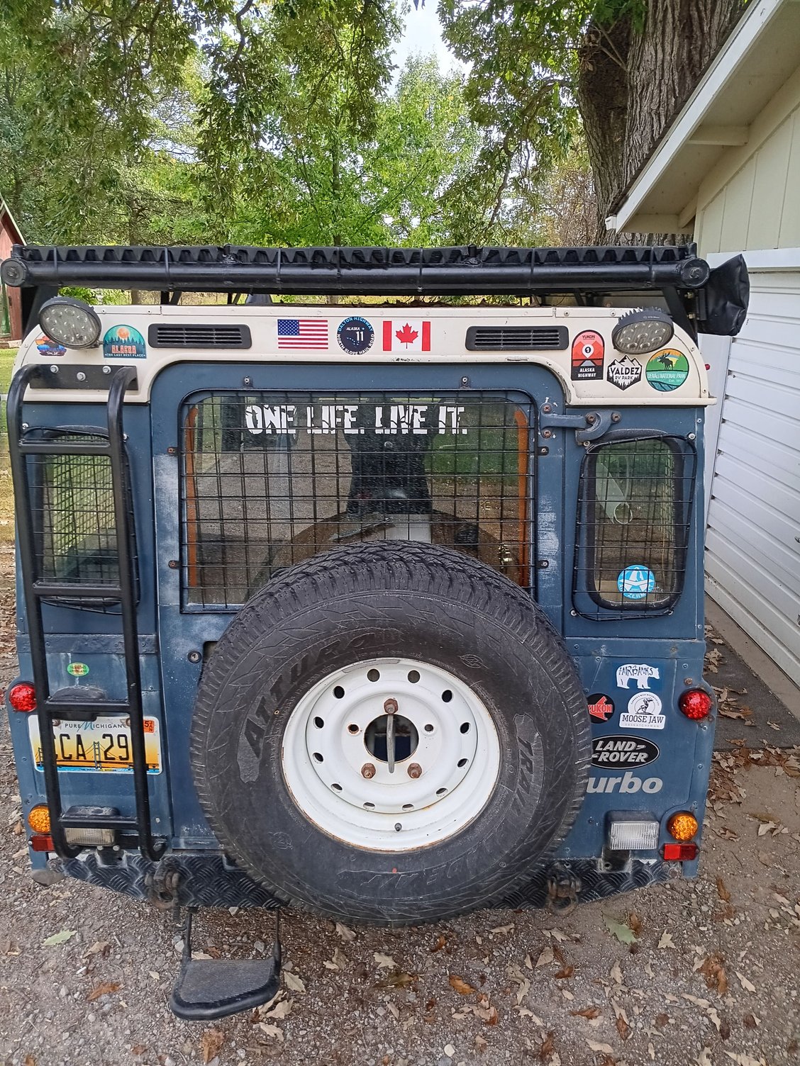

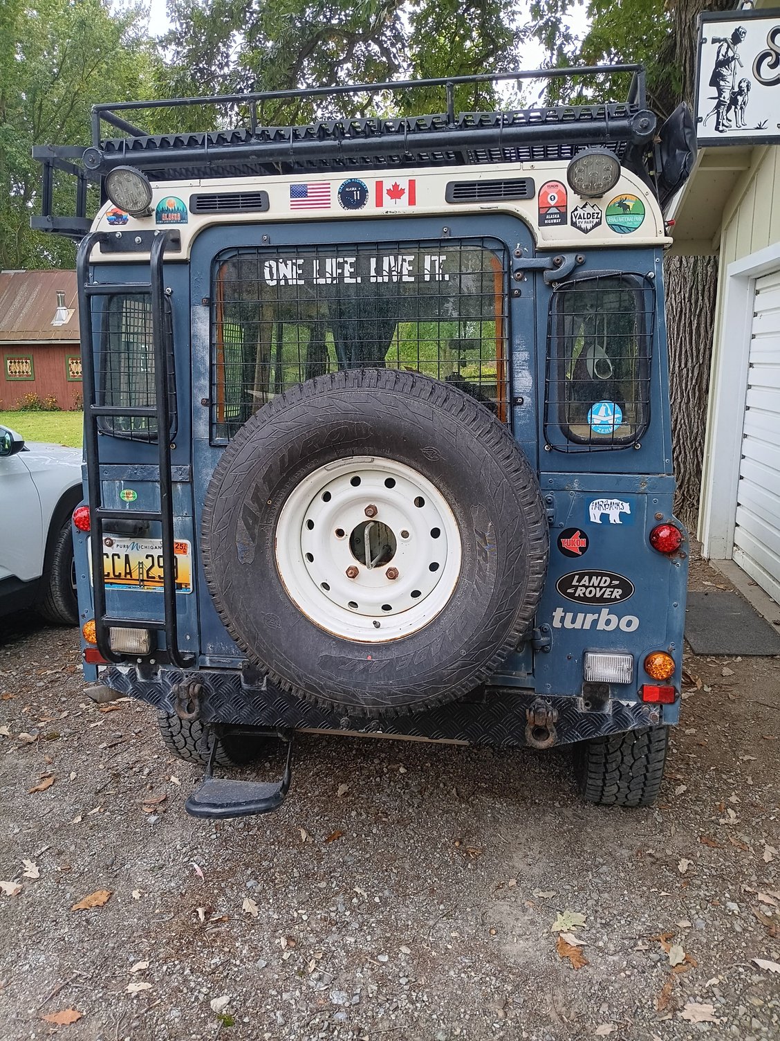

Cut the upper protion of rack off.
Before...
After...
Being a packrat pays off...
Usually, when we'd get a new set of cooler lines (trans, power steering, etc). They get shipped/delivered with rubber caps on the ends to protect line and threads of fitting. Me, l save them...and throw them in a drawer.
Well, after cuttimg vertical supports, which some were hallow pipe that was open all the way through into horizonal pipe. So, needed something to cap them off. Lowandbehold...the rubber caps came to the rescue. Put a little gasket sealer on the inside and installed them on pipe.
Needed the upper railing off, so l can install my roof top tent on back of rack. Plus, if l let enough air out of the rear tires...she fits in the garage now without removing rack!
