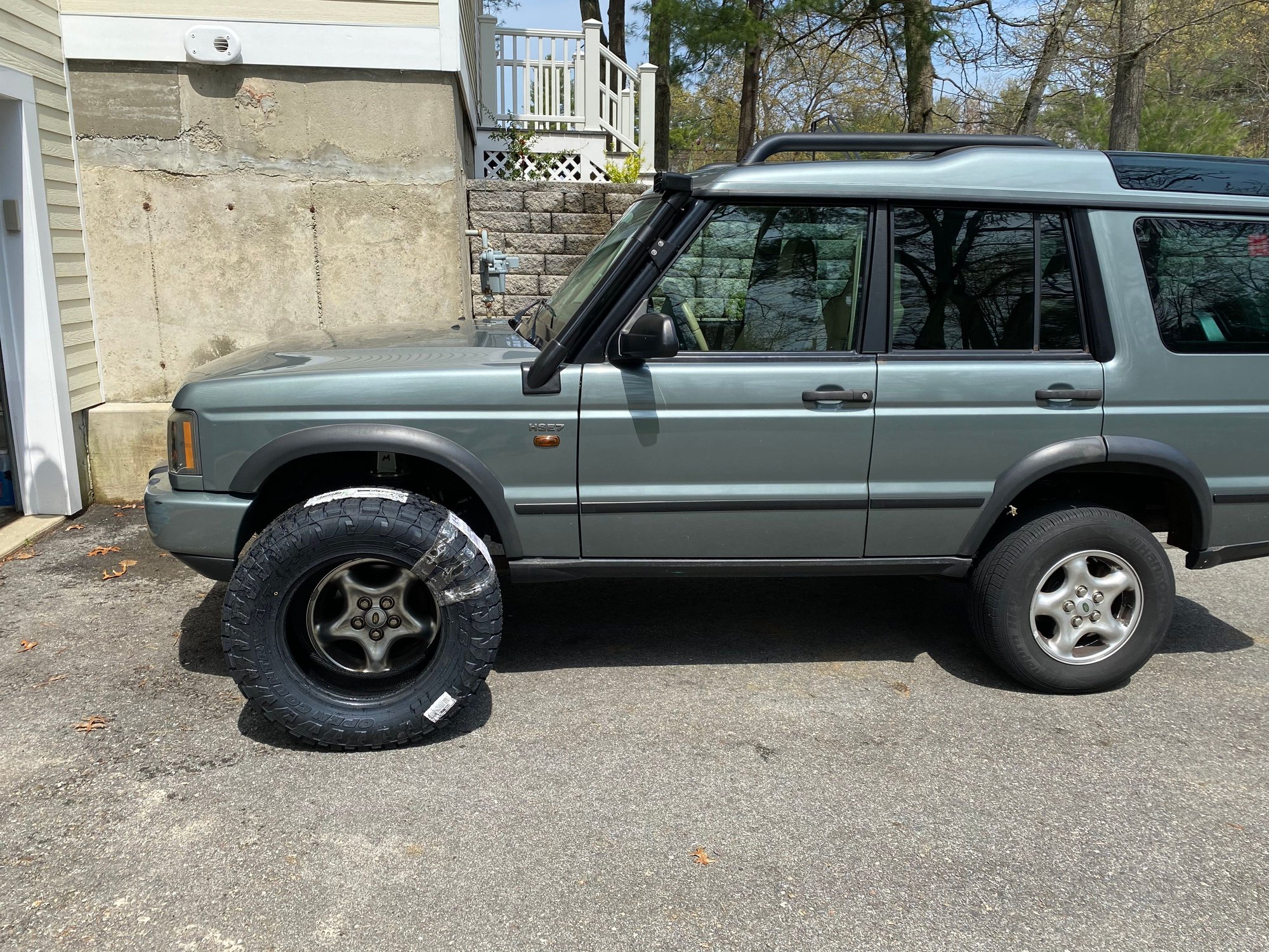

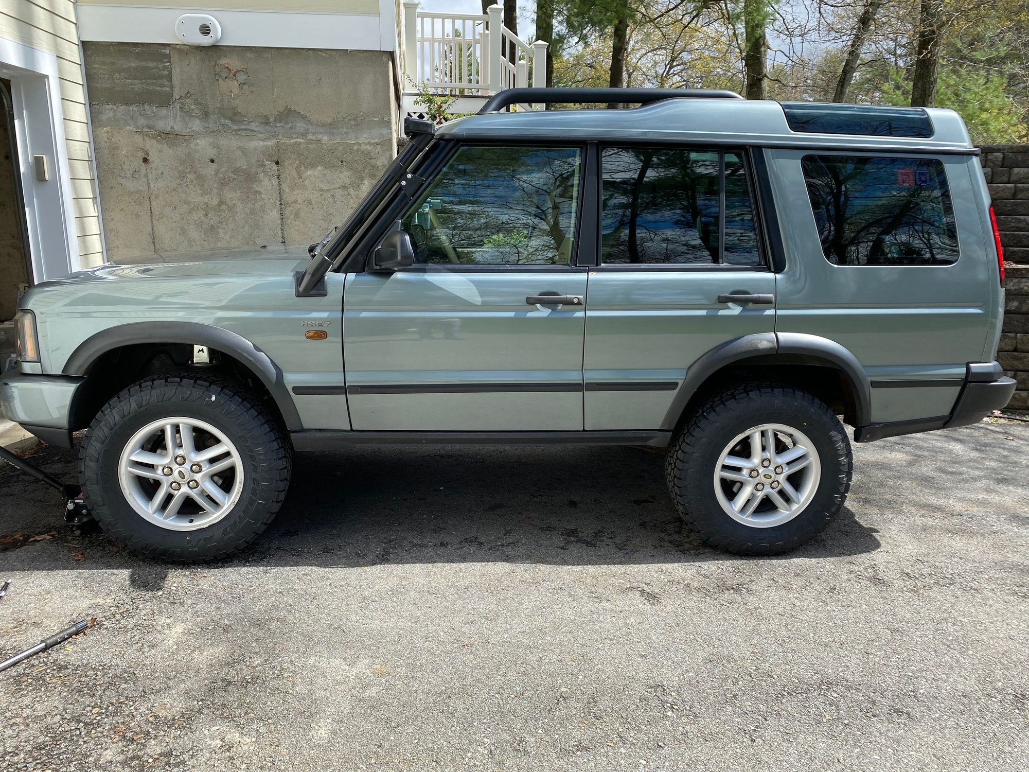

Some work to get done this weekend, RTE castor corrected arms and adjustable panhard are in. Toyo OpenCountry AT3s are here as well. I went with 265/70r18 which is just about a 33 inch tire.

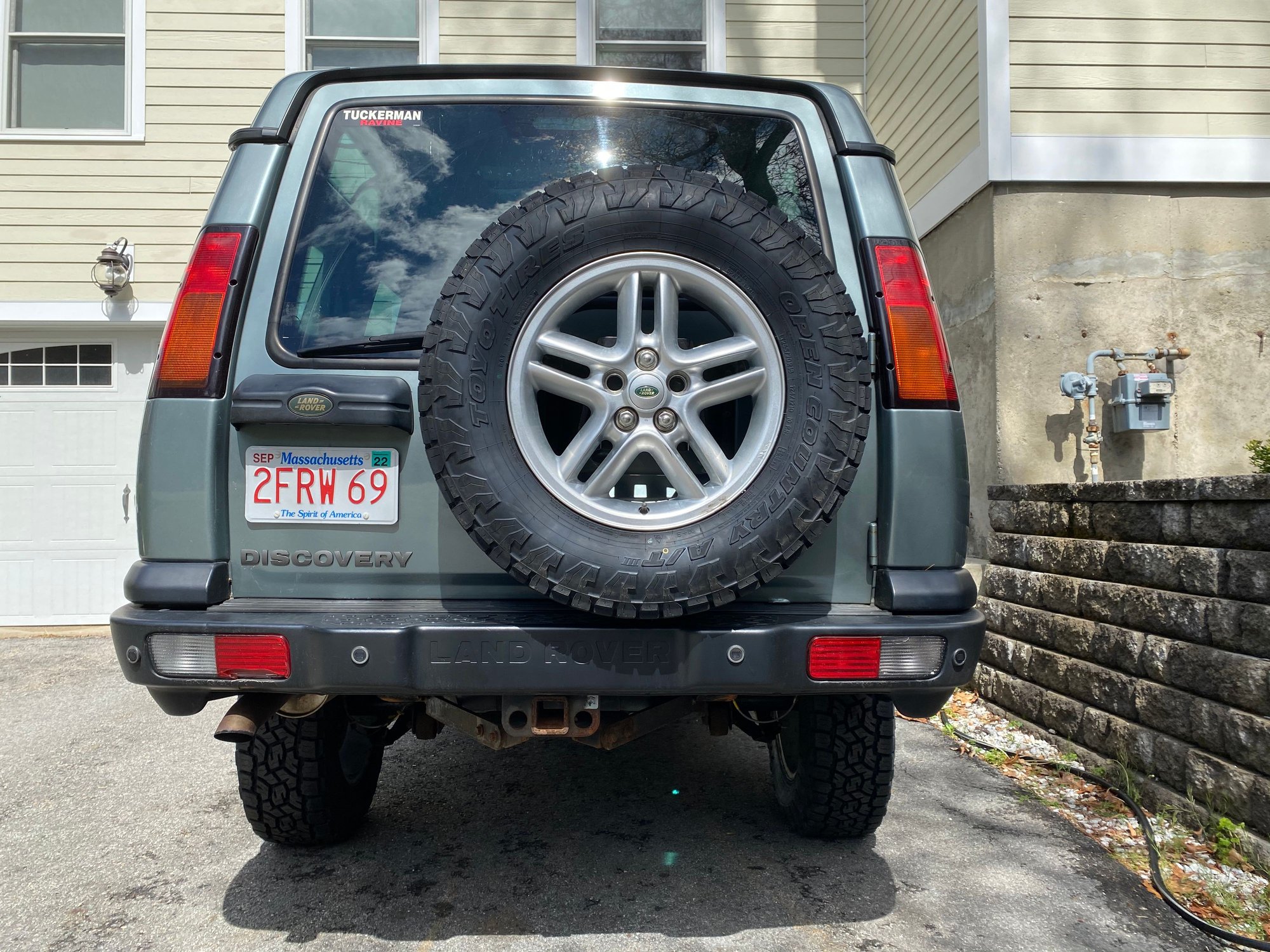

Tires mounted! The aftermarket tire carrier give just enough room for 33’s. Slightly better stance versus stock

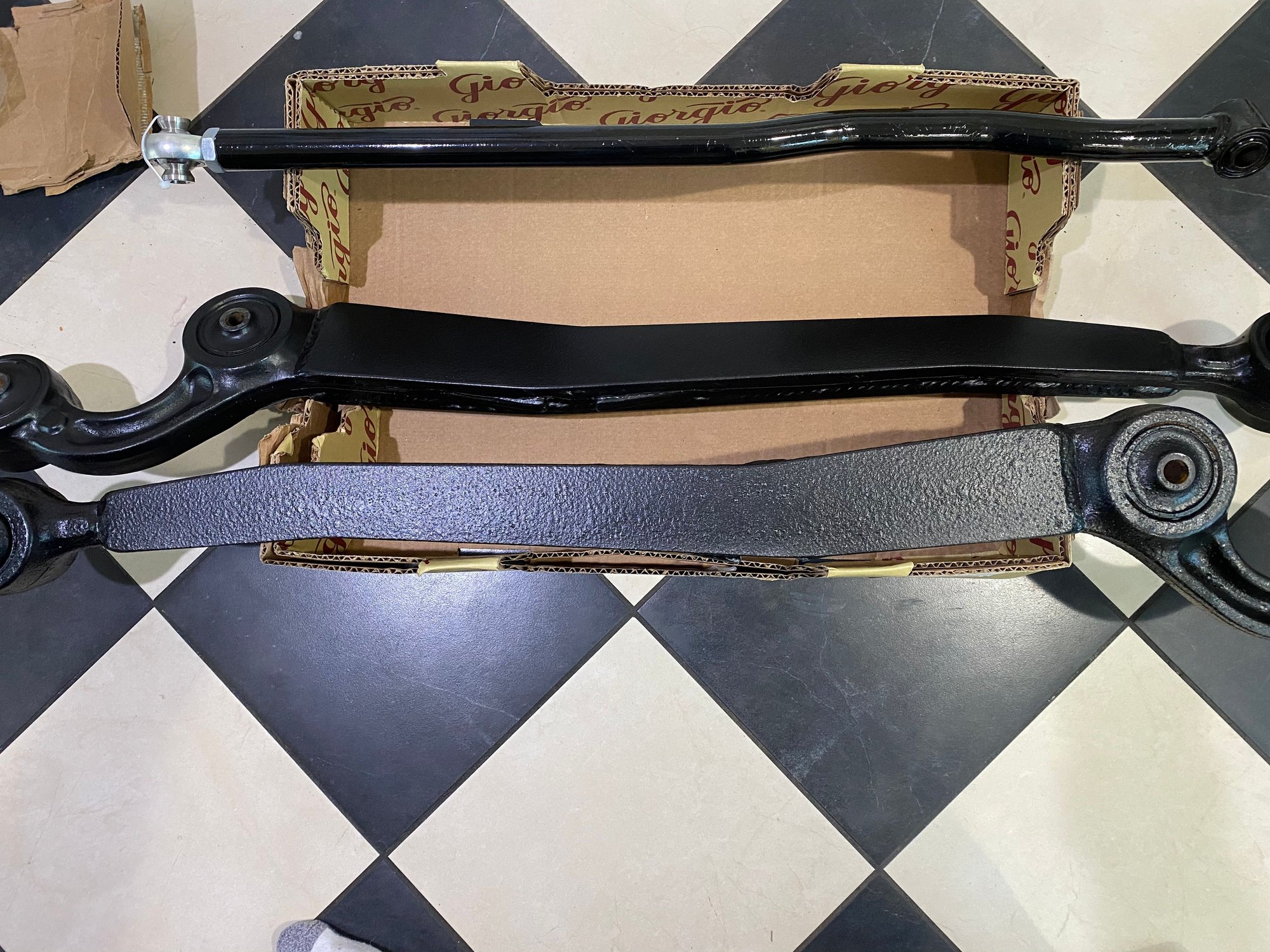

Radius arms and all new TF steering components installed. It was a fairly painless process other than a couple of the radius arms bolts where frozen in place. I had ordered replacement bolts for this very reason. The steering is night and day. Yeah it was Ok with the stocks arms with a 3” lift on the highway but now drives like new.
I followed the steps here:
https://landroverforums.com/forum/di...arm-how-79575/
Side by side, RTE castor corrected vs stock radius arms

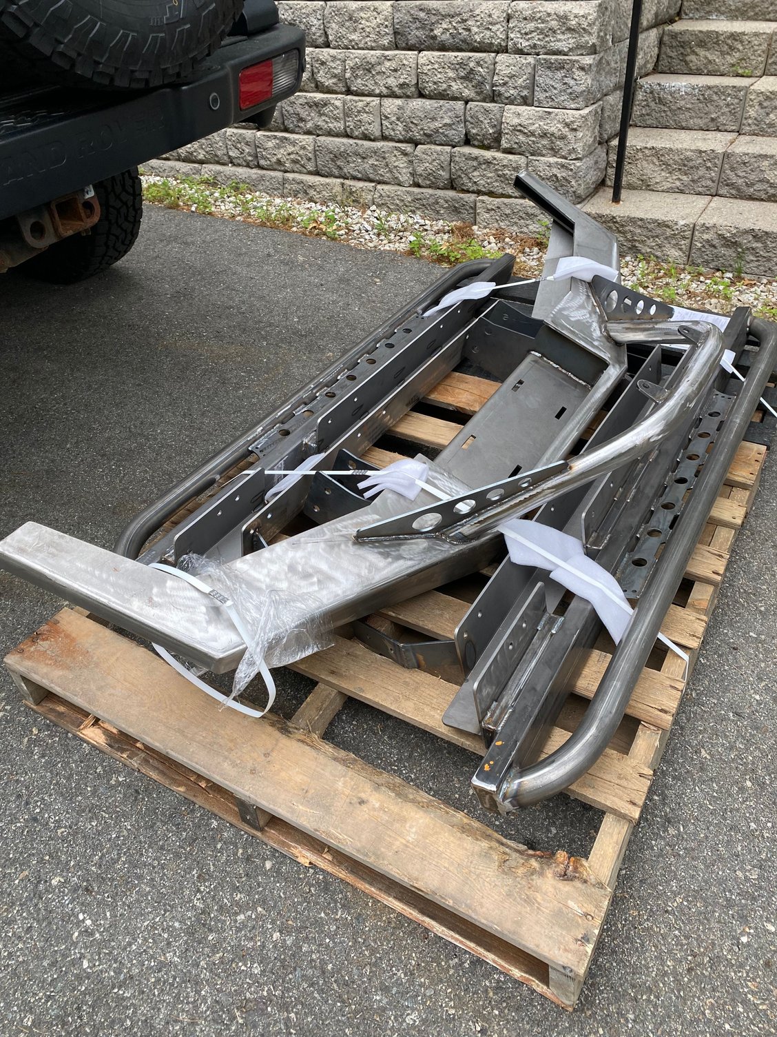

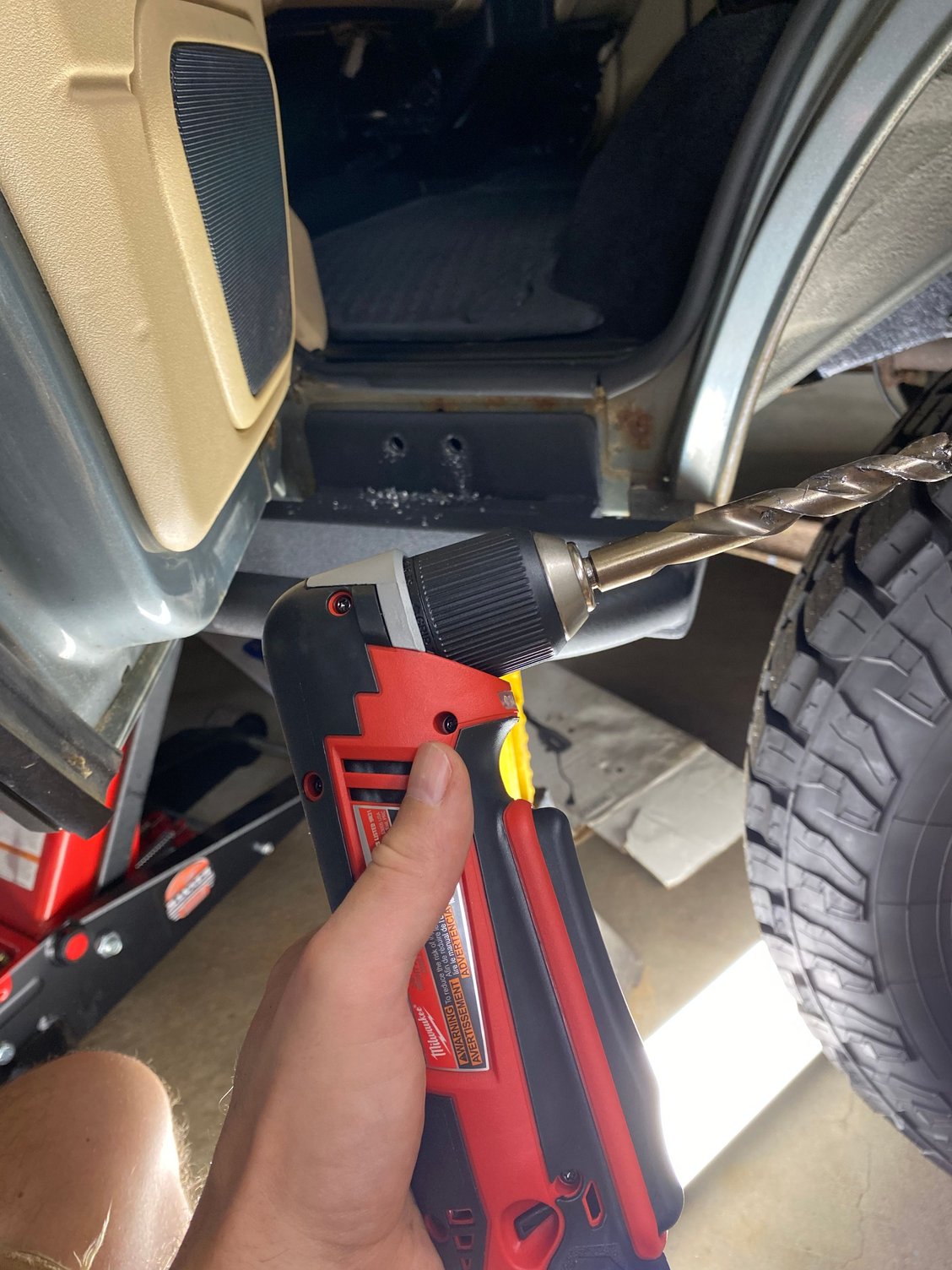

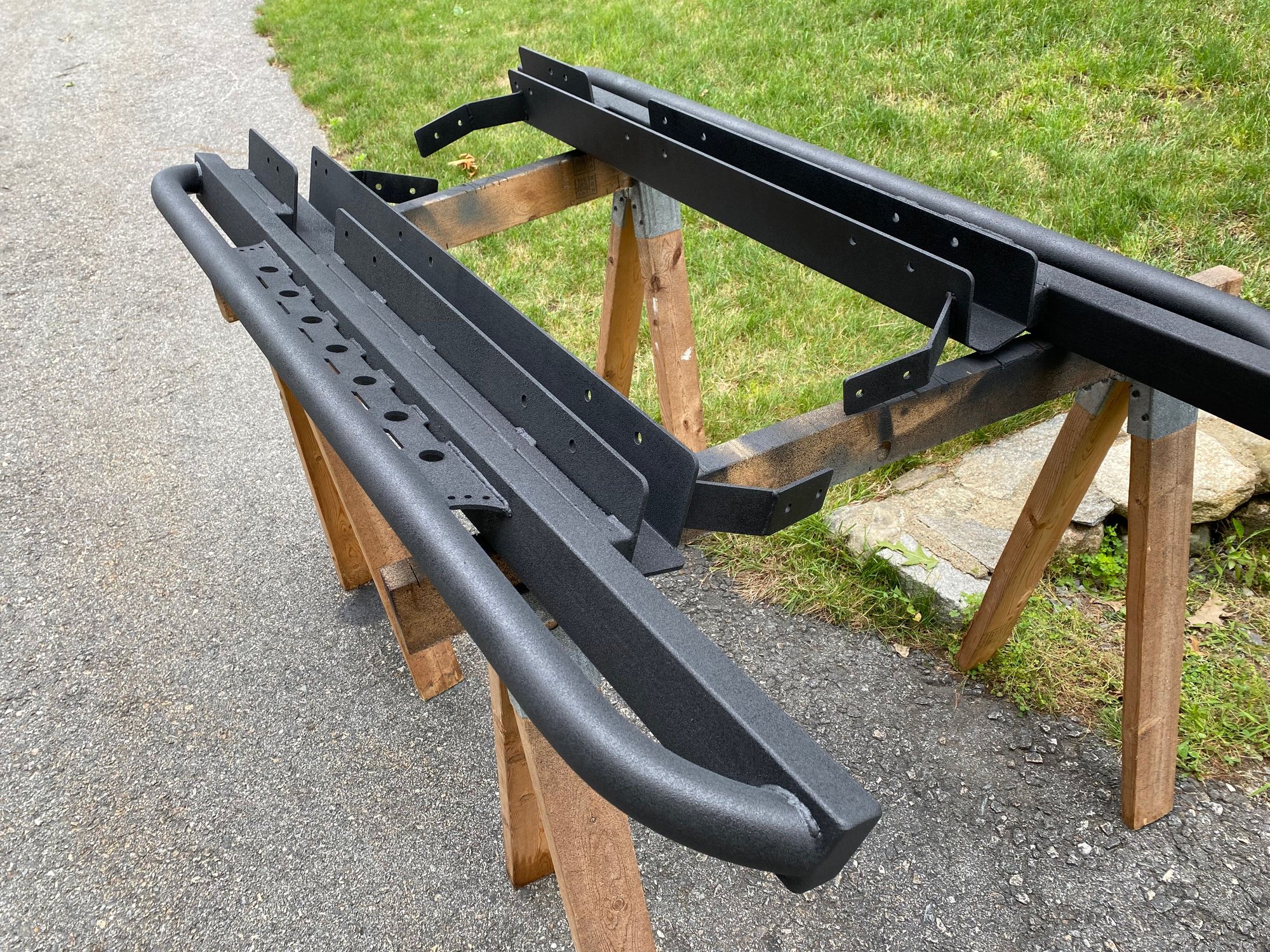

Received my DarkCrow sliders and front bumper about a month ago and have been slowly getting them painted and mounted. It’s rained every single day in July here and I really don’t want to spray them

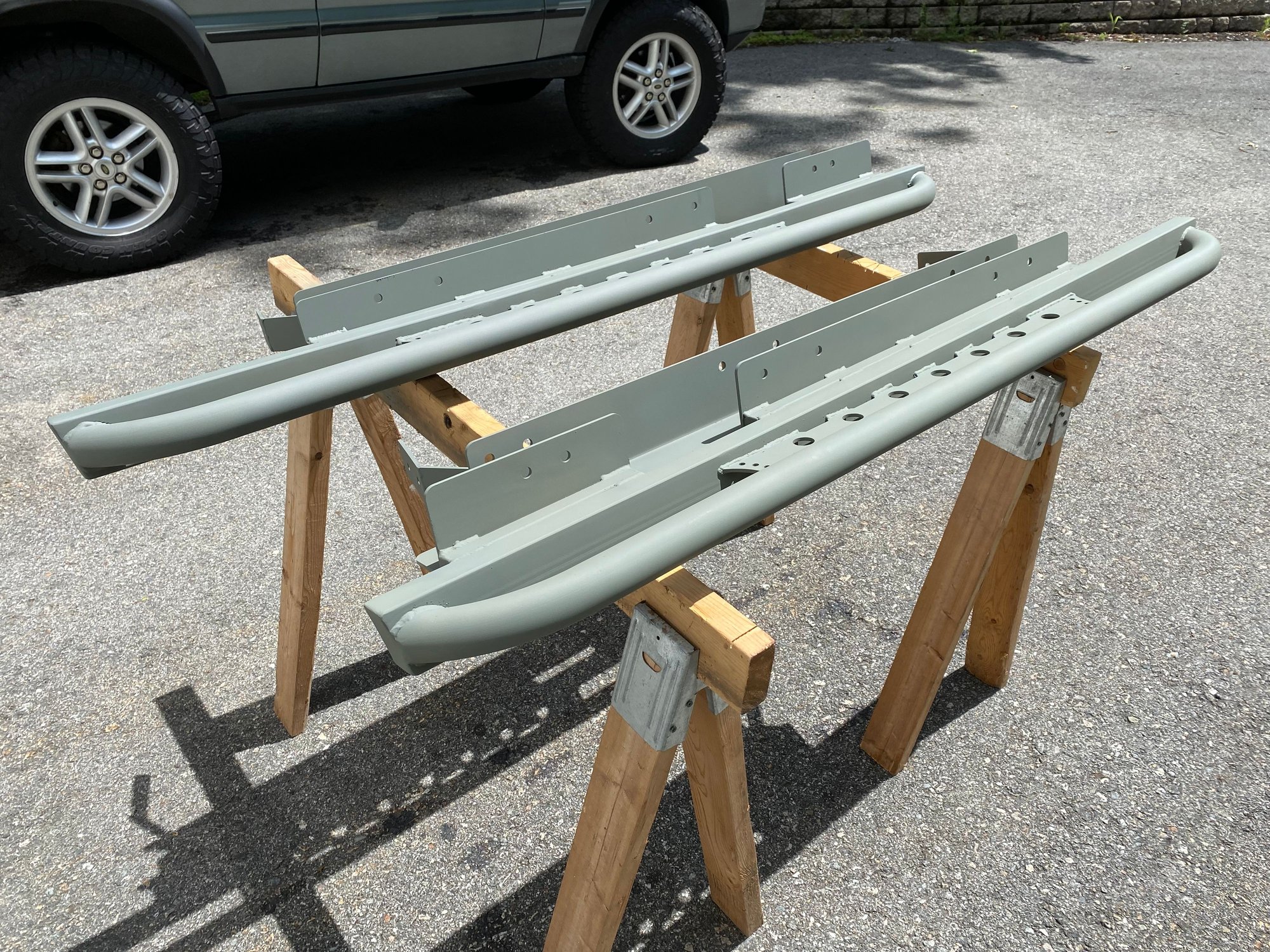

in my garage so that has delayed me. I managed to get the sliders prepped/primed/painted over the course of a few dry mornings. Not hard work as long as you have the correct tools. A right angle drill is required with a shortest 1/2” drill bit you can find to get some of the holes done, specifically on the rocker side underneath the truck. I went with Raptor liner in a rattle can after some research.
As delivered off the lift gate
Prepped with brake clean and wiped down with microfiber cloth. Finish welds where very good with very little sanding required.
Three coats of Raptor liner from rattle cans. It took about 4 cans total.

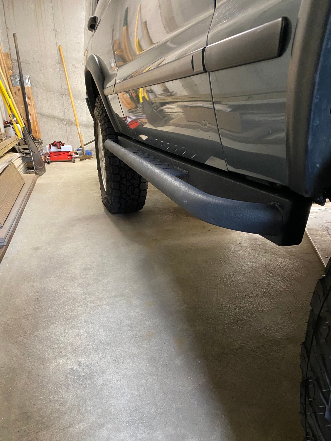

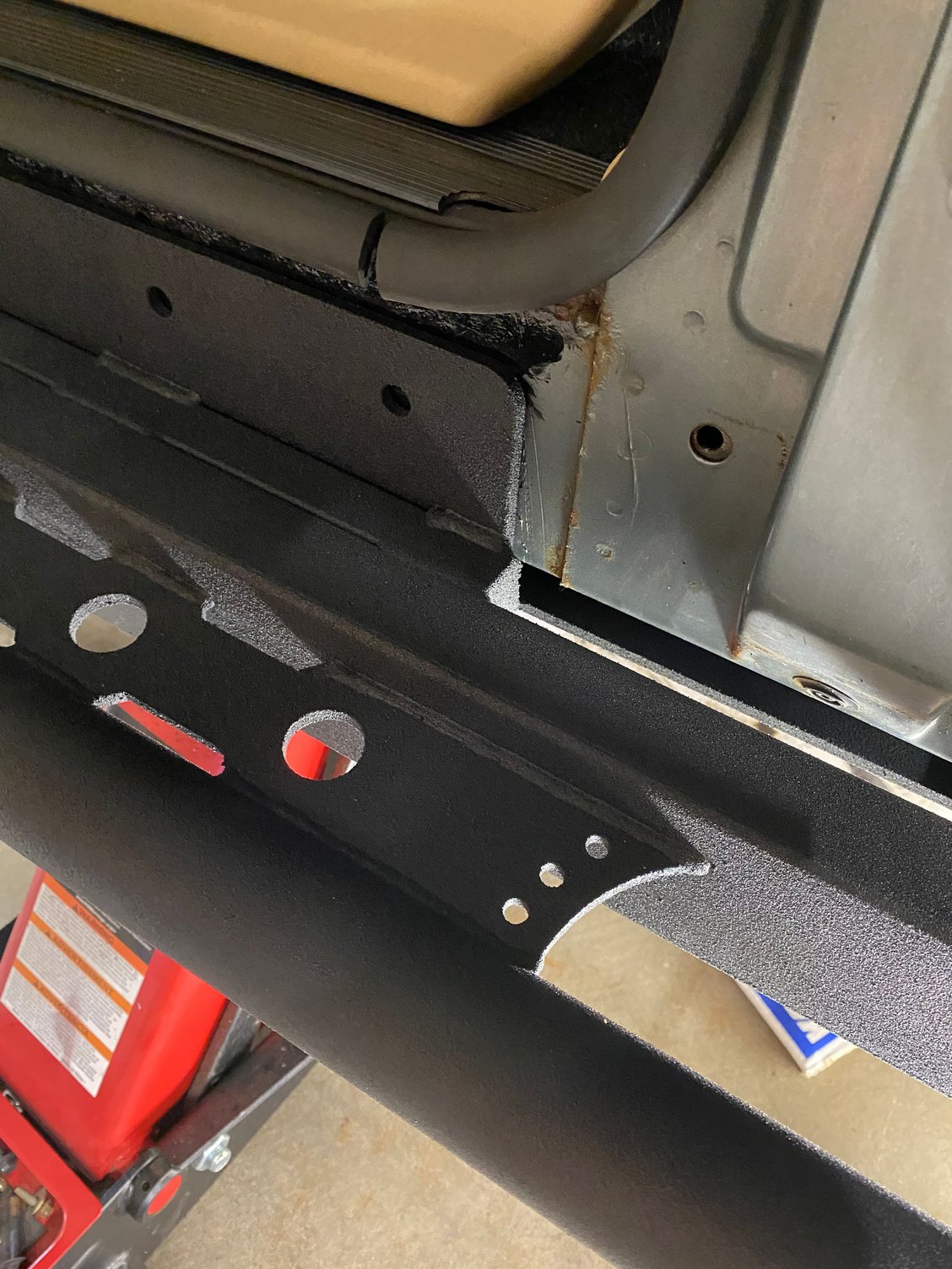

Make sure the pocket for the rocker panel is lined up flush to the front before you start drilling.
Great fitment and follows the body lines nicely
Right angle drill is a must. The left most hole on the rear door is impossible to drill straight otherwise.
