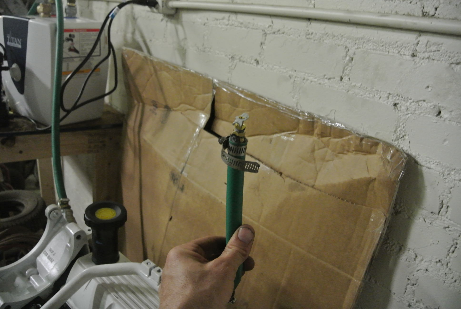

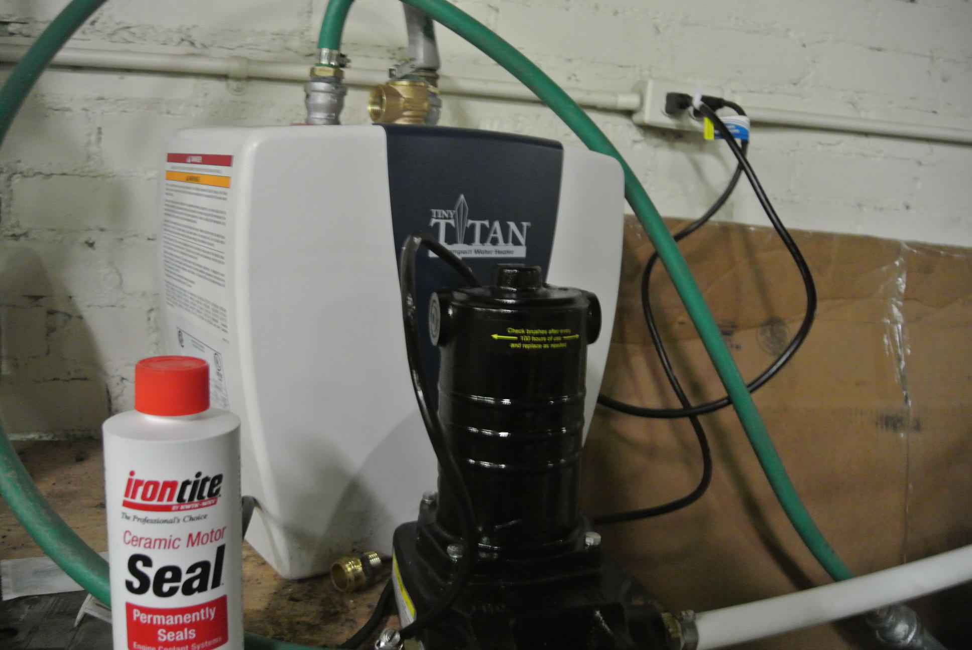

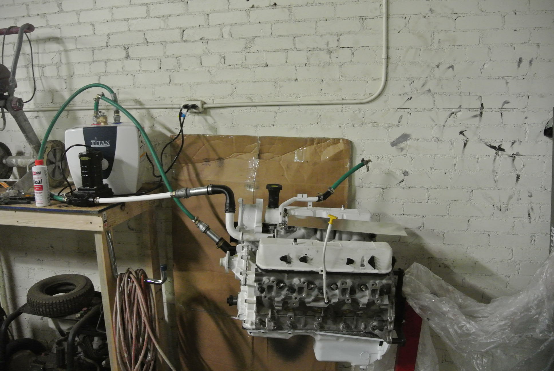

irontite ceramic seal @ 180 degrees with 3 gallons of h2o. 12-18hrs
this is supposed to be an armor against over heat and provide extra heat dissipation. basically, i am heat treating a ceramic coat in all the water ports to smooth surfaces and keep it from cracking

It's the block seal not the head gasket in a bottle

Your idea, Drow. So if I pull these hoses off and find a solidified turd, in what used to be a water port...........
I should have used a smaller water pump. This one was too much @1500 gph

i think your right, i think a slow even flow would be better
