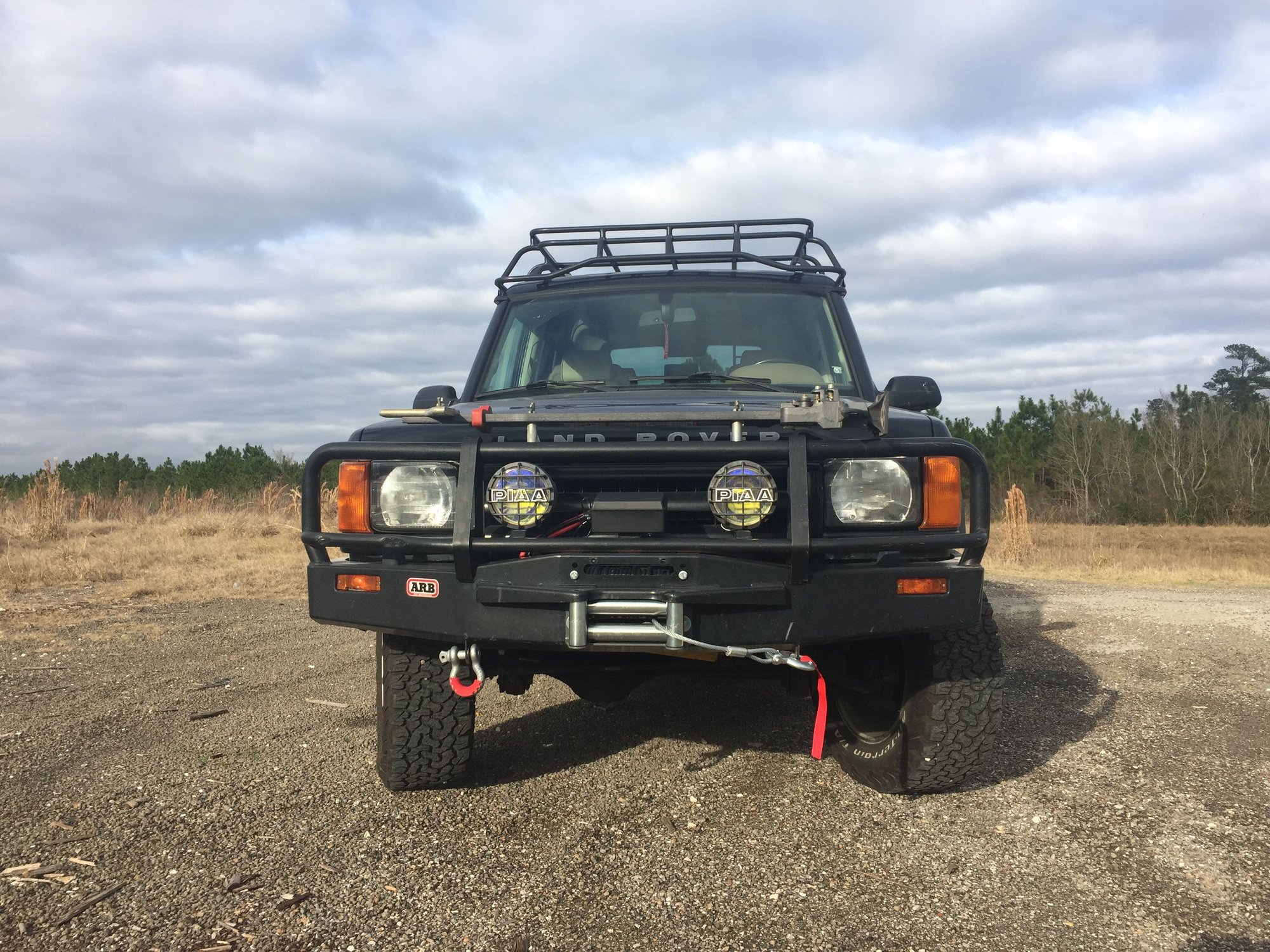

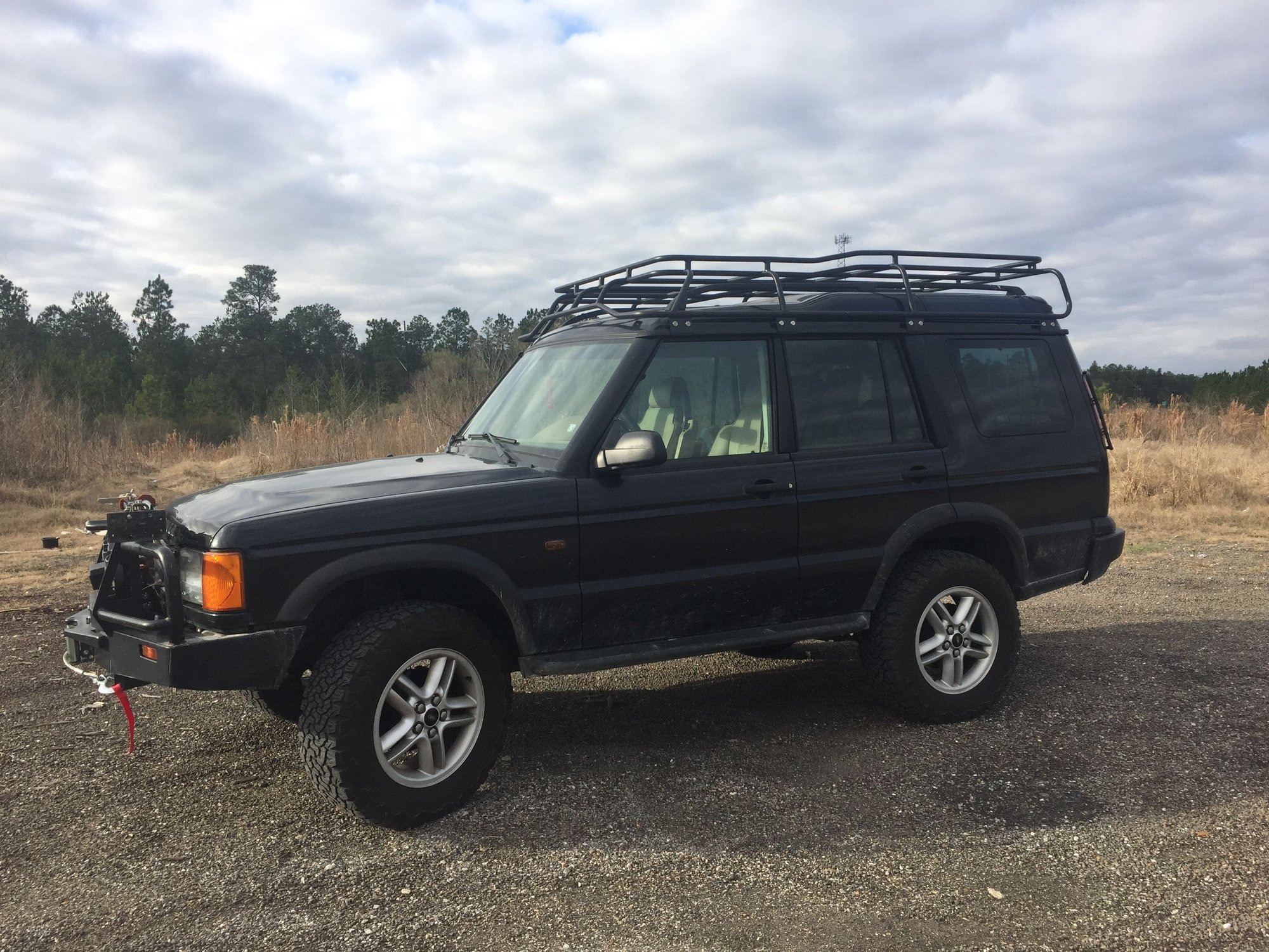

Old Faithful's original starter finally started to get weak. It still cranked, but it wasn't as fast as it should be. Slapped on a perfectly good spare I had in my shop & now she turns over nice and smooth again.
Still looking into a replacement metal rear bumper for it, and some LED lights for the roof rack.
