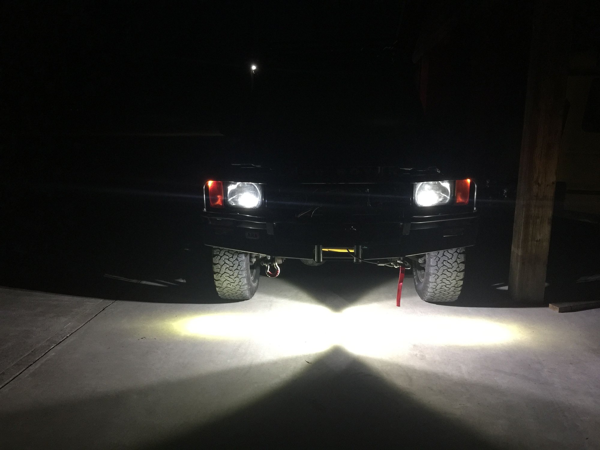

I also added some LED cube lights behind the ARB Bumper and have them criss crossed to light up in front of each front tire. If it doesn't help while off-roading in the dark I can always aim them forward as Fog Lights.

Finally a night pic

Ha!! I was going to do this with my fog lights (was thinking of making a mount that you can swivel up and down) after replacing the stock bumper with a steel one.
The swivel would be locked so they would be right under the bumper and pointed forward during normal operation and then swivel up so they point straight down as needed.

Small leds in the tops of the wheel wells, top of shocks area work great for night time 4 wheelin.

They might also come in handy for trail repairs lol. I made absolutely sure the light source itself can not be seen from the front or the side. They are tucked neatly out of the way. That is what a rock light is supposed to be vs the stuff I just saw at the new 4WP in Beaumont, TX Grand Opening where it was purple, blue, green, red, and god help us pink lights under a Jeep.

Are those city lights in the main light housings?

Yes to take the pic I only had the parking lights on, so the 194 LED’s were the only things on in the headlight housing.
