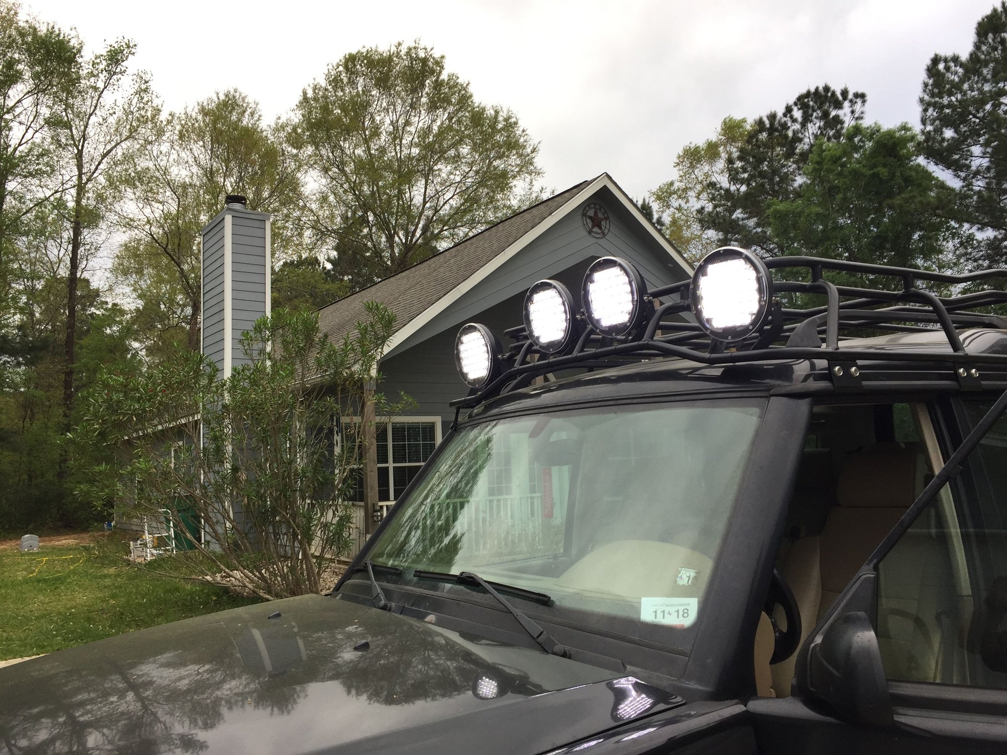

Installed some ARB LED (copycat's) onto the roof rack (working on the wiring), and I also ordered a snorkel. When I do the Snorkel install I plan on routing the wires up to the roof rack.

Yep those lights are very nice (very pleased with the price & quality). I actually routed the wiring up the passenger side, and it fit perfectly under the 3 metal clips in the gap between the glass. I then notched out the upper A Pillar trim (small piece not the big long one) so the wires could pass thru it then I ran the wires to the lights and zip tied the wiring to the rack so you honestly don't even see it. Then I used an OEM Cruise Control Switch, (got a spare pig tail from a junk yard), swapped out the front of the switch with the OEM Aux Lighting Switch, tapped into the dash lighting illumination, and then connected my 3 wires from my wiring harness.
Now when I install the snorkel, I'm going to run another set of wires up that side and run them to the back of the rack where I'll install two small LED Cube lights.
