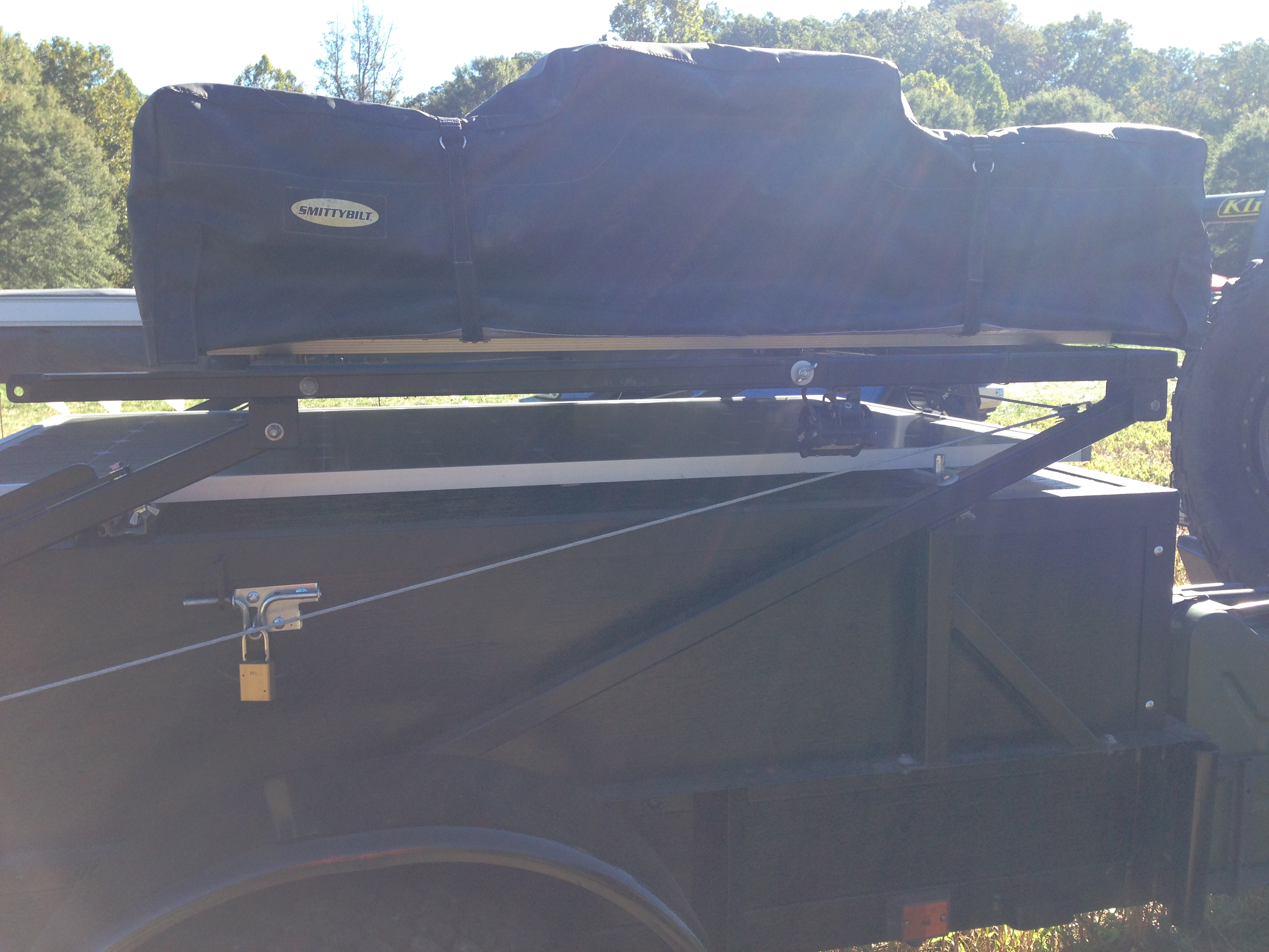

I saw this set up at overland expo 2016.
Attached Thumbnails Camp Trailer with a Roof Top Tent (RTT) build thread-4a6987e9-d560-4f2f-910a-c8e7f55fc1ae.jpeg   Camp Trailer with a Roof Top Tent (RTT) build thread-37b92f95-55cb-456b-a8b4-42cbdf45edab.jpeg   Camp Trailer with a Roof Top Tent (RTT) build thread-f069f6a7-c83b-4c56-8618-10ddf3707855.jpeg   Camp Trailer with a Roof Top Tent (RTT) build thread-0a02602b-15bb-4003-b7a5-94fd941b0573.jpeg

Davis, that is a cool setup. I wonder how it would work with my side shelf/box fenders?

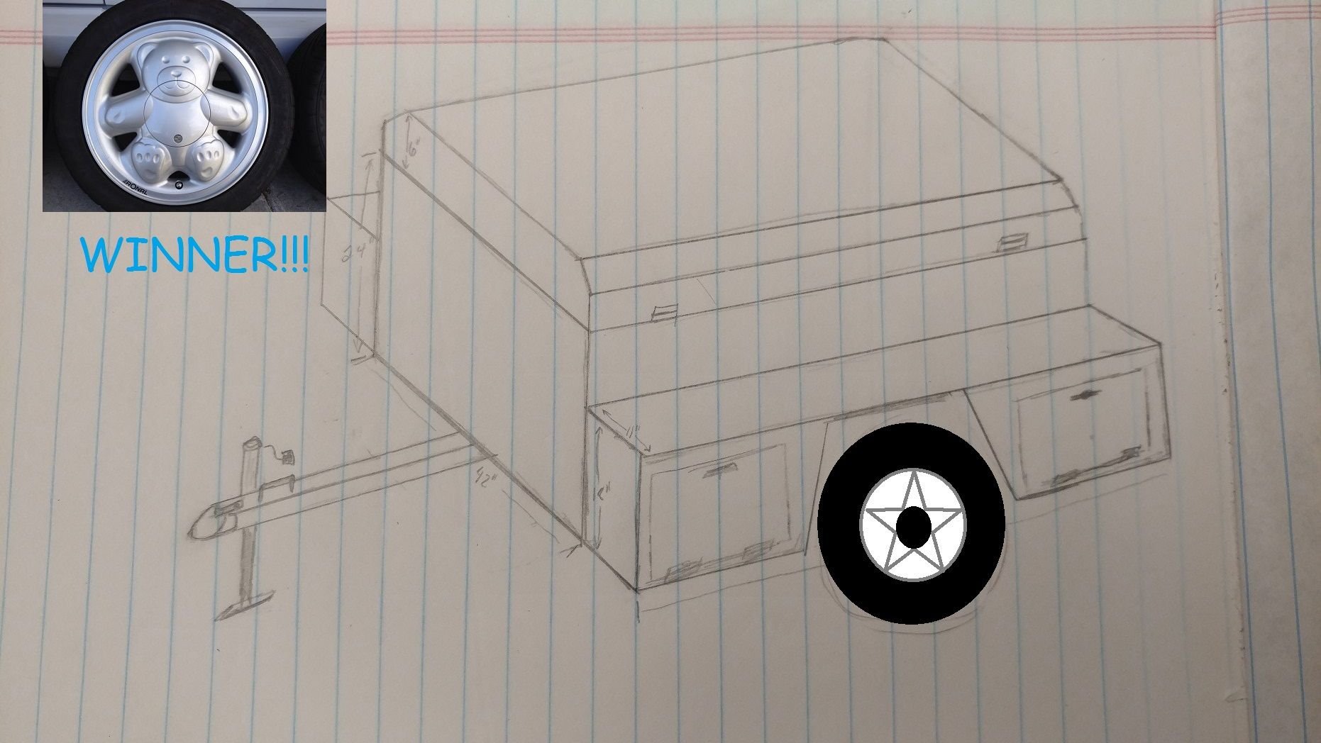

Got the rear view drawn up today, while I was on a conference call.
Not sure about the spare tire. First thought is underneath it's easy but ground clearance could be a issue. The other idea I had was a basic swing-away carrier.

Oh yeah, that design would definitely interfere with side boxes. When I had my RTT on a harbor freight trailer, I used a Trac Rac ladder rack from Lowes. The tent wound up being right at 5 ft high but way under the roof of my 4Runner.
