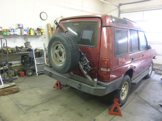

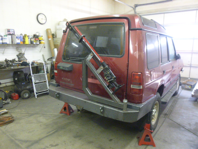

Started on the swing arm today.
This is made from 3 x 2 rectangle for the prototype, but will be cut from plate and the intermittently welded around the perimeter and in structural/supporting areas. Making it about 2.5" deep x approx 5" wide across the face and rear plates.
There will be 2- Hi-lift mounts. 1- for the 31.5" tire or less (as shown) and one 3-1/2" down and out for up to a 35" tire. Looks like both 48" and 60" jacks will stay below the roof line as well.
Out to the drivers side will be a bolt on bracket to accept 3-2 gallon or 2-3 gallon RotoPax cans.
The tire mount will be set at a height to accept up to a 35" tire and then an adjustable backspacing mount as well.
While this is a little crude, it gets the concept on the rig for me to mark-up and change things where needed.
Still need to set the arm back pitch (pull it back approx. 2") Then the heim joint to swing gate adjuster rod, mount and cushion set stop.
That's all for this year guys, see ya next year with more.
Have a safe New Year's and ROVER ON!
Jason

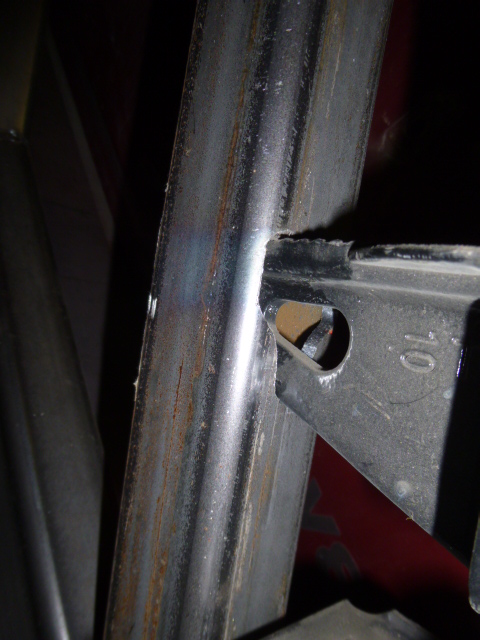

Looking good. Do you have any close up pics of the HiLift mount? I've been wanting to mount mine the same way. Can you remove the lift without pulling the spare tire?
Fish, I'll get a couple shots for you.. give me a few.
Yes, you can... I have hex nuts on now, but plan on using pinned wing nuts. Just reach behind and unscrew. The Hi-Lift jaw is inset into the arm as well so it does just fall off when loose.
Jason
Here ya go Fish.
Jason
