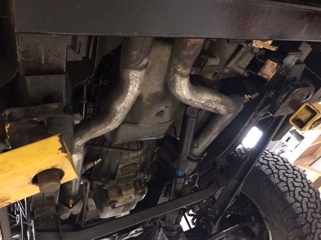

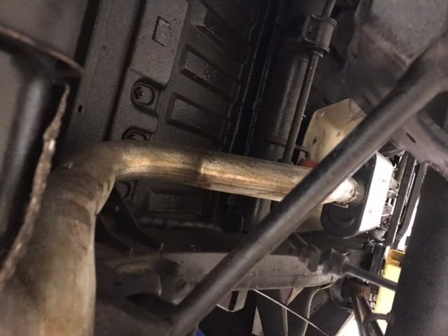

Lots of clearance for the axle
2 into 1 muffler from the headers
From the hedman headers
Custom exhaust with no cats, cel eliminators, now no check engine lights or codes. I replaced 1 o2 sensor and reconnected the plug on the other. Lol. Easy peasy
