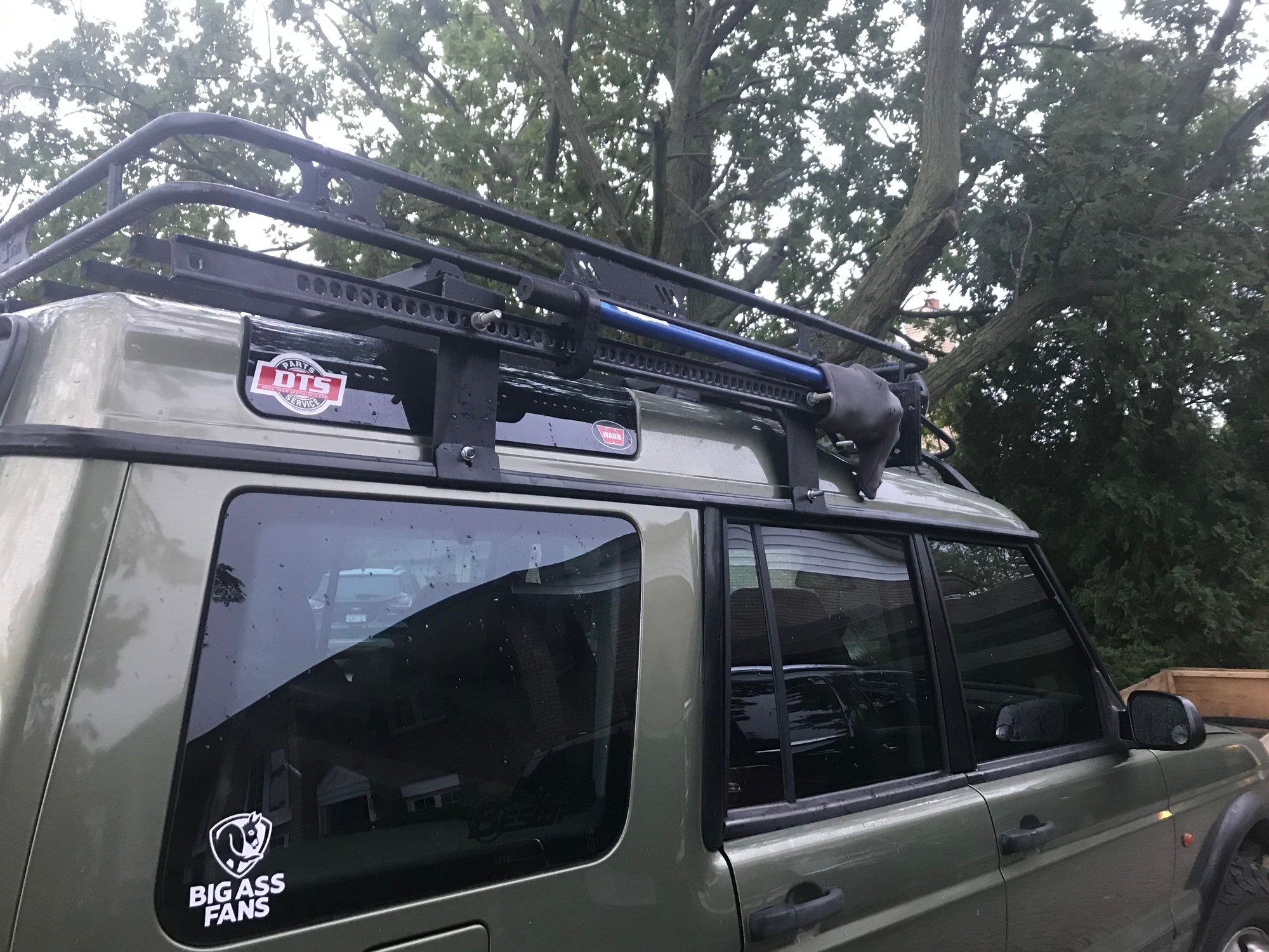

The rack is also mounted to the factory roof bars. I sure hope the rain gutter is strong enough, are not most all roof racks mounted on the gutters?

@Fastercat Sorry working and responding, you are correct that roof racks are mounted that way. But the weight is distributed over all 4 or 6 mounting points. the front runner rack at 85 lbs uses 6 legs. For the highlift you are mounting 65 lbs to 2 legs, plus your rack. My concern would be the gutter deforming if you do any amount of off roading. The general though on the overlanding forums is around 220 lbs on the roof. with a baja or similar rack. I would think the same with your setup.
It may not be an issue but I tend to think about worse case.

I like the idea of having it up there, I’ll keep an eye on it, if I notice anything I’ll change it up. Maybe I could add 1 more support in the middle. Or widen the feet to spread the load. My rear supports are 4&1/2” wide, the front is clamped solid with unistrut window brackets around the factory bar. I’d estimate the weight of the rack around 90-100 lbs. just guessing. I wrestled it up there myself off a 6’ ladder trying not to drop it down and scratch anything. Lol
I'm definitely not super man anymore. Next time I’ll get some help.
I only plan to carry stuff up there on the toad and to camp sites. Serious off-roading will have me empty the rack.

@Fastercat I think if you added a 3rd leg you would be fine,I have seen a lot of tippy trucks in my day. You seen to have the right idea load up to camp site then off load.
I usually just put light weight stuff up top, that I do not expect to need an keep the heavy stuff low.
For example spare tarp, my spare bits box, my walk out food and case with a couple of liters of oil, 1 of trans fluid, brake fluid and PS fluid. Maybe 50 - 60 lbs. All very low, Disco's are high enough already.
No roof top tent for me I sleep inside.

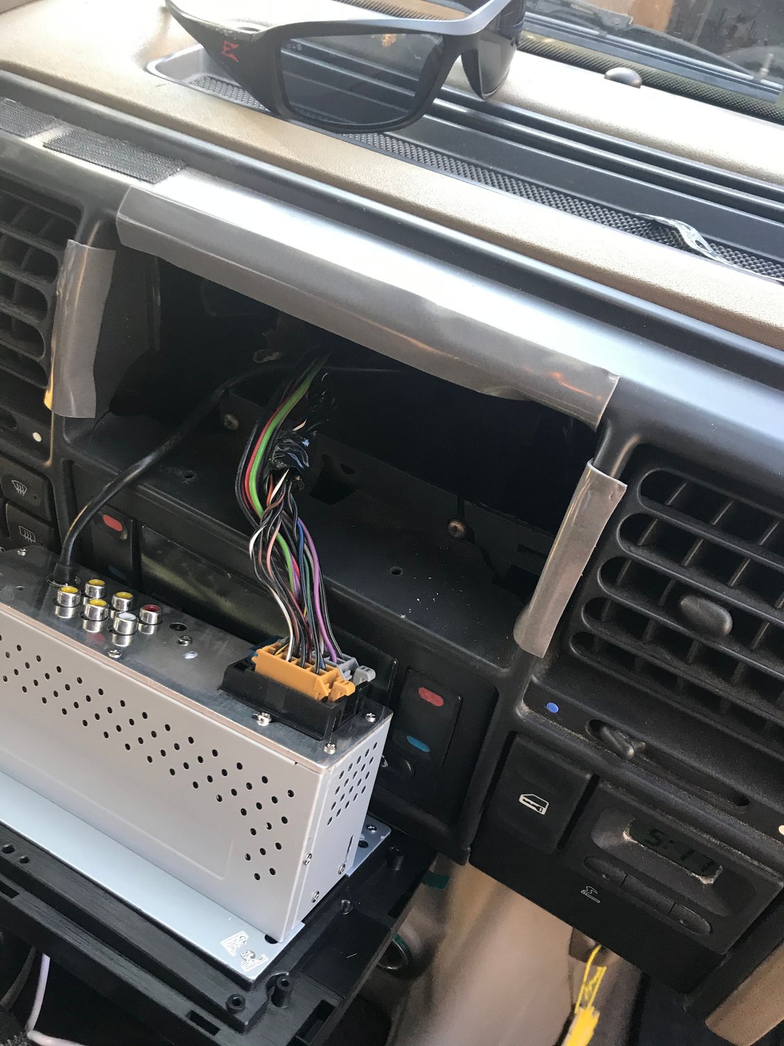

The easiest install I’ve ever done. Lol. 3M double sided tape, factory harness plugs right in
I have to learn the setup, see if I have apple CarPlay, it says it’s supported, I’ll play around with it for a bit
I found this on eBay for cheap $66 Canadian shipped.
so far seems great, the Bluetooth works great, better than the pioneer I took out. If this unit holds up for a bit I’ll post it in the d2 section
