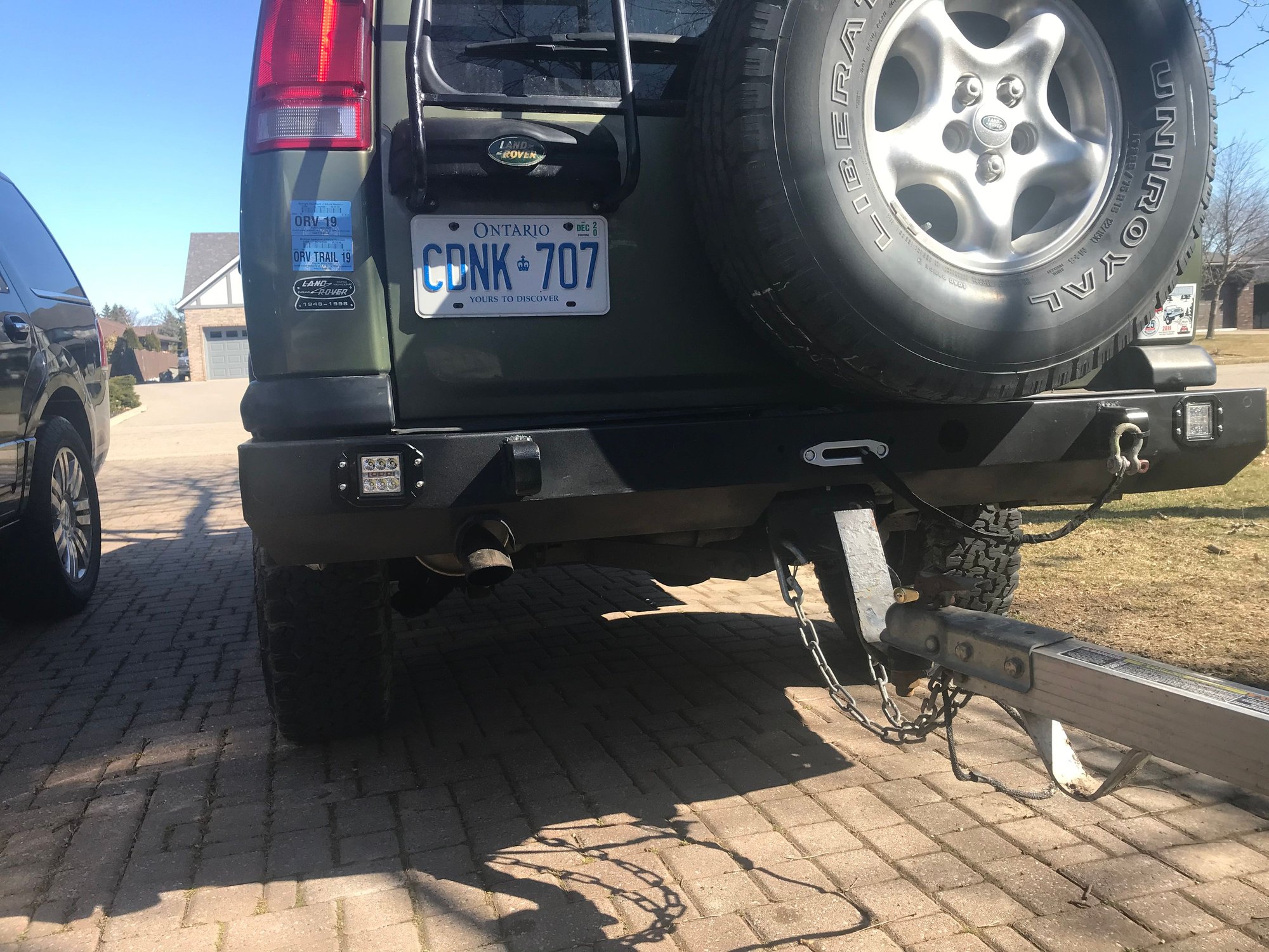

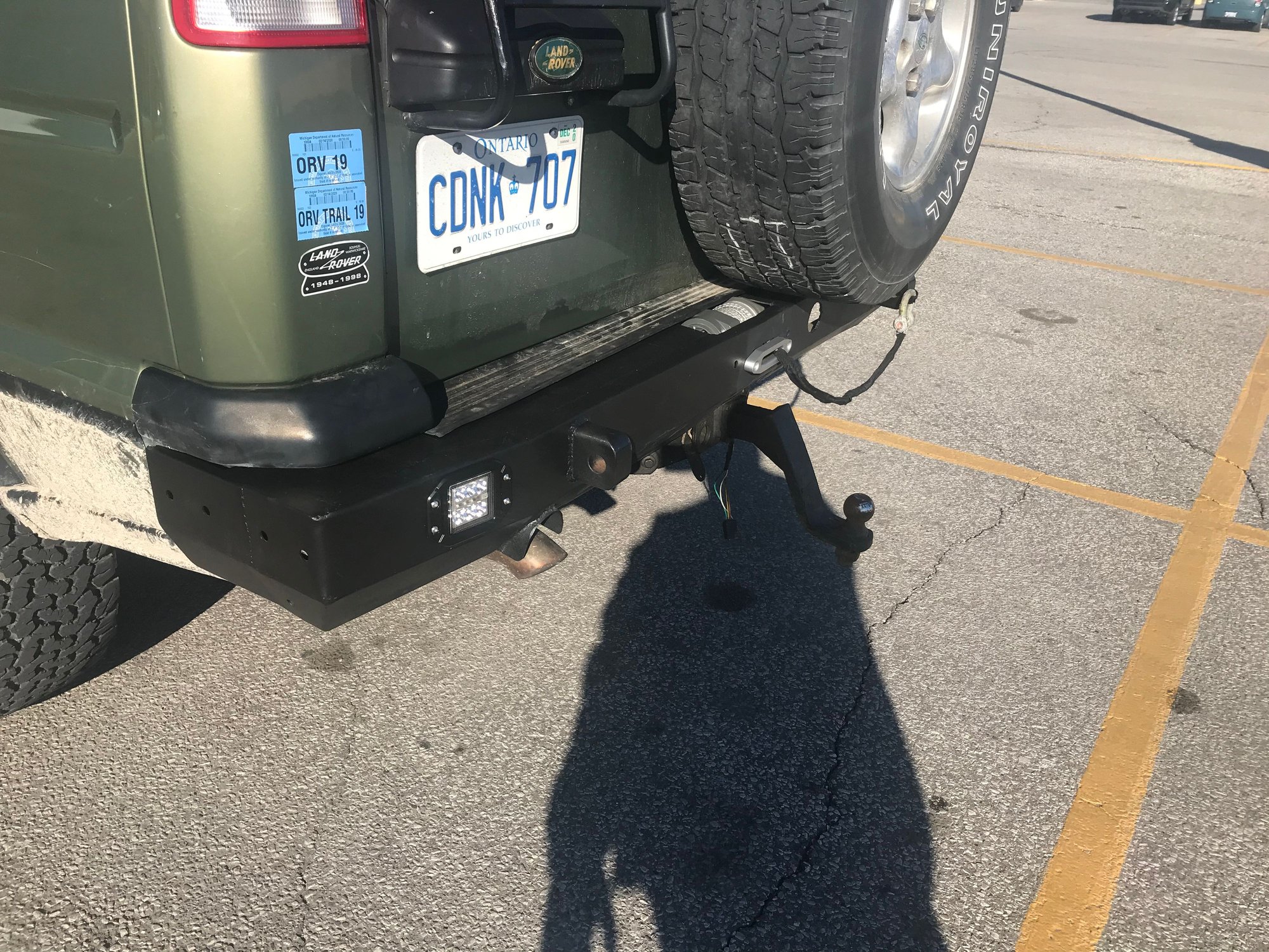

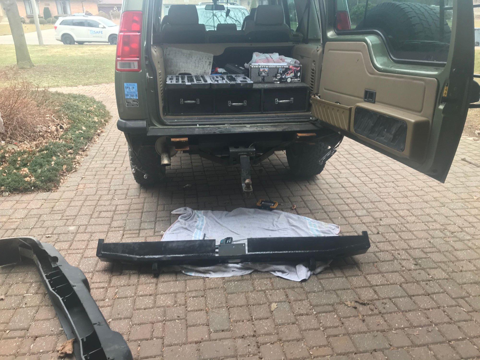

Finally have some time to work in the truck, it’s above freezing, barely lol. So started on the rear bumper again.
Old Mar 15, 2020 | 07:15 PM
  #133
Fastercat's Avatar
Joined: Nov 2017
Posts: 788
Likes: 295
From: Amherstburg Ontario

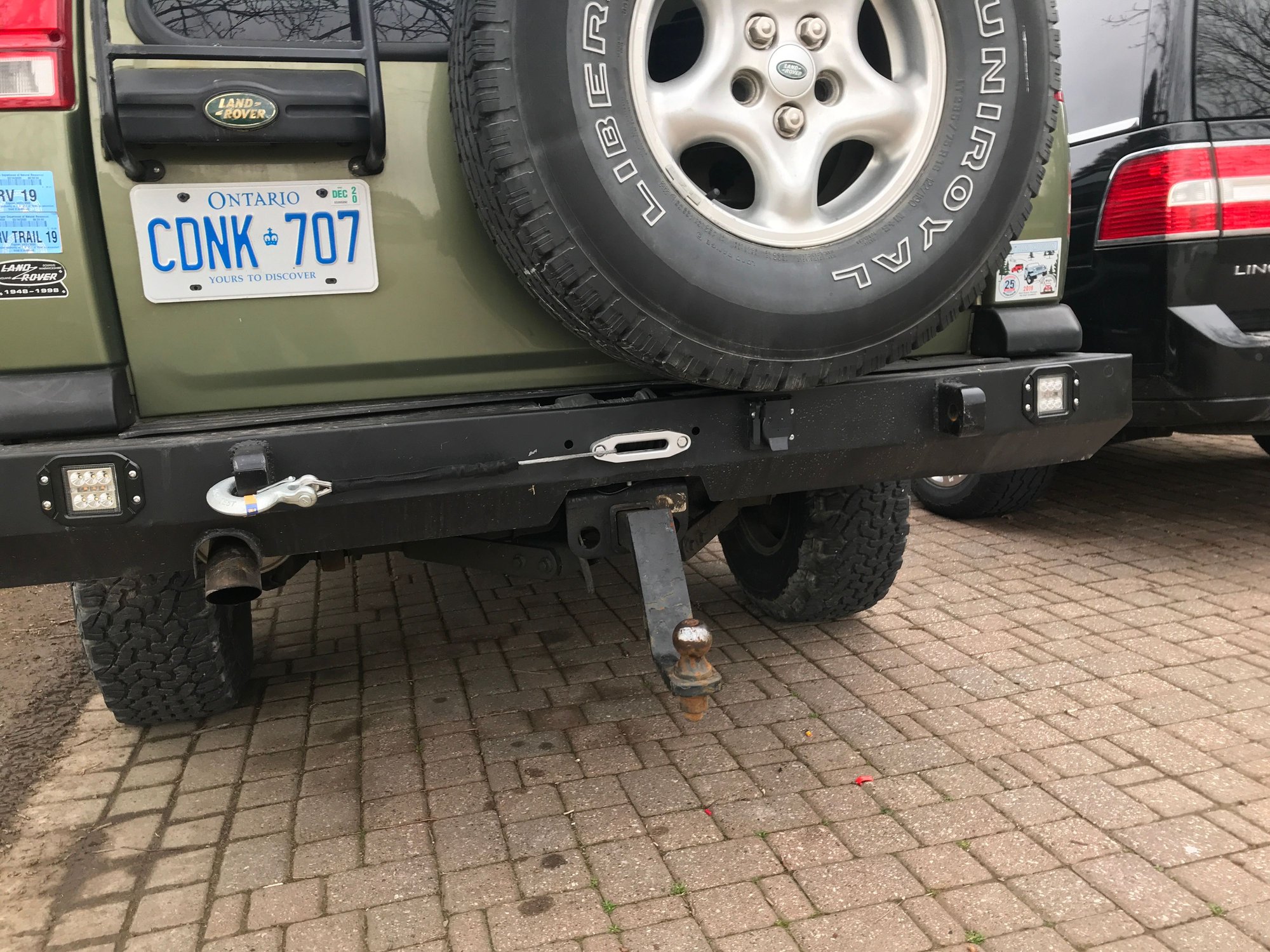

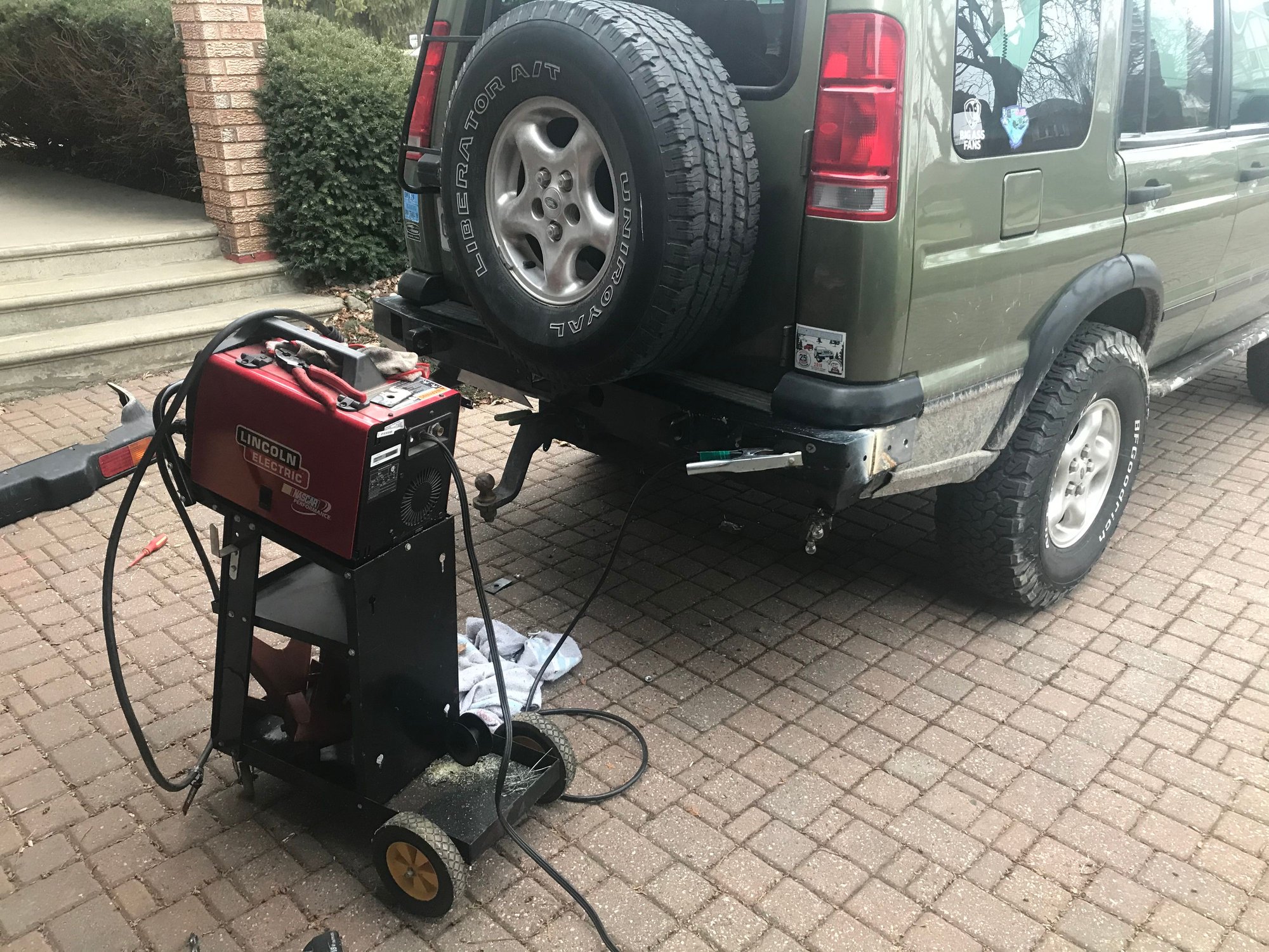

Well it’s on there. Still need to wire up the winch, wire the trailer harness plug, and do some more painting. I also need to do the resistor mod for the new led turn Signals.

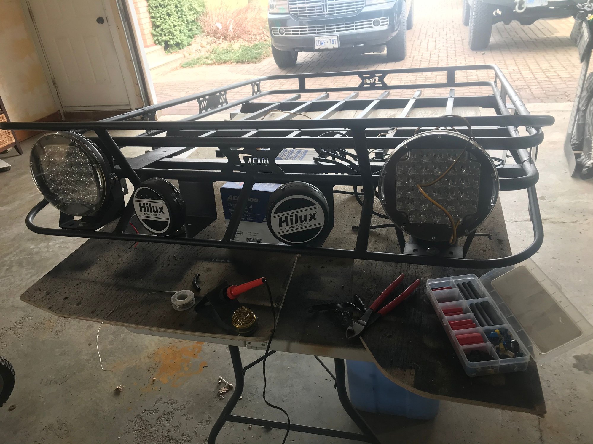

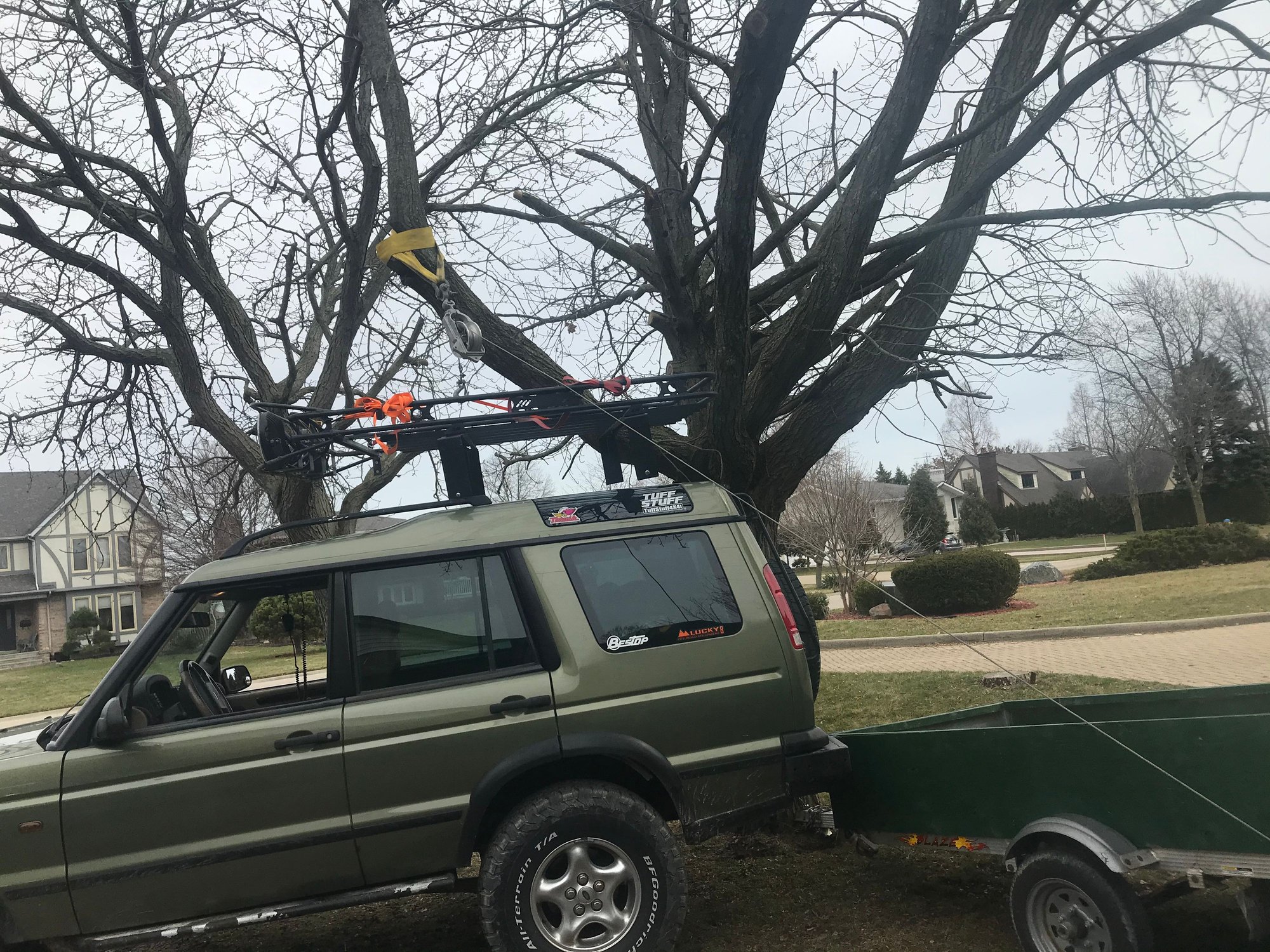

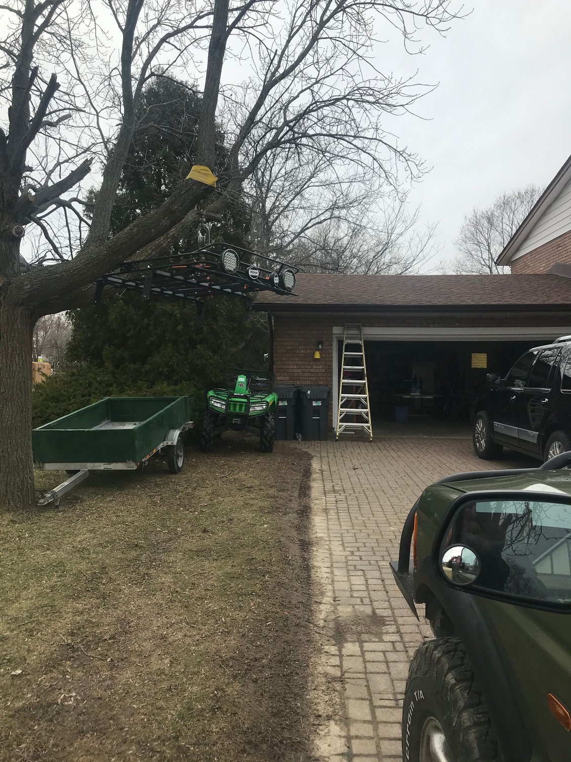

I had more corona virus time so I made protection hoops in my roof rack, wired up the lights properly with soldered joints, wire loom, and reinstalled the rack by my self with the help of my atv winch

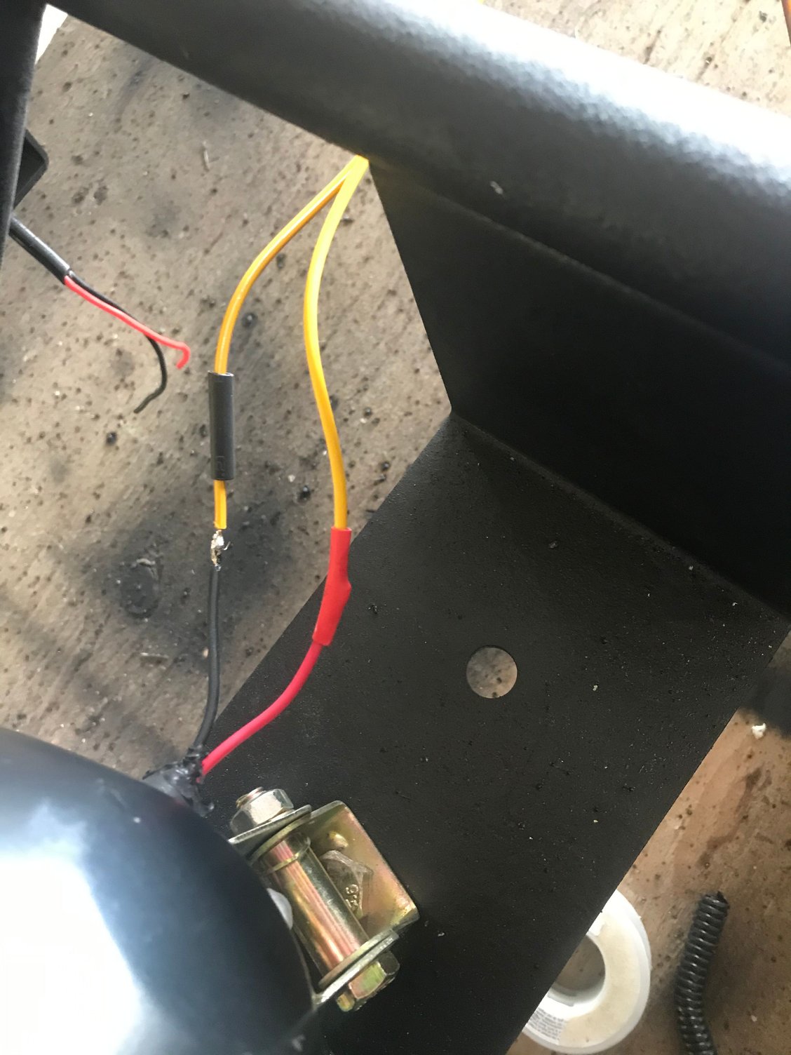

I took some time today and finished wiring the back bumper, winch seems to work great, it is loud tho as it echoes out under the truck. I have a wireless remote for it which should be great for steering stuff onto the trailer as you control it. I wired up my roof lights but I have to redo it with larger wire. I thought the led lights were 96 watts total. Lol that’s each one. So 16amps for them. The wire I ran was too small.

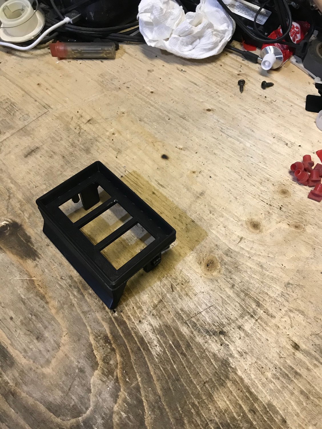

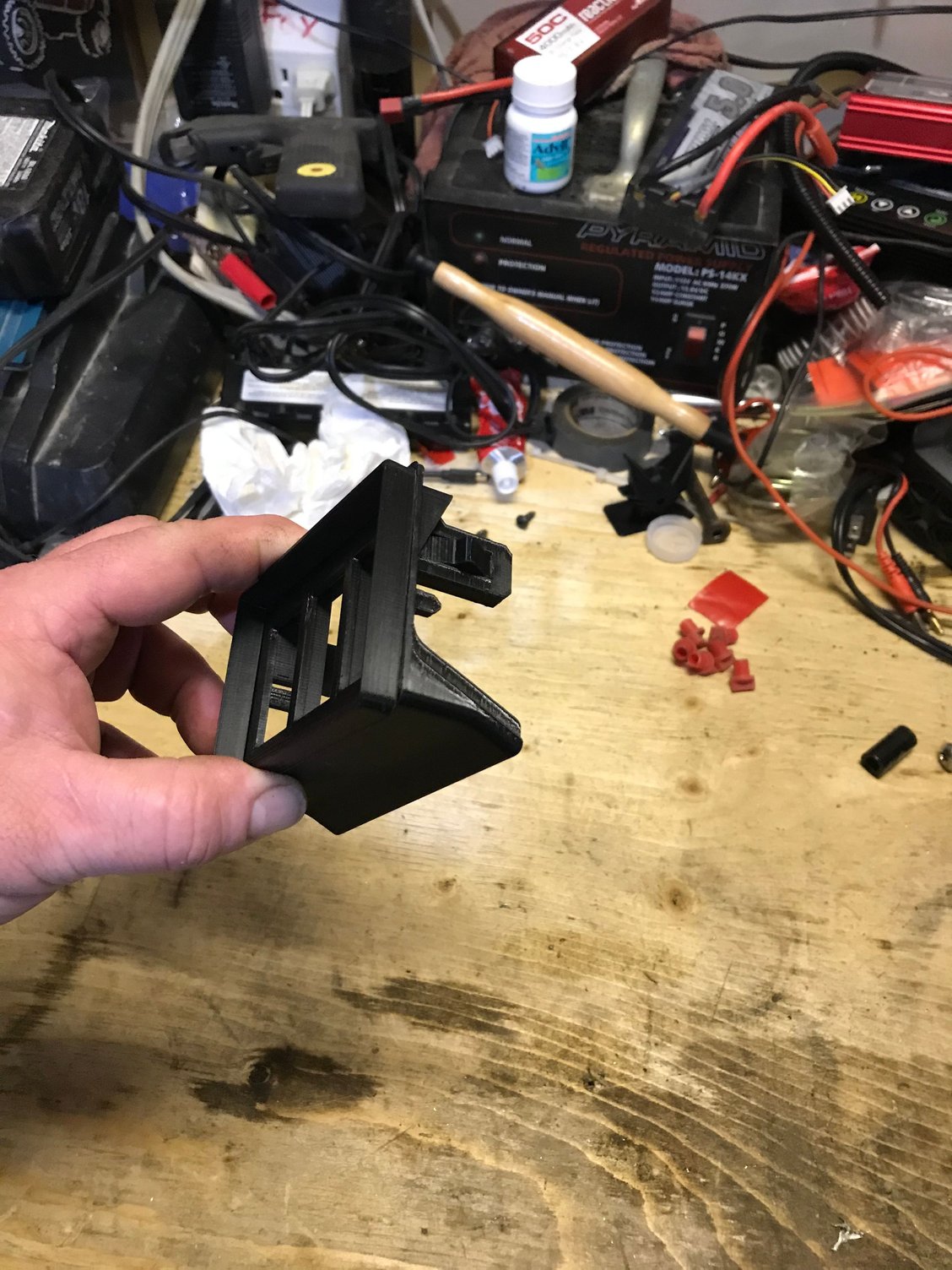

Well after looking around on the Internet I found these switch panels that snap in in place of our change drawers on our dashes. They’re was a 3D printer program for them. My cousin lives around the corner with one and hardly ever uses it. So a phone call and a few hours later and voila! Should be pretty cool. Now I need to order some switches. I used my new rear winch to load an old non running lawn tractor onto my trailer yester which worked great with the wireless remote.
