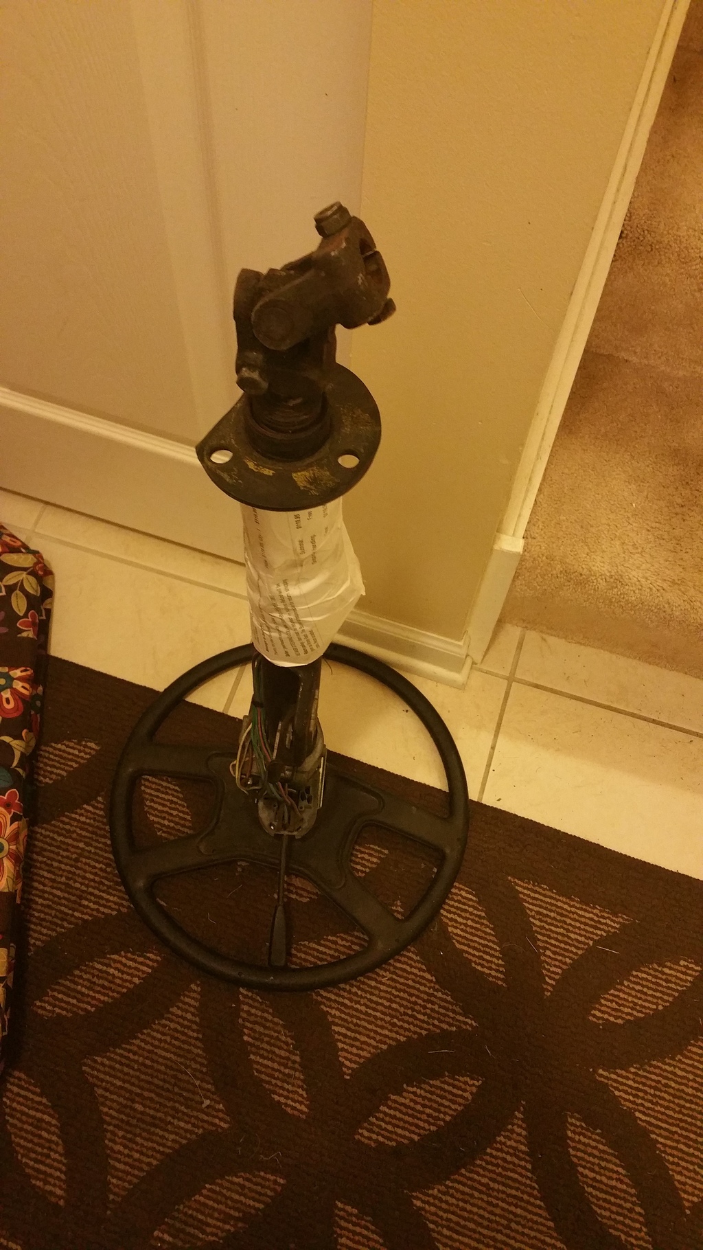

So learning from my mistake last time I immediately opened it and amazing just as described and with all its parts.
My wife keeps asking me if I'mexcited to play with my shaft this weekend....
