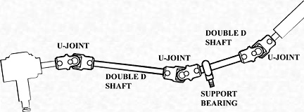

Maybe in concept only....
Zig's Street Rod - Steering - Components
It's not a Rover build thread, MGB with Ford 302 power :D-multiple-u-joint-hanger.jpg

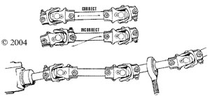

Classic Chevy, Chevrolet, GMC, Ford technical articles
It's not a Rover build thread, MGB with Ford 302 power :D-chrysler-steering-system.jpg
