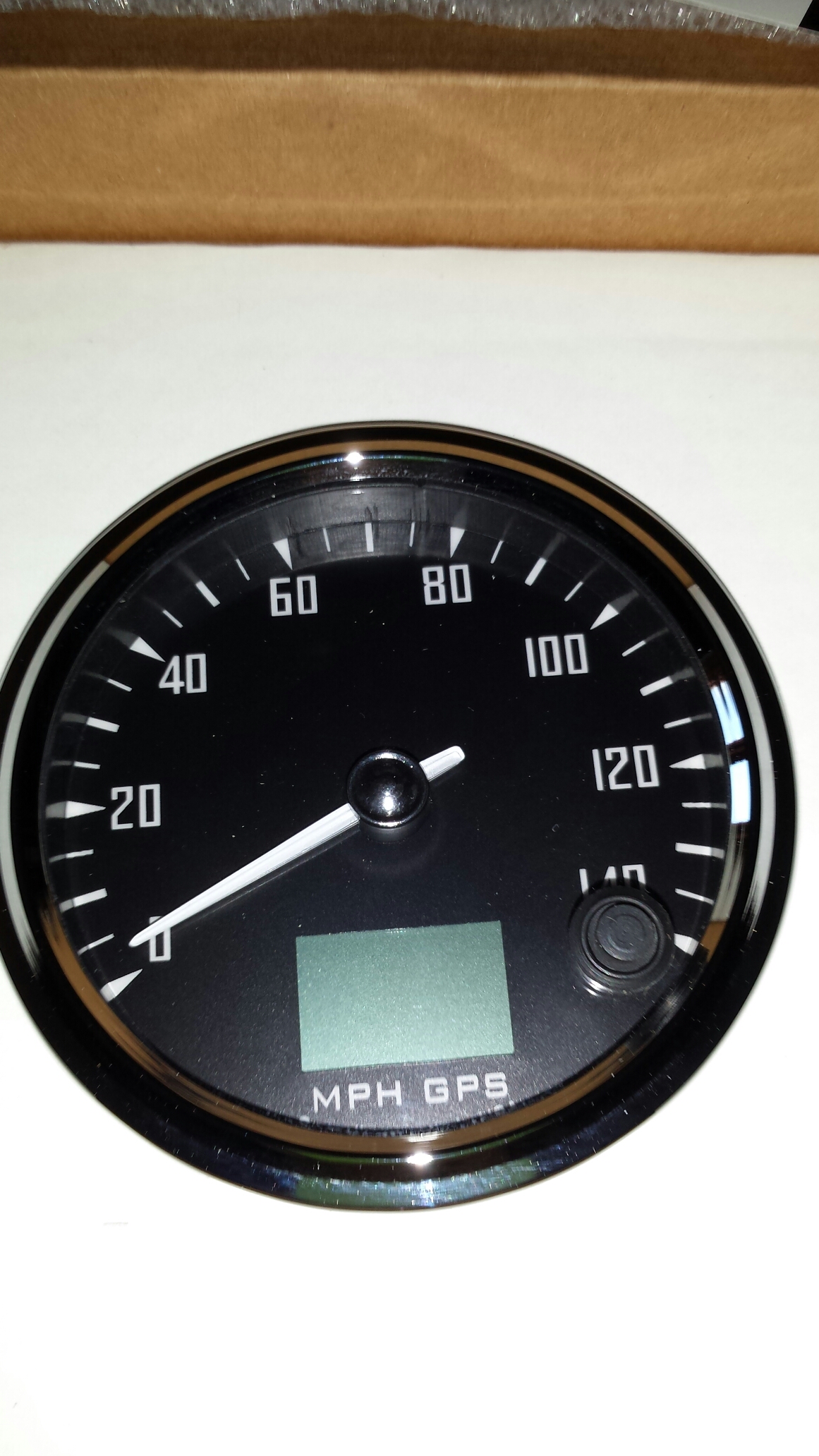

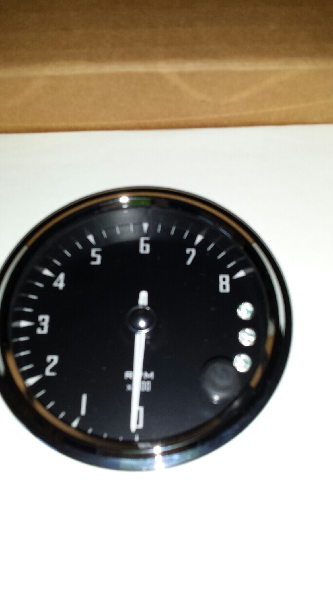

oh and these came in last night from speed hut, it will be cool to know how fast I'm going and engine rpm for once lol.
Attached Thumbnails It's not a Rover build thread, MGB with Ford 302 power :D-gauge-1.jpg   It's not a Rover build thread, MGB with Ford 302 power :D-gauge-2.jpg

Gotcha, 8.8's can also feature disc brakes. I used a Chebby Monza rear axle on mine....no narrowing required...forget what gears I settled on...they weren't very steep as it wasn't required. (350/350 auto combo)..

Than I moved on to the gauges. Figured that would be a easy satisfying project, boy was I wrong lol. That was a nerve racking job, I was so worried as I grinded away material that I was going to destroy my original dash pad. A few hours later and we have the speedhut tach and speedo in place. Couldn't be happier with how that project came out.

Hope your wife gets better. The gauges look fantastic!
Old Oct 11, 2015 | 11:52 PM
  #199
I couldn't be happier with those gauges. Fantastic quality from first impressions obviously. The craziest part is they are american made and reasonably priced. I was joking with the wife that this thing is going to have more american parts than Brit parts at the rate I'm going.
