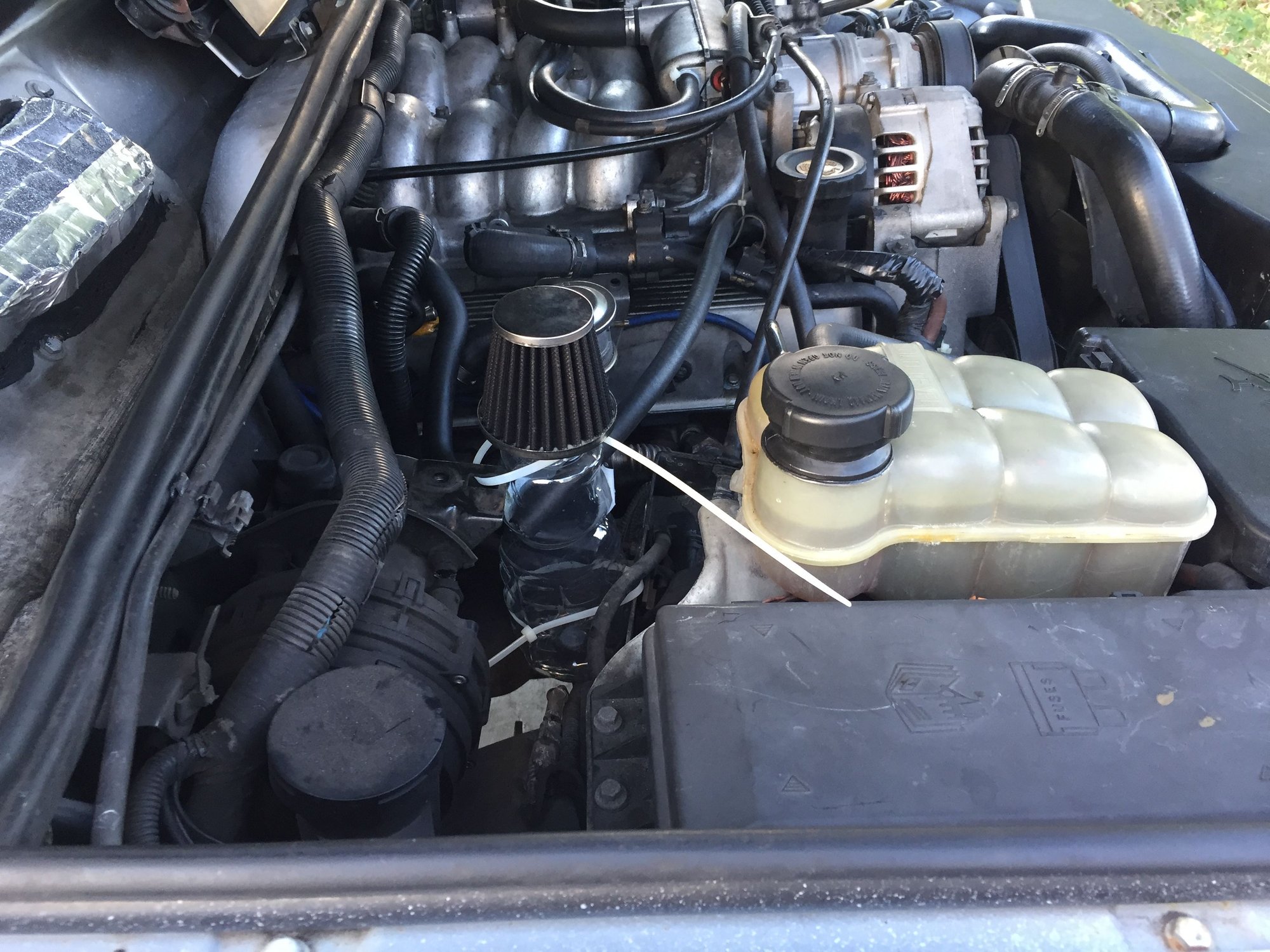

I had made a prototype with a Gatorade bottle and a filter I had left over. Shown below,also in placement as well. I swung the passenger side hose into a hole through the side of the bottle, and extended the driver side valve cover hose into the bottle as well. The intake plenum hose connections can now be blocked off with caps. The prototype isn’t pretty but it did work, I then picked up a “nicer” looking catch can for cheap on the web. However the smalller filter element was creating lots more vapor as opposed to the prototype. I simply swapped over filter media’s.
Prototype subject “a”
Purchased this through the Internet.

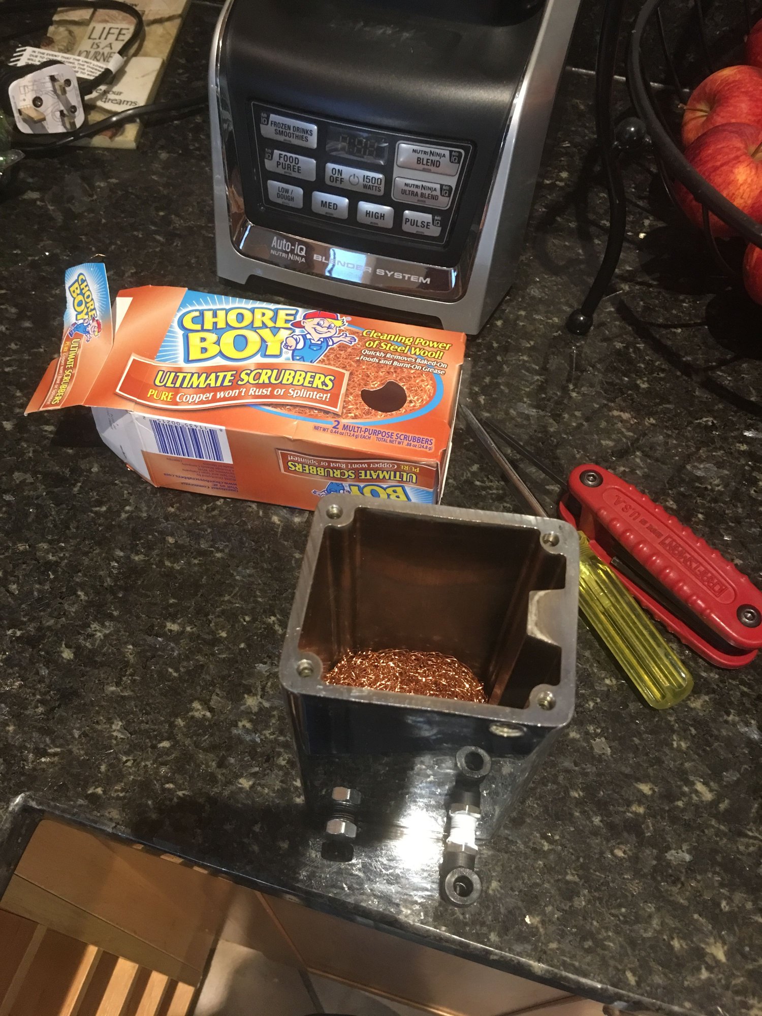

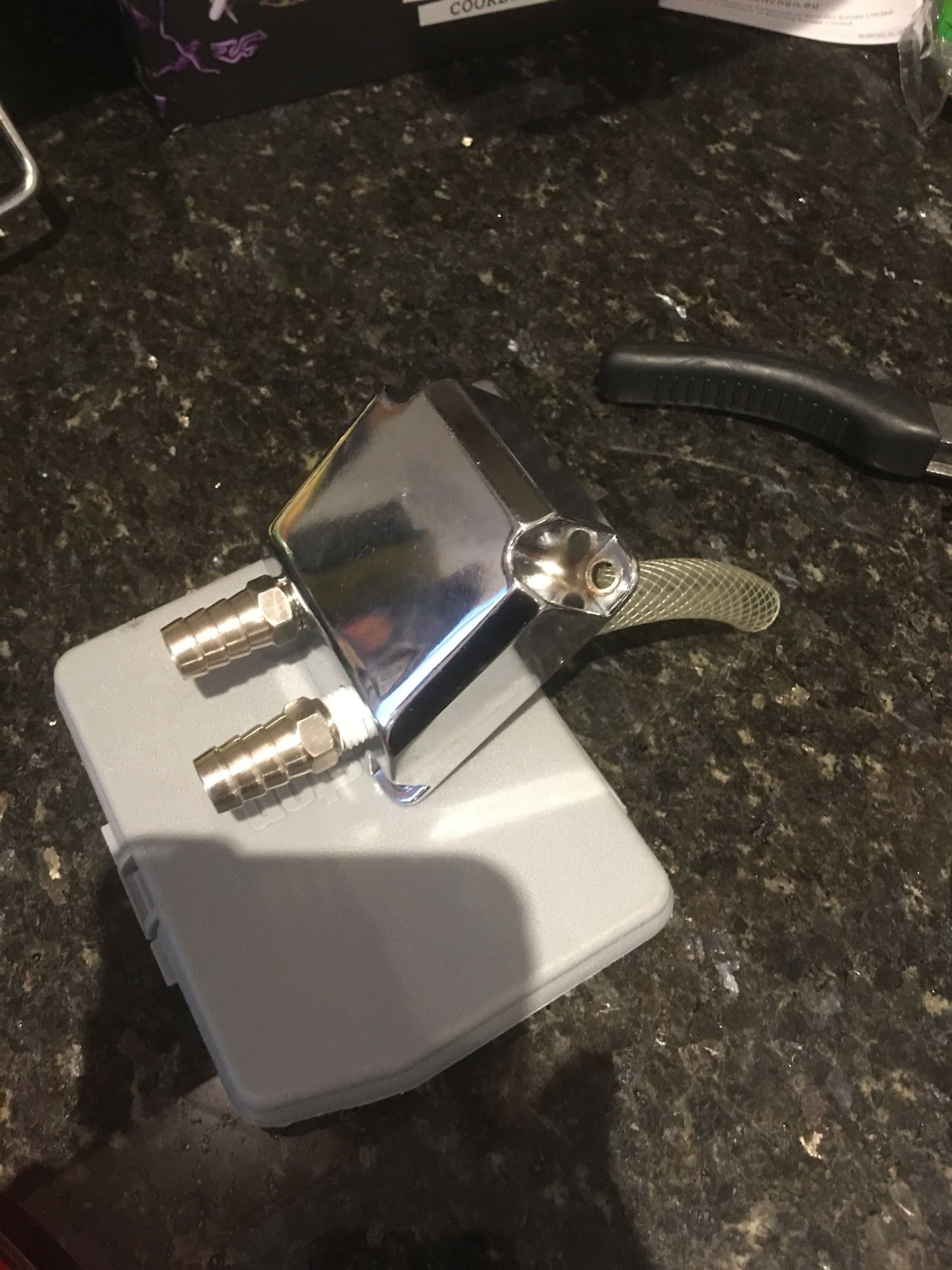

Most of the cheaper closed loop (not vented with a filter) oil catch containers need to be modded to separate the incoming oil vapor from the outgoing cleaned air. The more expensive oil catch containers already have a separation baffle to do this.
On my NRG container I had to add an internal barb fitting, a piece of 4"L x 1/2" ID hose for the inside, a scouring pad and a zip tie to create that separation. All together the cost was $38 which included the used NRG catch container off of eBay for $33.
I'll tear it down and take pictures of the innards once it starts collecting more oil.
Old pics...

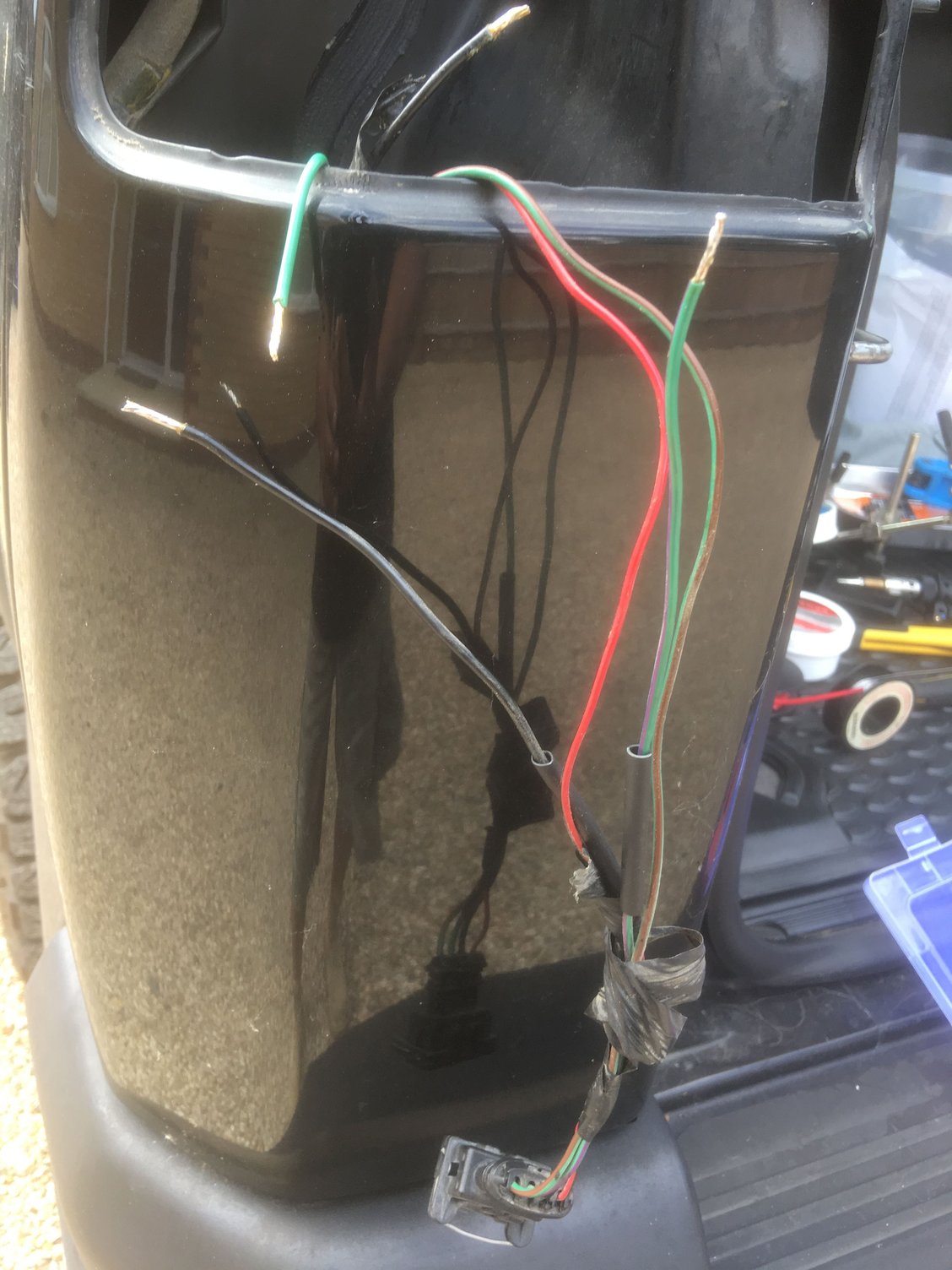

My cruise control hasn’t worked in 2 years since I added all LEDs to my brake lights. I finally fixed my cruise control problem today with a resistor.
Before I soldered in the resistor, my Nanocom showed the Hella CC unit senses the brake light is “ON” when driving over 28MPH. Since it shows as “ON” it’ll never enable the Cruise Control because it senses the brake is constantly on due to the brake light LEDs being installed.
I cut and soldered in a 50 Watt/6 Ohm resistor in parallel to the left rear brake light’s green/purple wire and the black ground wire.
I added adhesive lined 3:1 heat shrink tubing over the solder connections to protect the wires from shorting against the frame.
I then mounted the 50 Watt/6 Ohm resistor to metal to allow for heat transfer for the resistor to cool off.
Now..... my cruise control works!
