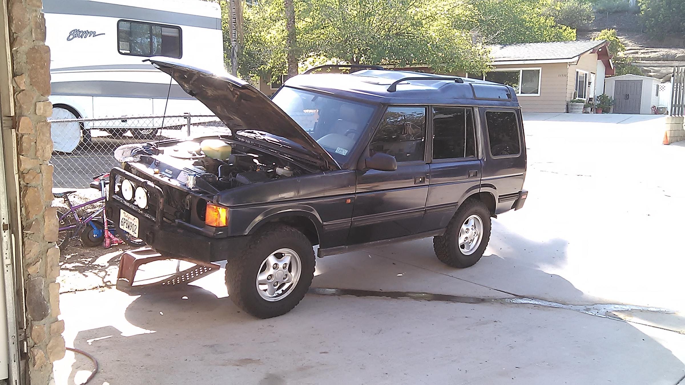

Here's a pic.
Attached Thumbnails My new Disco 1, hello from Socal-img_20141109_132311.jpg
