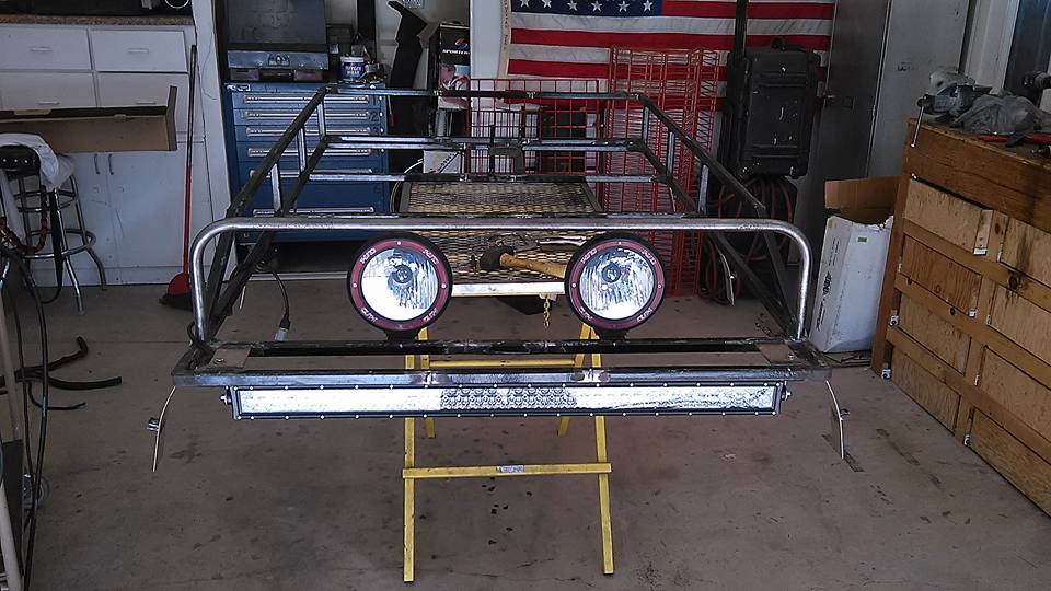

Almost done... Got all six edge bends exactly how I wanted them. I add gussets I areas I had to graft in. Gutter mounts are compete and I mocked it up yesterday. Looks bitchin! Didn't get much work done today but I'm on the home stretch. Light bar fabrication is next. More pics to come.

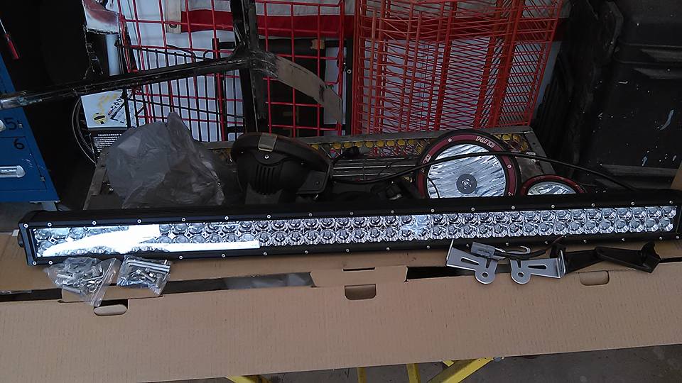

Mount tabs made and lights are mocked up! 40 inch dual row LED by oz-usa, 2x nine inch round HID's for the front and 2x four inch round HID's for the rear. Gonna be bright as hell!
Still gonna add a long section of flat stock that runs from the front gutter mount to the rear gutter mount. That will stiffen it up plenty and add more of a footprint. Also gonna add some steel cross bars and steel basket type material. She's getting a bit heavy (80lbs or so) but she's never been accused of being lite on her feet

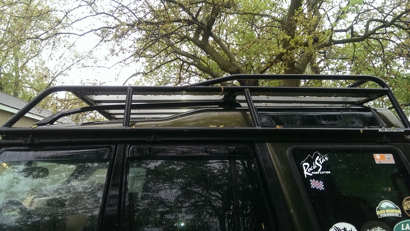

The flat stock in the rain gutter is a good idea, but you may find it kinda challenging. Brad at RockStar Fab made racks like this, that had a single "foot" running the length of the gutter. The issue was the slightly curved rain gutter made it difficult to run a single continuous piece of flat stock. He gave up building racks partly because of that. I have 1 of the 2, maybe 3 that he built.

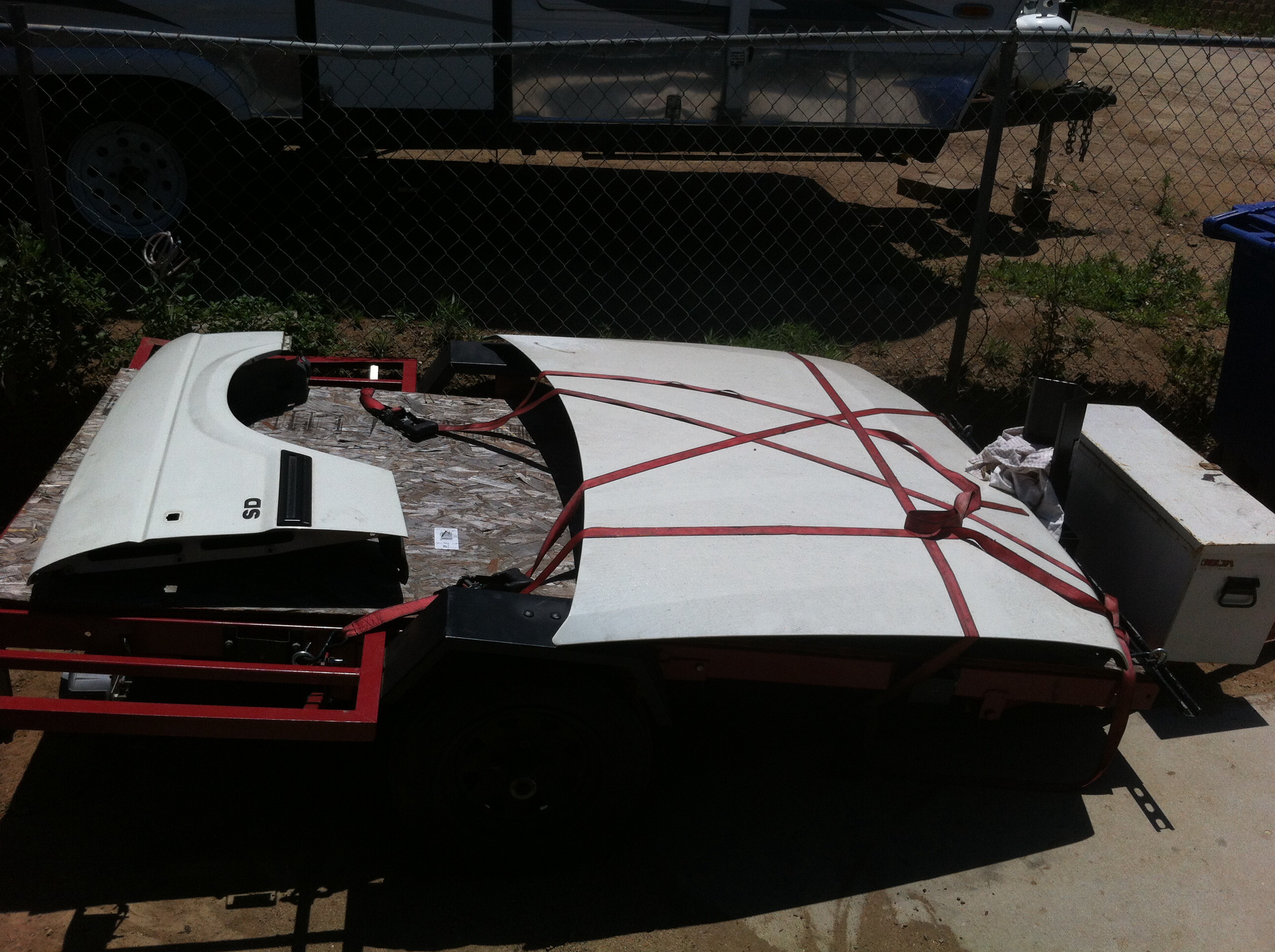

Here is a pic of New to me good and passenger fender I picked up this past weekend. She's getting a paint job soon and figured I'd swap these out before hand. I also scored (from a unknown source) a .50cal reticle that will be my hood ornament
