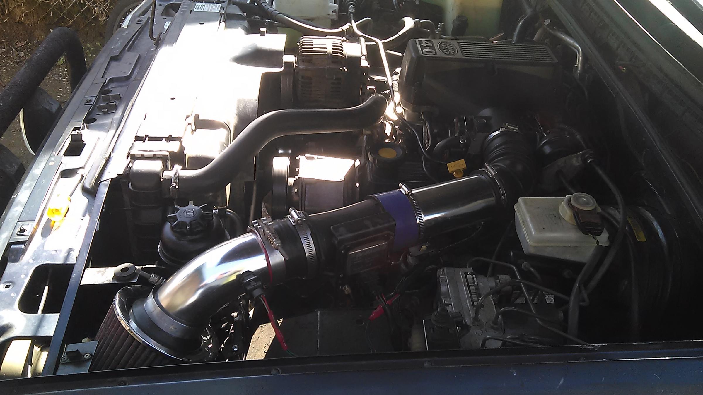

Picked up some tubing and couplers off a Ford turbo diesel junker at my local junk yard. Made brackets for mid support and support by the filter. The filter is a Craigslist special I got for $5, tubing and couplers were $8. Had to cut and extend the AIT & MAF sensor harnesses so it could sit in the little cubby that acts as a box/shield. I like how it came out. Also did exhaust (no pics of exhaust yet). Throttle response is very noticeable and engine sounds better.

Looks clean just don't go swimming

Lol. Yeah don't plan on it ever. Maybe tire high water at the most.

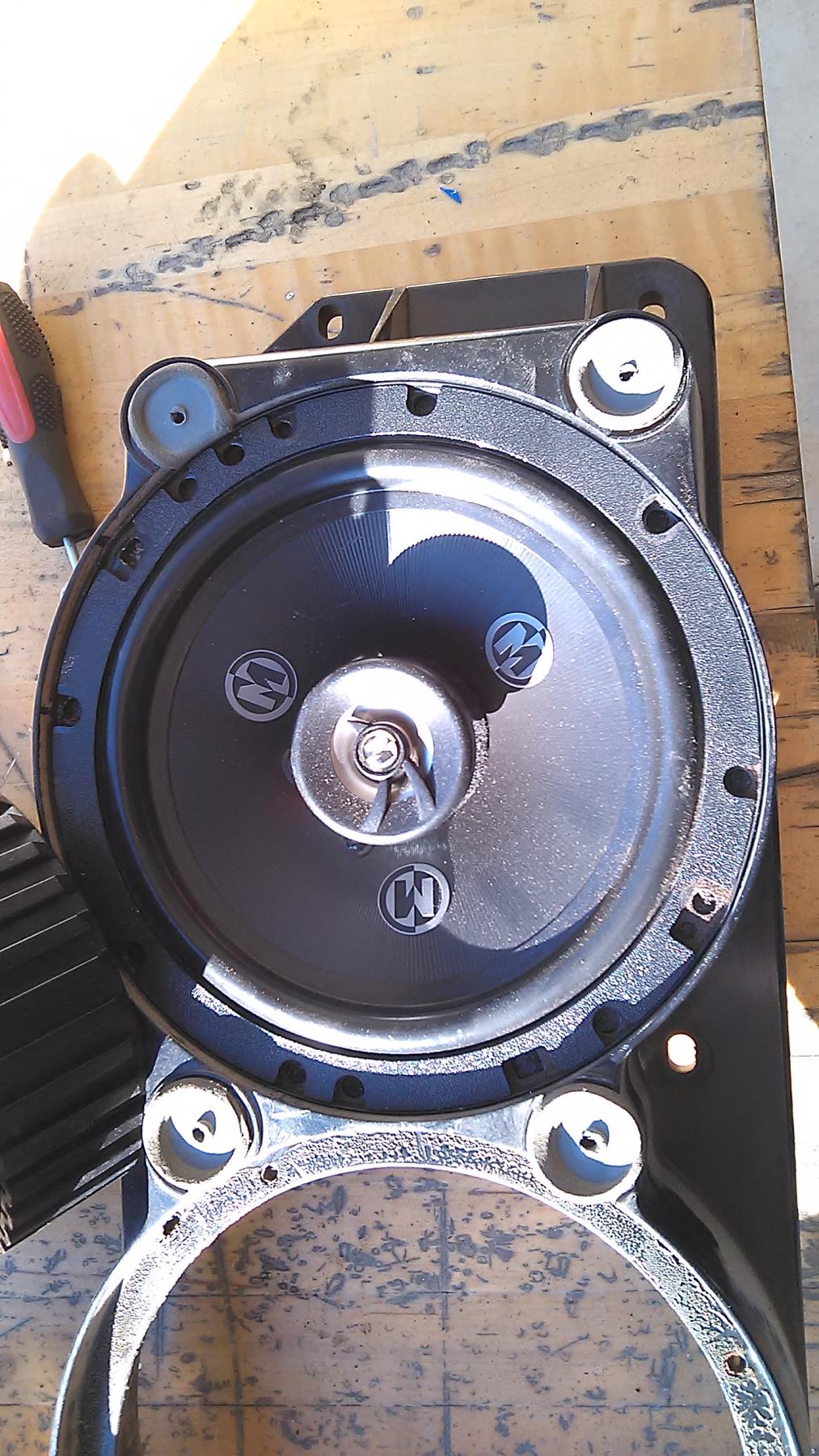

Took stereo and cd changer apart today. Changer now works! So do my front driver side speakers! Rear hatch were blown out.. Foam was rotted all the way off. Replaced with Memphis audio 6.5's (took off the tweeters). System sounds good! I think I'm going to end up keeping the stock stereo installed and tap into the changer to add a Aux port. I like having the functional driver controls. Lol.

She looks good USNAVY. Looks almost identical to mine. My subs are also in need of foaming but I plan to save the originals. Great job!

yeah for me the factory stuff is fine if you just put some cheap aftermarket speakers in that don't overpower the amp

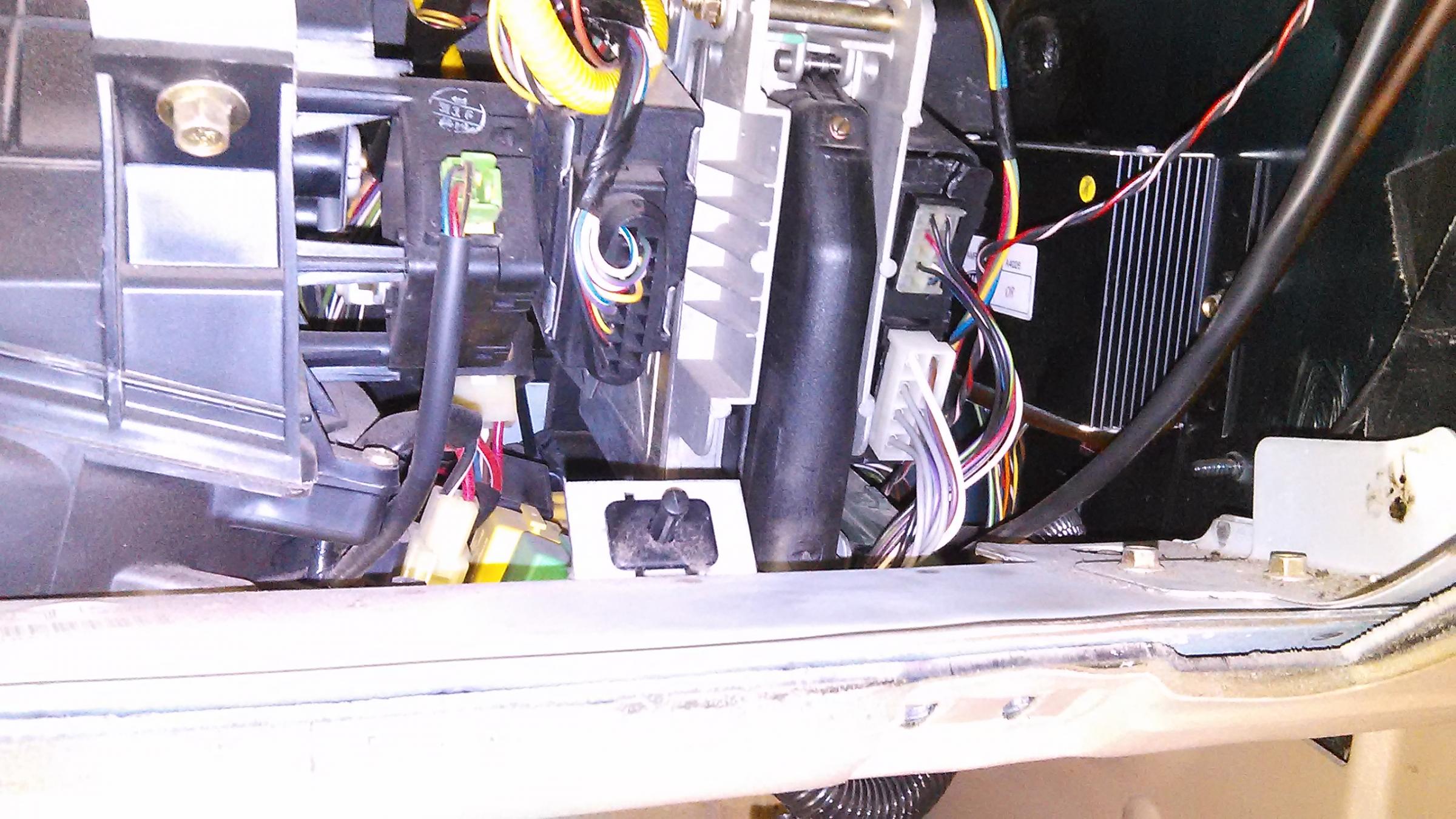

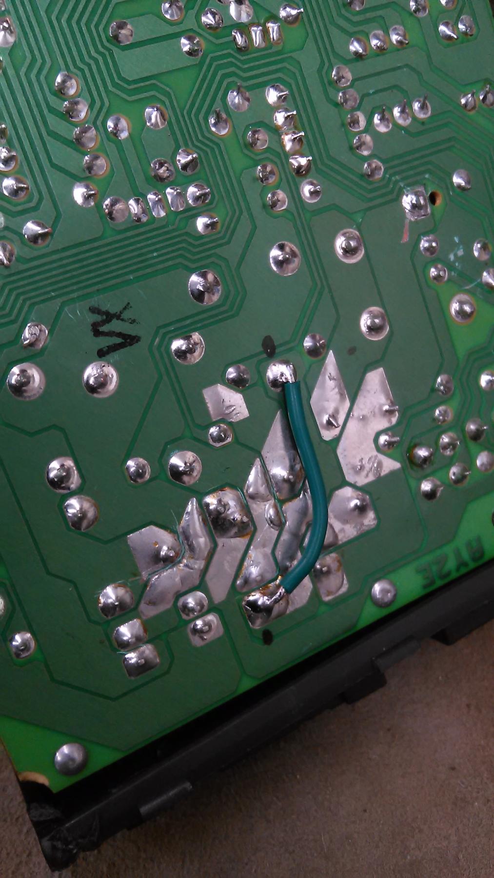

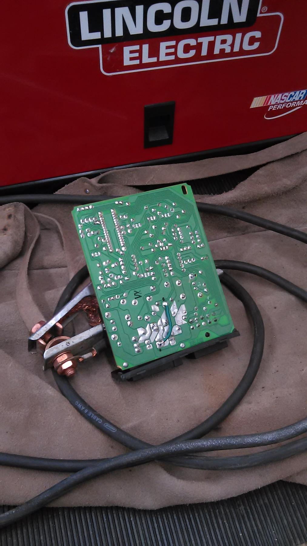

Fixed the back window ecu. Easy peezy.. Work beautifully now. Cleaned switches up really good too. Followed this link :
Repairing the Window Lift ECU - How To

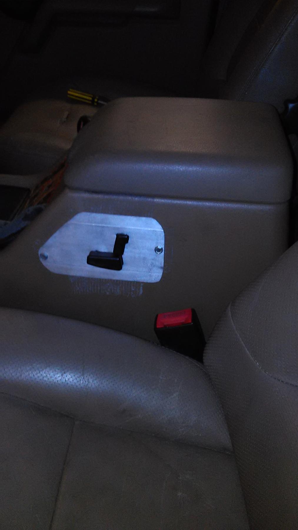

Made a power seat switch backplate out of some scrap sheet aluminum that I brushed up. I cut it a 1/2in bigger than the plastic shyt and secured it with self tapping bolts. Still need to clean tape residue from console that PO did. What a phucktard...
