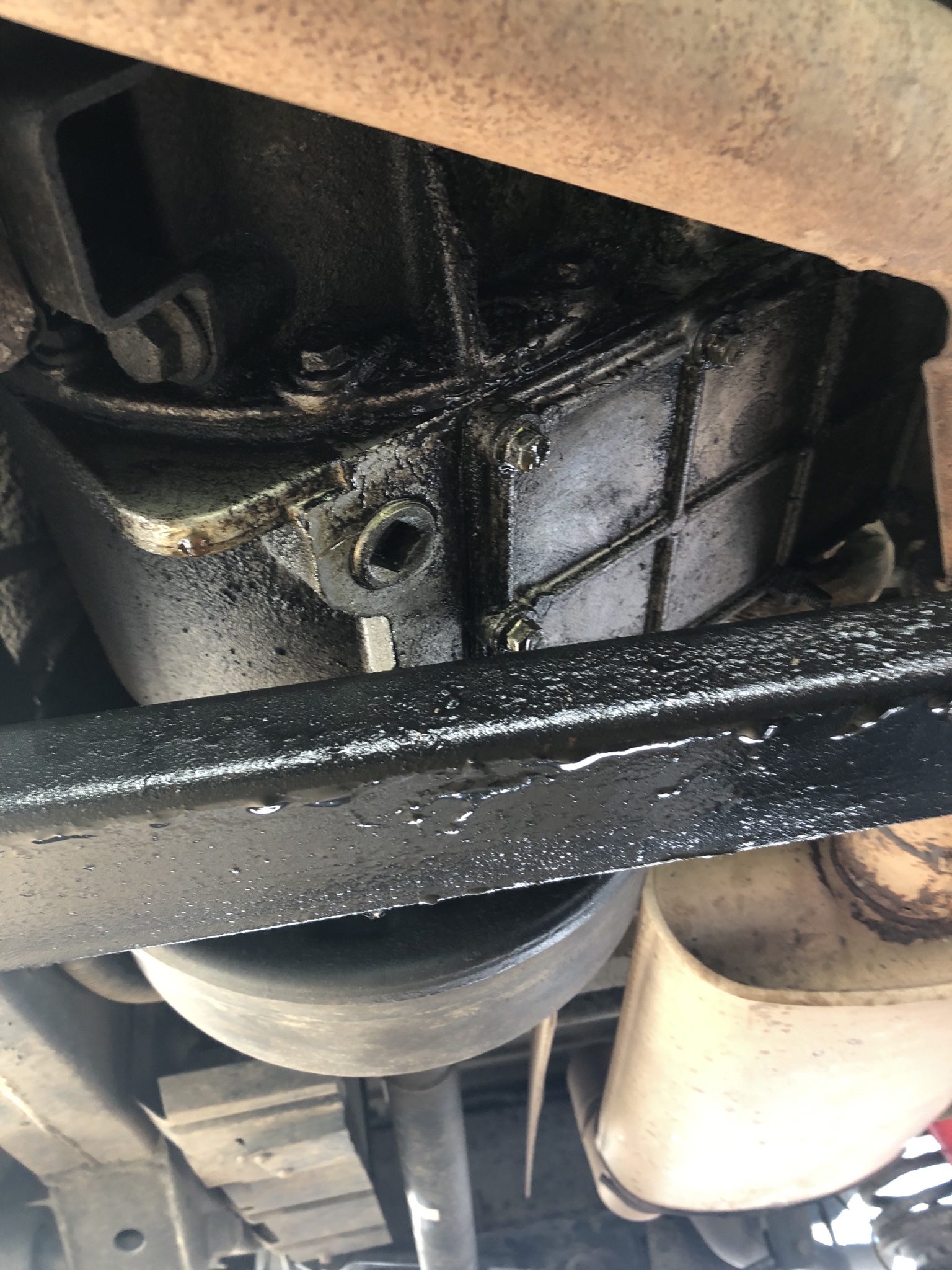

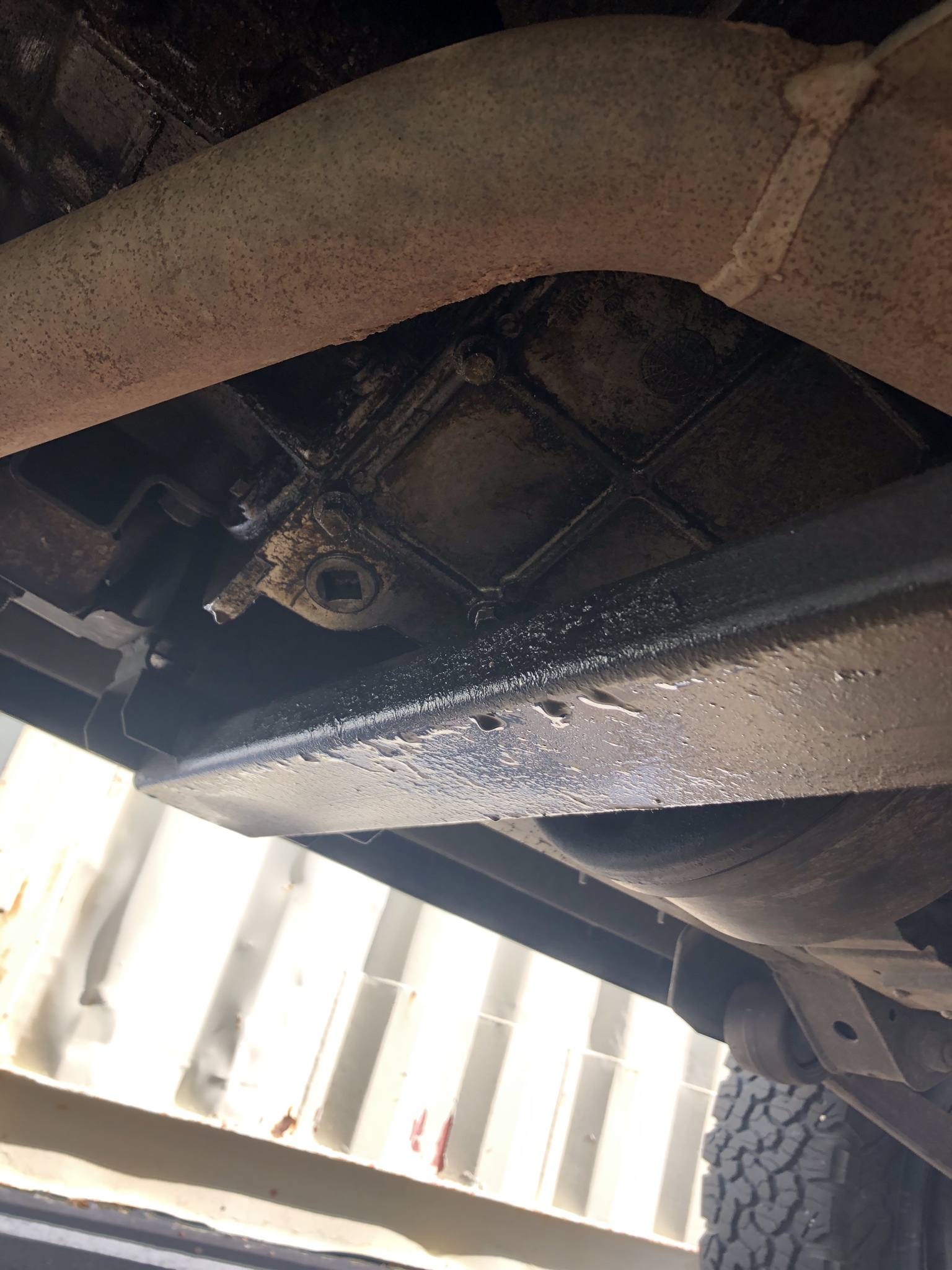

Hmm.. Crawled under the truck to check on something -- the t-case defo has a leak of some kind. I had wiped down the cross member right under it and there is fluid on it again.
This was "pre" wipe down of cross member
It looks like to me that this plate (?) is the culprit -- i believe the gasket is a liquid one since i can sorta peel the squeeze out off the sides of the joint
