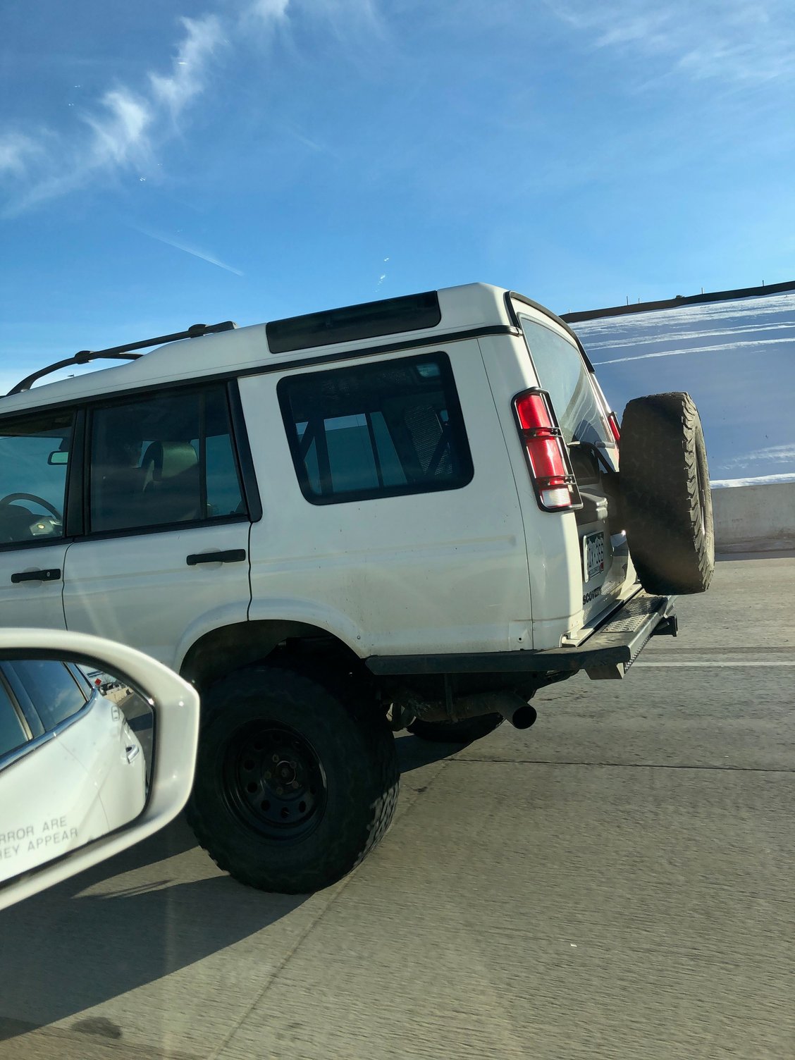

My friend was going down the highway and spotted what I believe is you! He said “just spotted a sick disco” looks sick!

Haha -- Yep, that's MagPie!

looks great! Do you ever go to cars and coffee events? I would love to see your truck in person!
