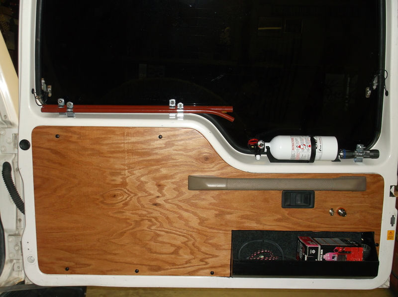

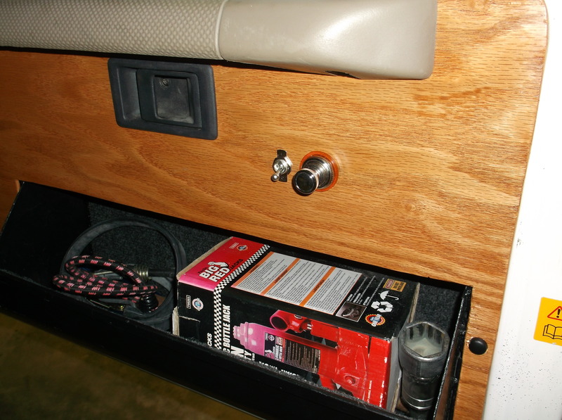

So, while I need to address the skid still......I've had multiple objectives taking up space in the shop.....and since steel and wood don't mix well, need to loooooooooose the wood!!!!
Rear door panel DONE and out of my way!
Not the greatest pic......but time to move on.......Done, out of the way, incorporated another 12volt power source, switch activated....all and all, cheap and nice.......I might incorporate some vertical wear strips to keep it clean down the road....but over all, very happy it's DONE!!!!!

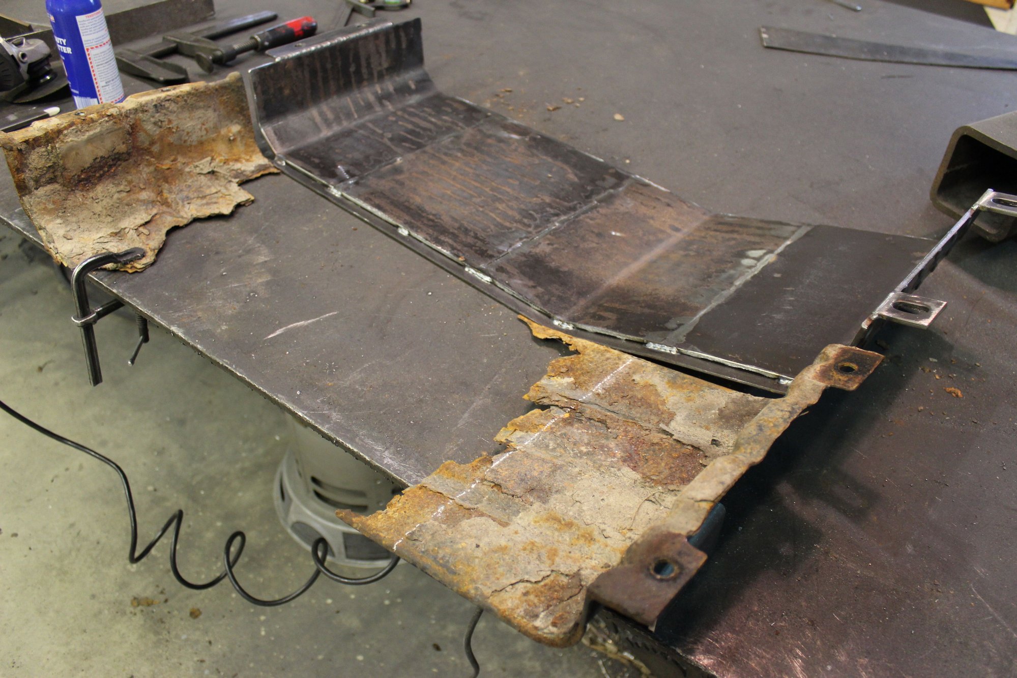

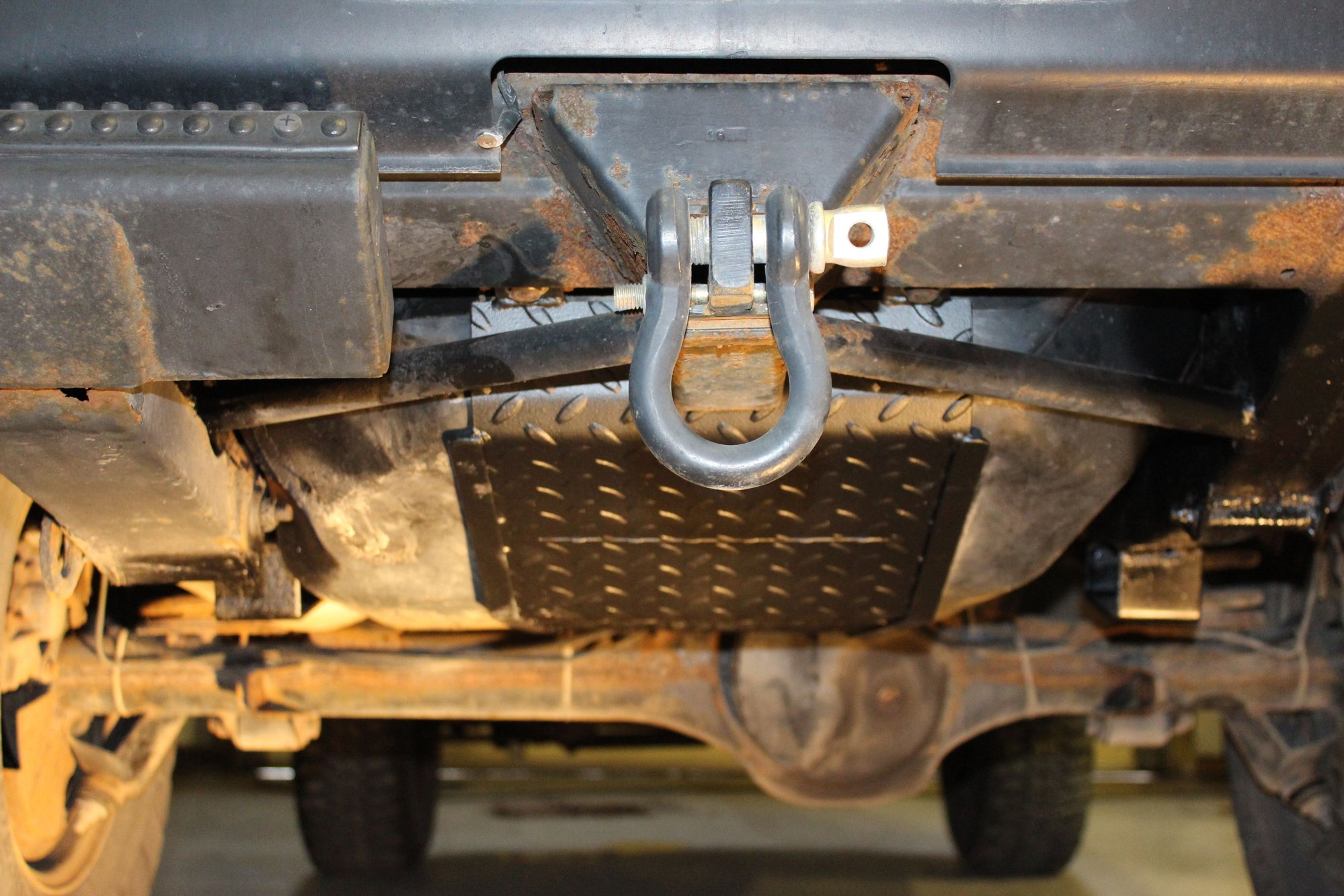

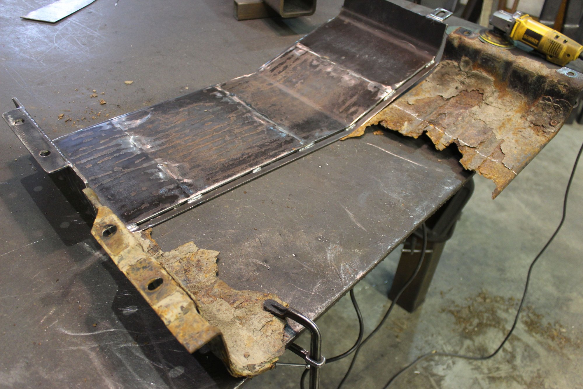

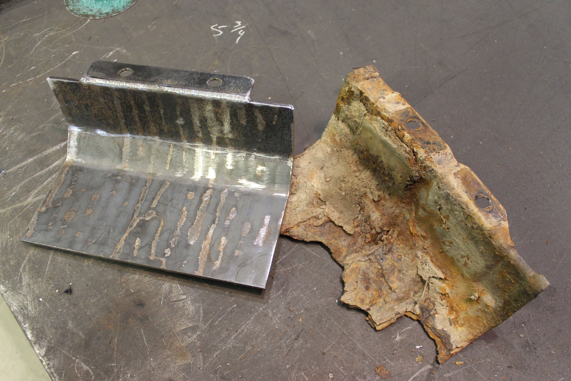

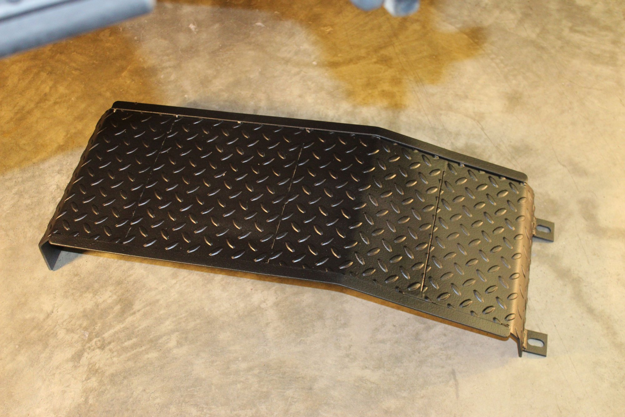

Well.....Gas tank retention/skittish skid is now complete......I didn't have a whole bunch to work with.....but the ends were still there..lol..
Found myself having to build it in sections, but that's okay, I beveled the back side and made it happen......found some 3/16" D Plate off in the corner I forgot about....about an hour and 45 later.....it was done. Finished pic's tomorrow once everything dries.....

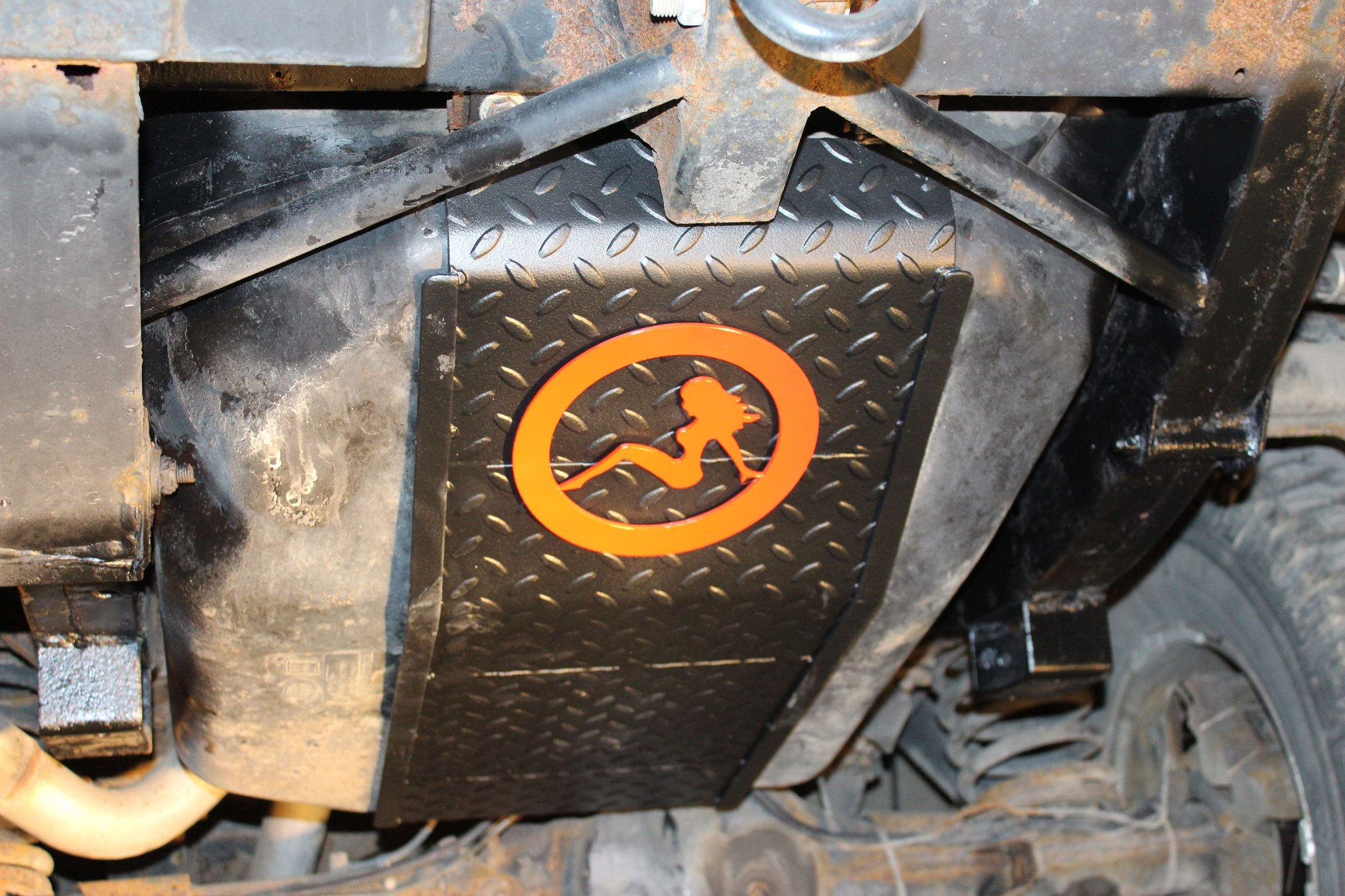

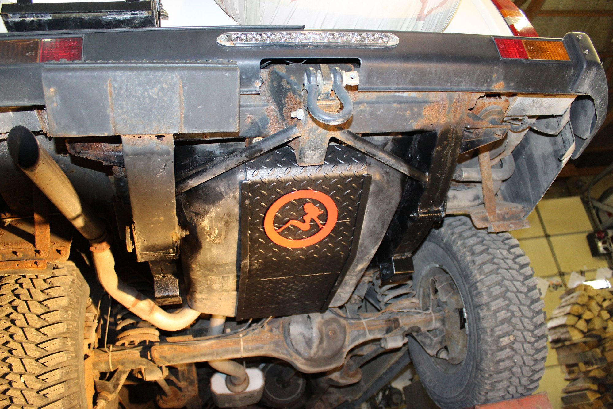

All righty......With the bed liner cured over night, time to move on......
Reinstall went real well, no issues....removed the rear sway bar while I was under there....don't think it was worth much any way due to the worn out bushings....
Not being able to leave well enough alone last night, I simply couldn't leave all that bare steel alone........so, in case I ever get to break a crest with Doug as my spotter, I figured I'd give him something to snicker about.......
lol......I give you, Mud Flap Girl....
