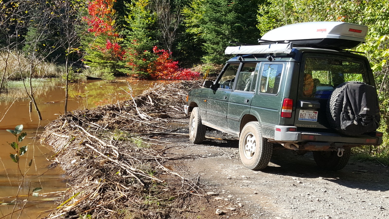

You can do a 1.5 - 2" lift and still run sways without any real problem. My '96 in on about a 1.5" Old Man Emu lift and 235/86/16 tires. I just installed new polyurethane swaybar bushings. If you're doing mild trails and forest/fire roads you'll be fine running sways with a lift.
