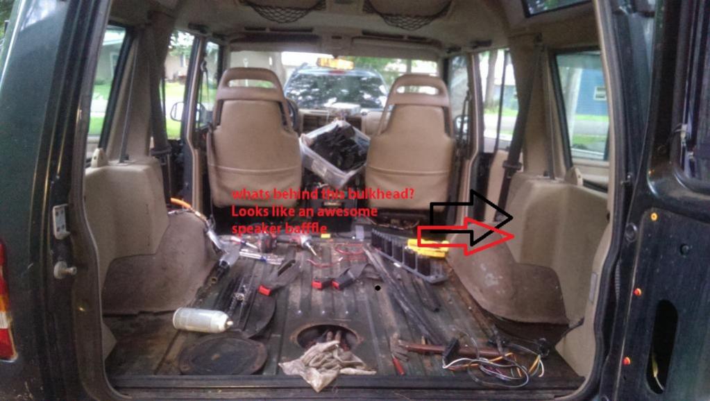

Pulled the rear seats and carpeting out tonight. When you get right down to it there's not a whole lot to these trucks.
Look at all that room!!!
After seeing this pic, I'm taking my back seats out. I use this as a truck anyway.
Old Jul 21, 2014 | 06:48 PM
  #30
HammerFit's Avatar
Joined: Apr 2013
Posts: 257
whats behind this thing?
