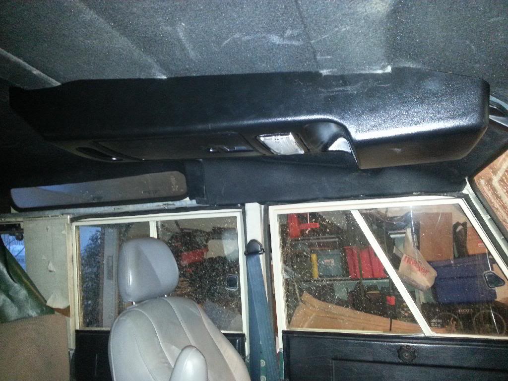

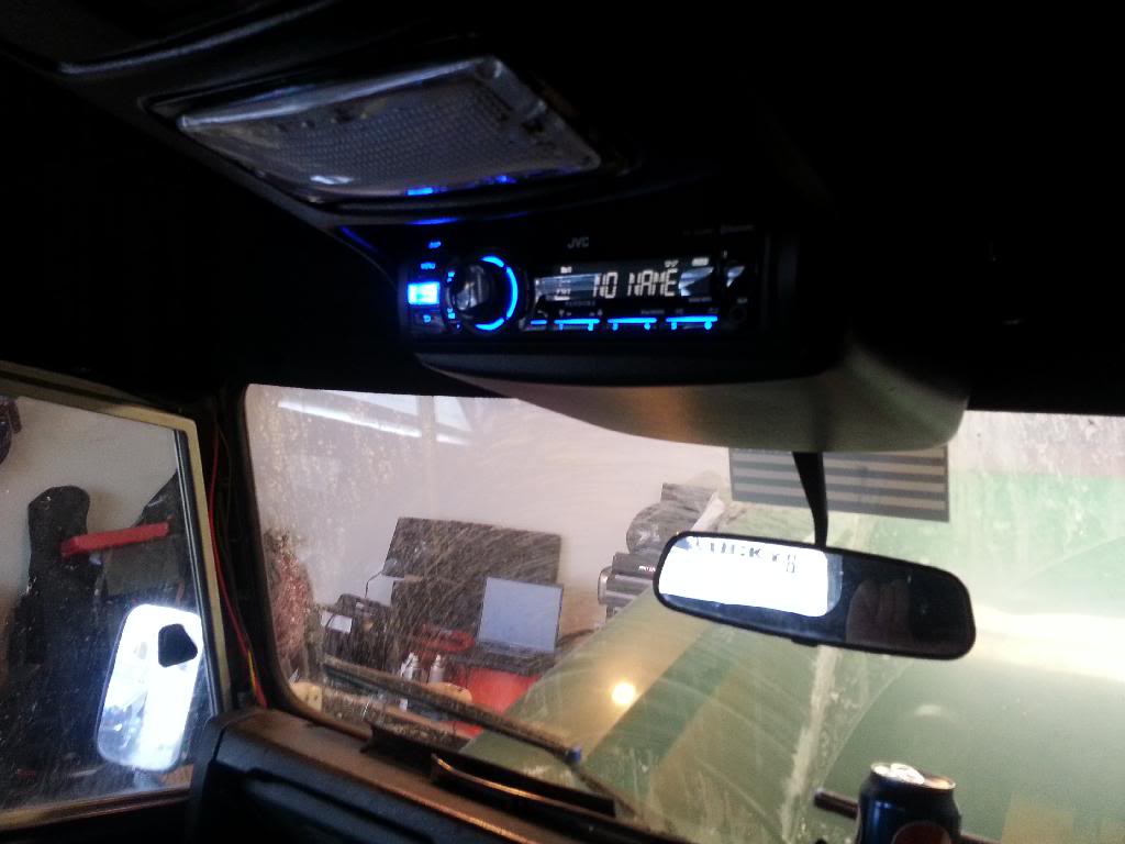

Got my over head terrafirma console installed and finally a radio. Unfortunately I noticed that the water pump is leaking coolant....
