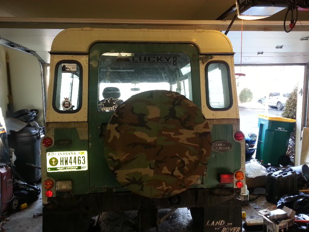

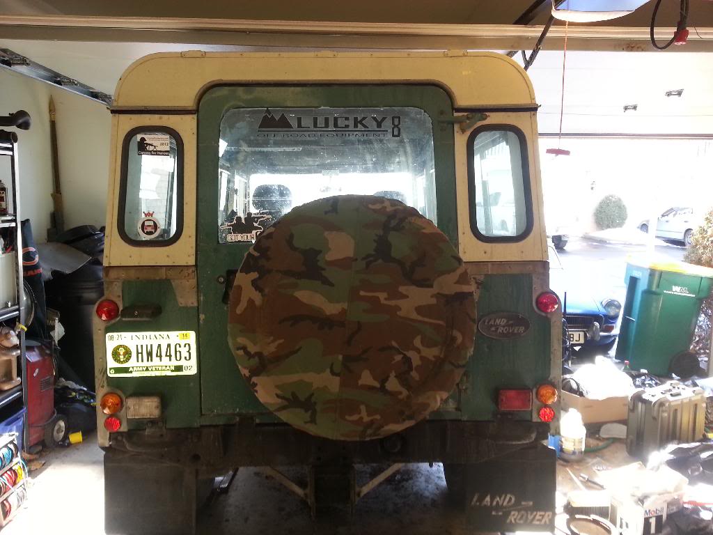

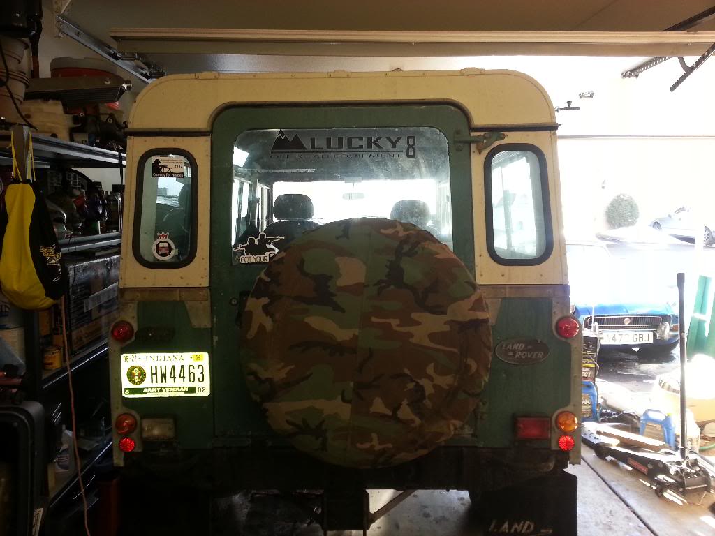

Got the suspension done.
It was a tight fit backing her into the garage.
One side done. The fit was looking a little to tight for my liking. I had my wife come out before I moved it around to get to the other side to watch and make sure I didn't rip the garage door down.
And both sides done.
It raised the rear end about 2" that wouldn't be surprising except I put on stock springs..

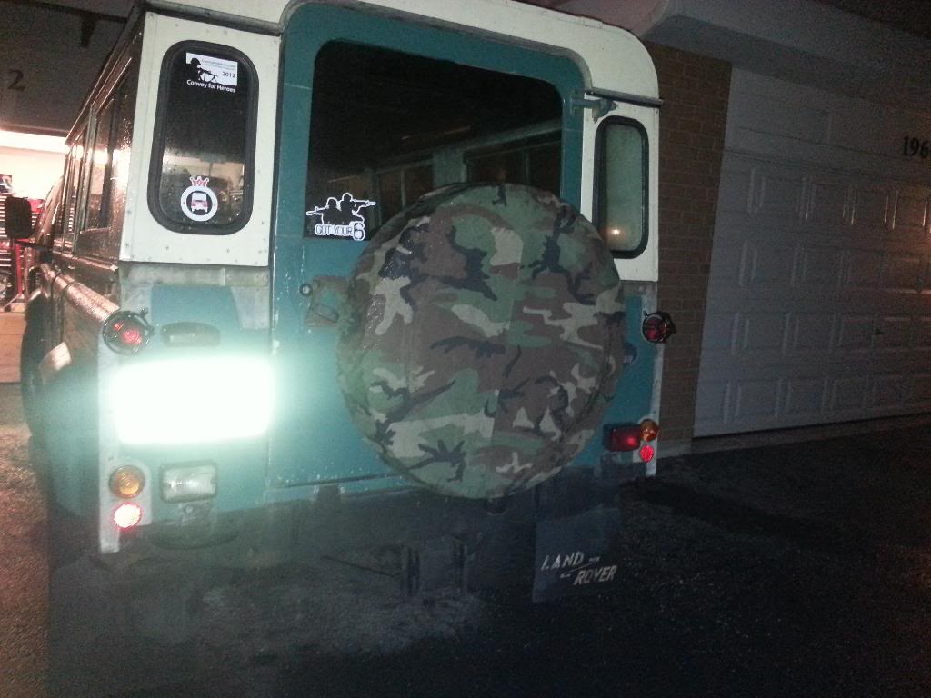

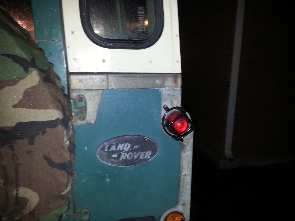

It was freaking cold out so I cleaned a bit around the garage and watched football. Found a pair of tail light guards I had picked up used about a year ago laying on the shelf so I went outside and installed them real quick. Everytime I look at the back of the 110 I want to find one of the series Land Rover emblems that are metal and say 4wd station wagon. Just always seem to miss out on them.

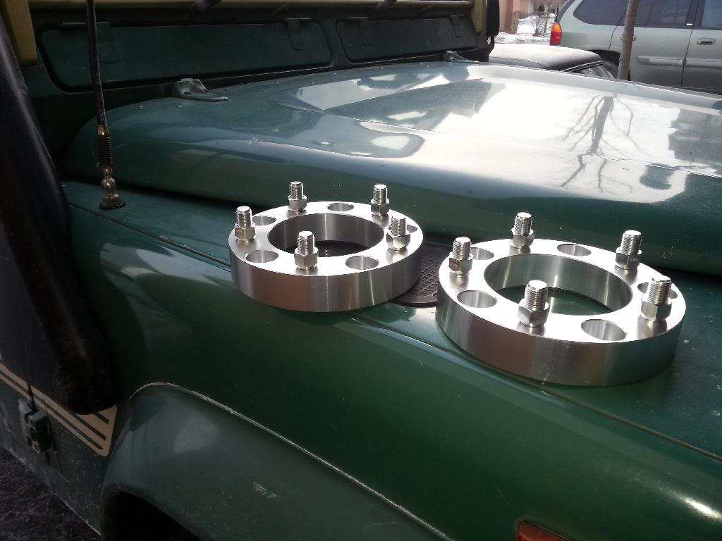

My wheel spacers should be here tomorrow, so I can get those on and be able to run center caps on my rims and have full lock to lock steering back. Tires are rubbing on the radius arms now.
Pic of the light guard installed.
Crappy night cell phone pics I know....

So my front wheel spacers showed up today, so out into the 7 degree afternoon I went and installed them. The 110 definitely has a wider more aggressive looking stance with the spacers.
I tried to take pics but it was getting dark and my phone said it was to cold for the flash to work...
So you just get pics of the spacers.
and my ice tea that was out there with me, for 45 minutes....
