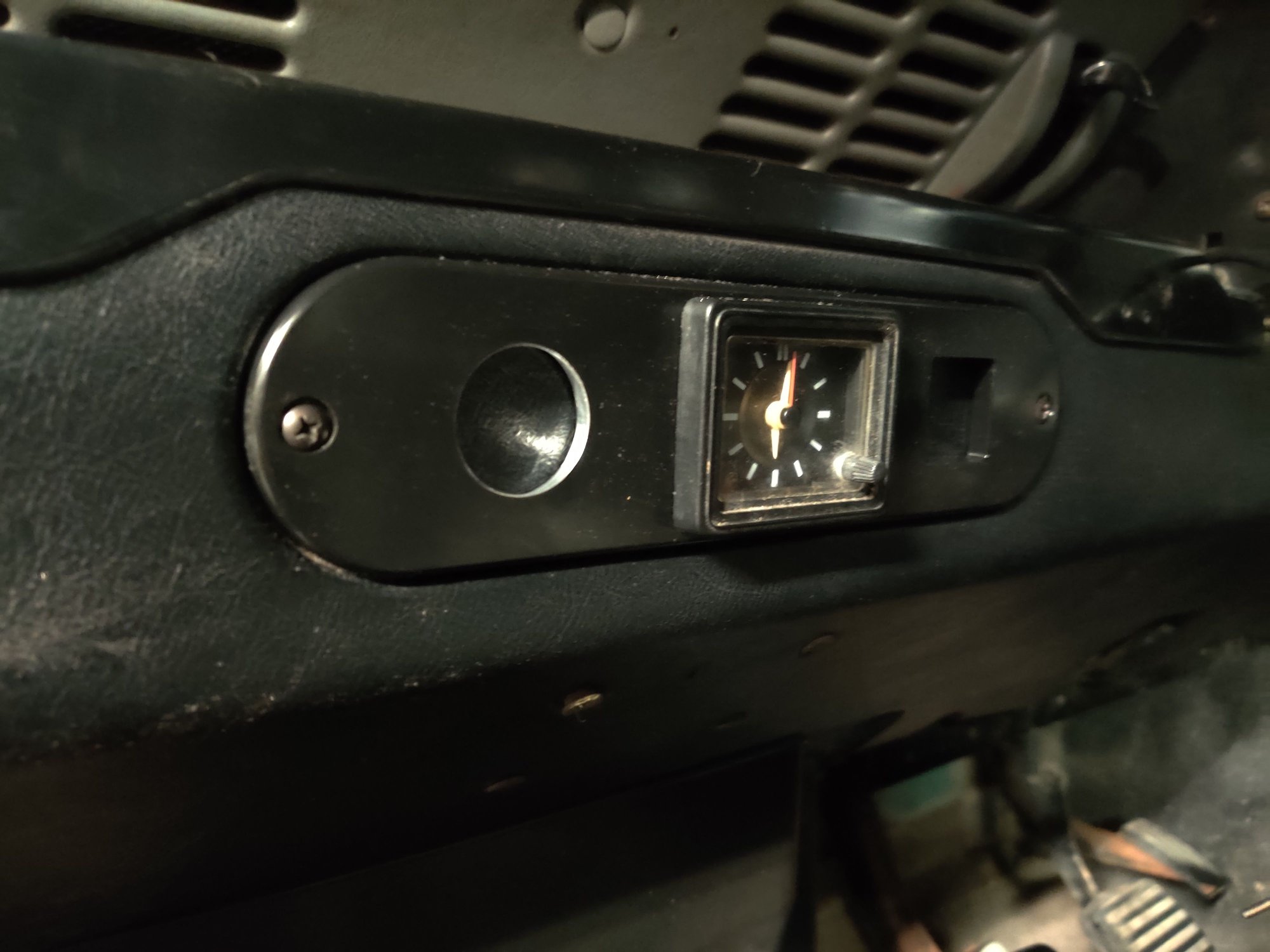

Got a few minutes to work tonight. So square clock meet round hole.

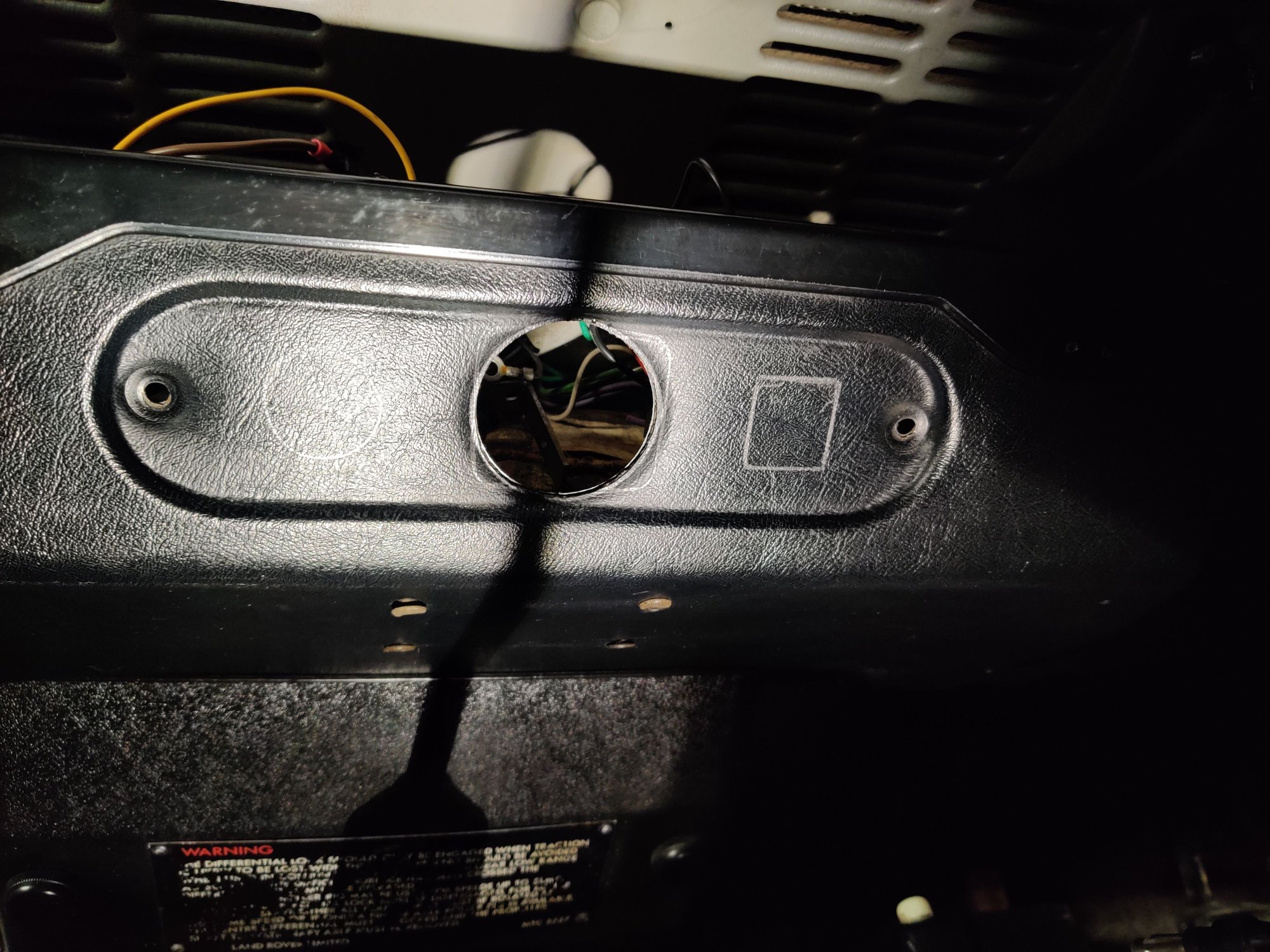

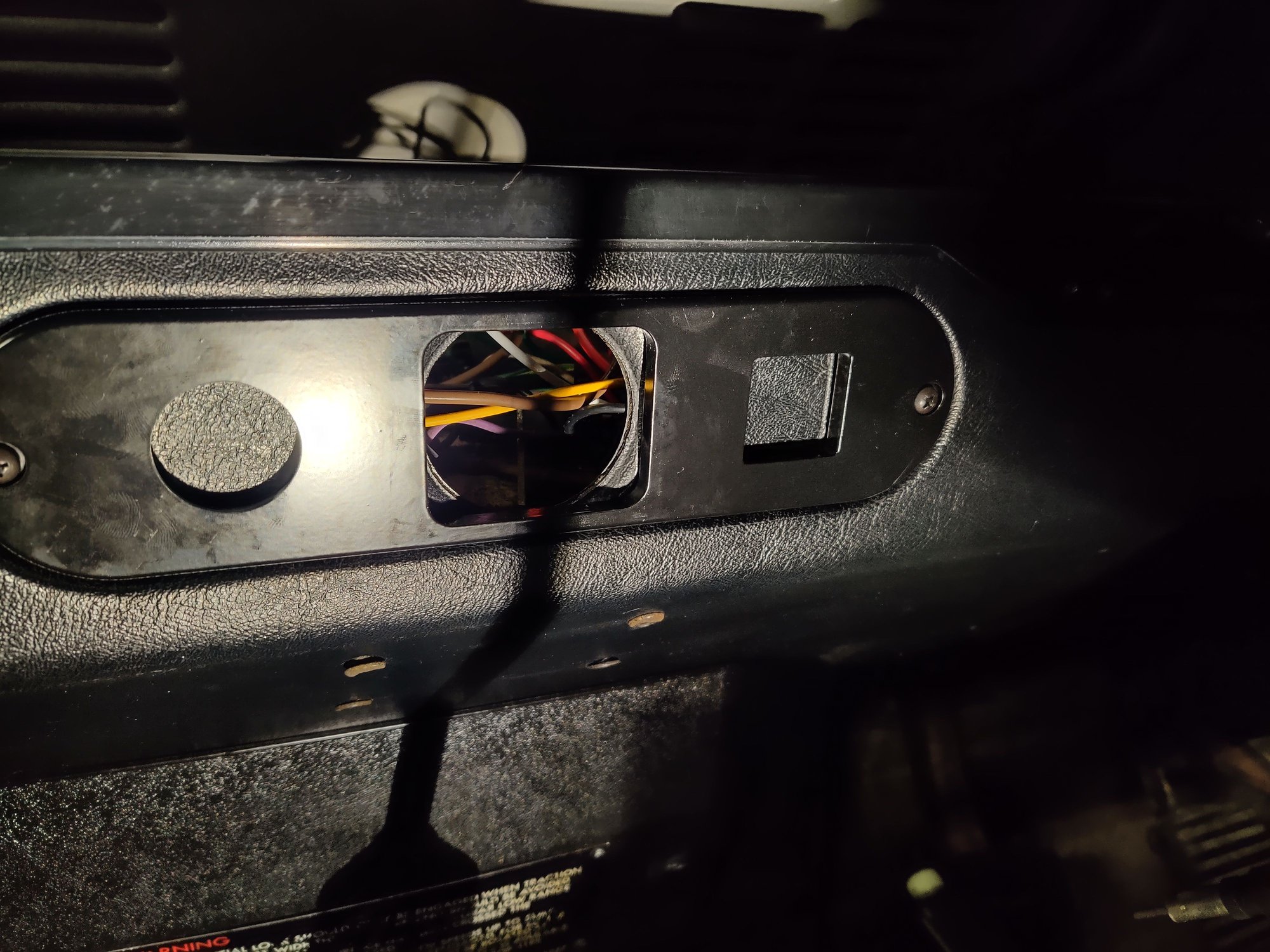

Well since I had that awesome spot for a cigarette lighter in the dash now. I went ahead a made.the hole in the dash for it. Since I don't smoke I installed a USB dual port in its place

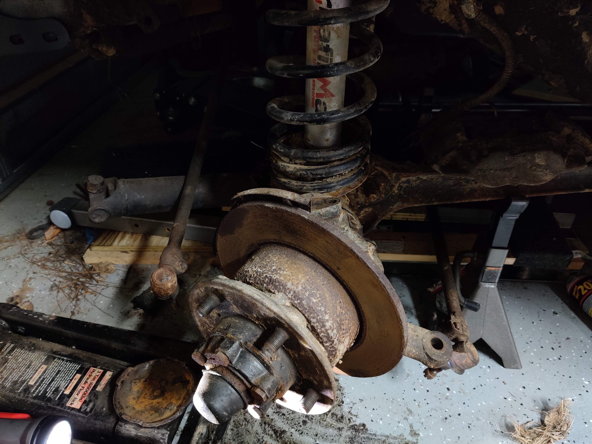

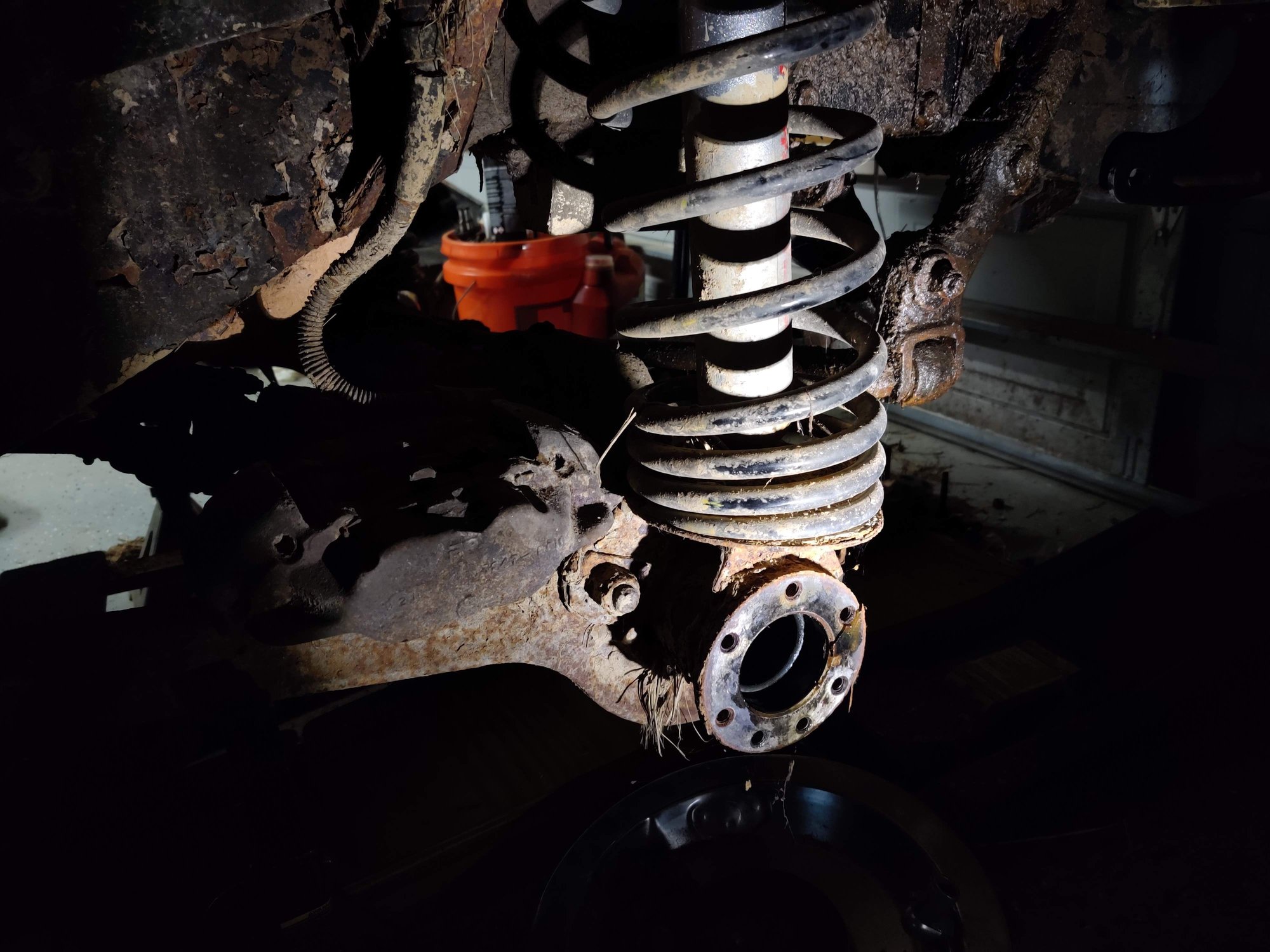

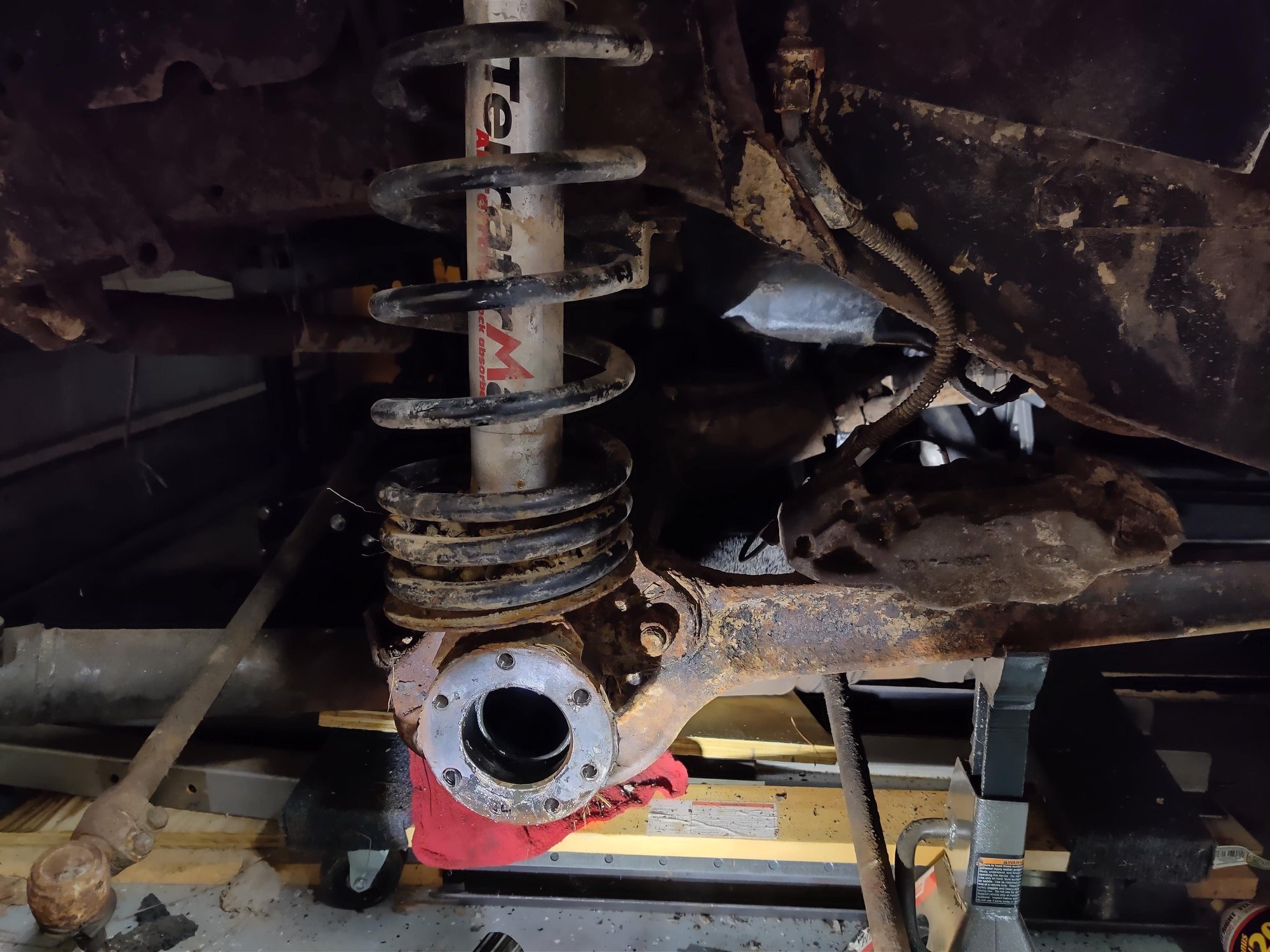

Took a break from the honey do list and got in gear in the garage.
Pulled both the long side and short side axles out of the front along with the differential.
Entire assemblies out.

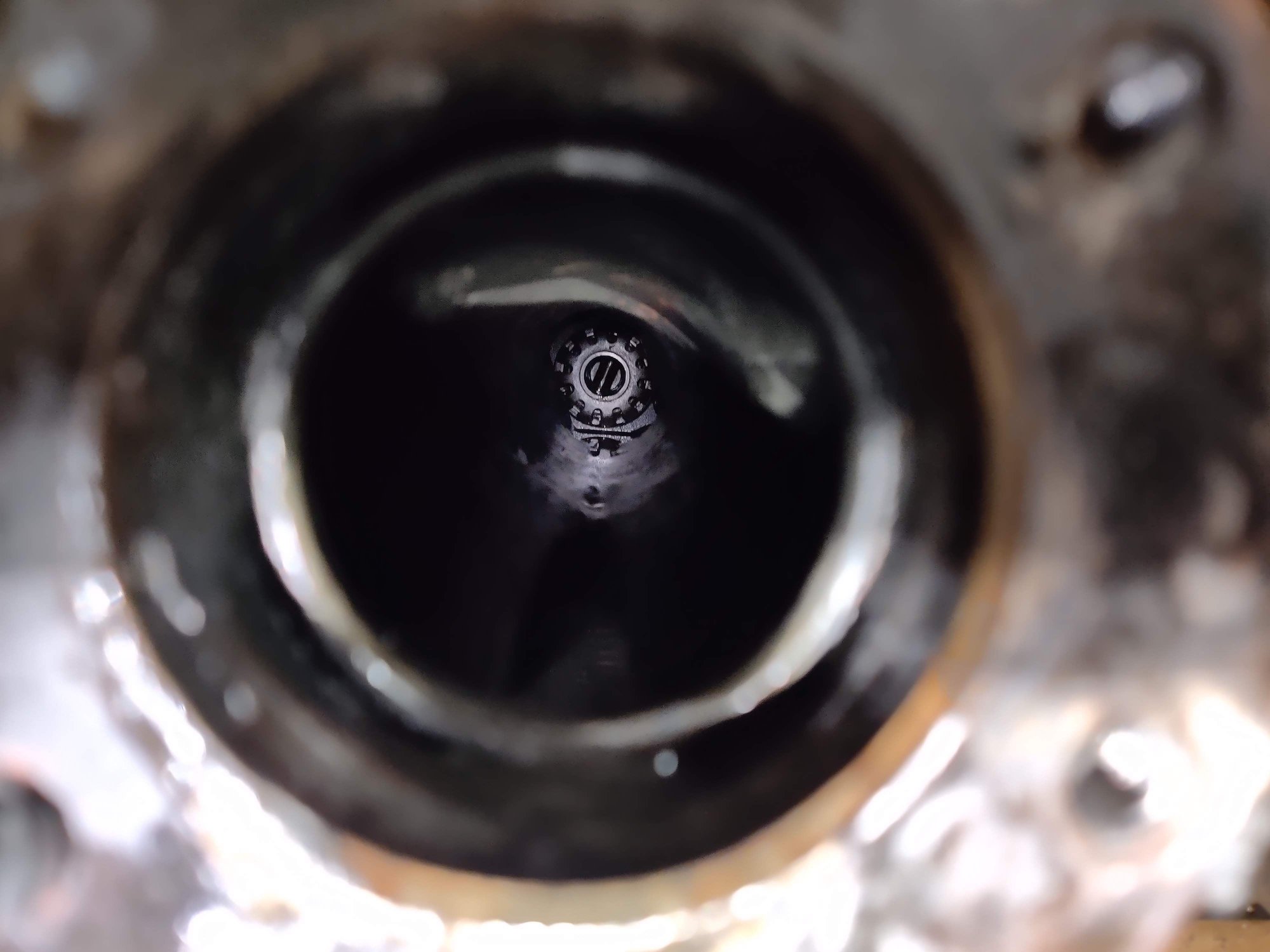

I see you lurking in there...

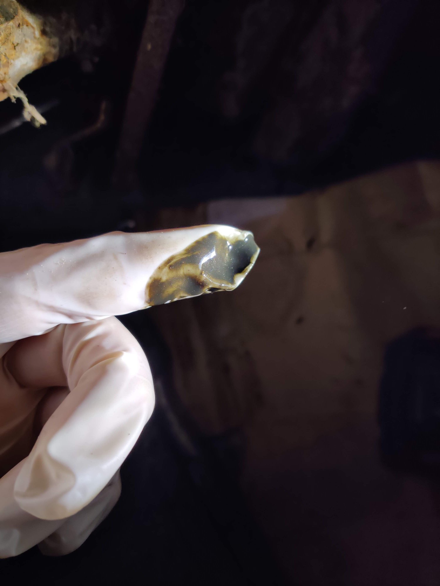

I think this confirms my suspicion that there was some damage in the right front swivel.
Hard to get the picture of it but there was a good metal flake glitter in the gear oil.
That was it for today.

A small amount of metal flake, towards the end of draining axle...would be somewhat normal. Usually, you'll get a small area in the pan...just as it finishes empting. If it's never been changed before, a lot of that material will be from original manufactoring and break-in of gear set. Were you getting any strange noises from the diff?

I'm replacing it so no matter either way. Full 24 spline set up going in..
There was a fair amount of metal in all the fluid from the swivel housing. I am hoping it is destroyed inside as it would be the smoking gun I’m looking for on a wheel bind and lock episode I had. Also would be the cheapest and easiest to fix so I’m sure it’s not it.
