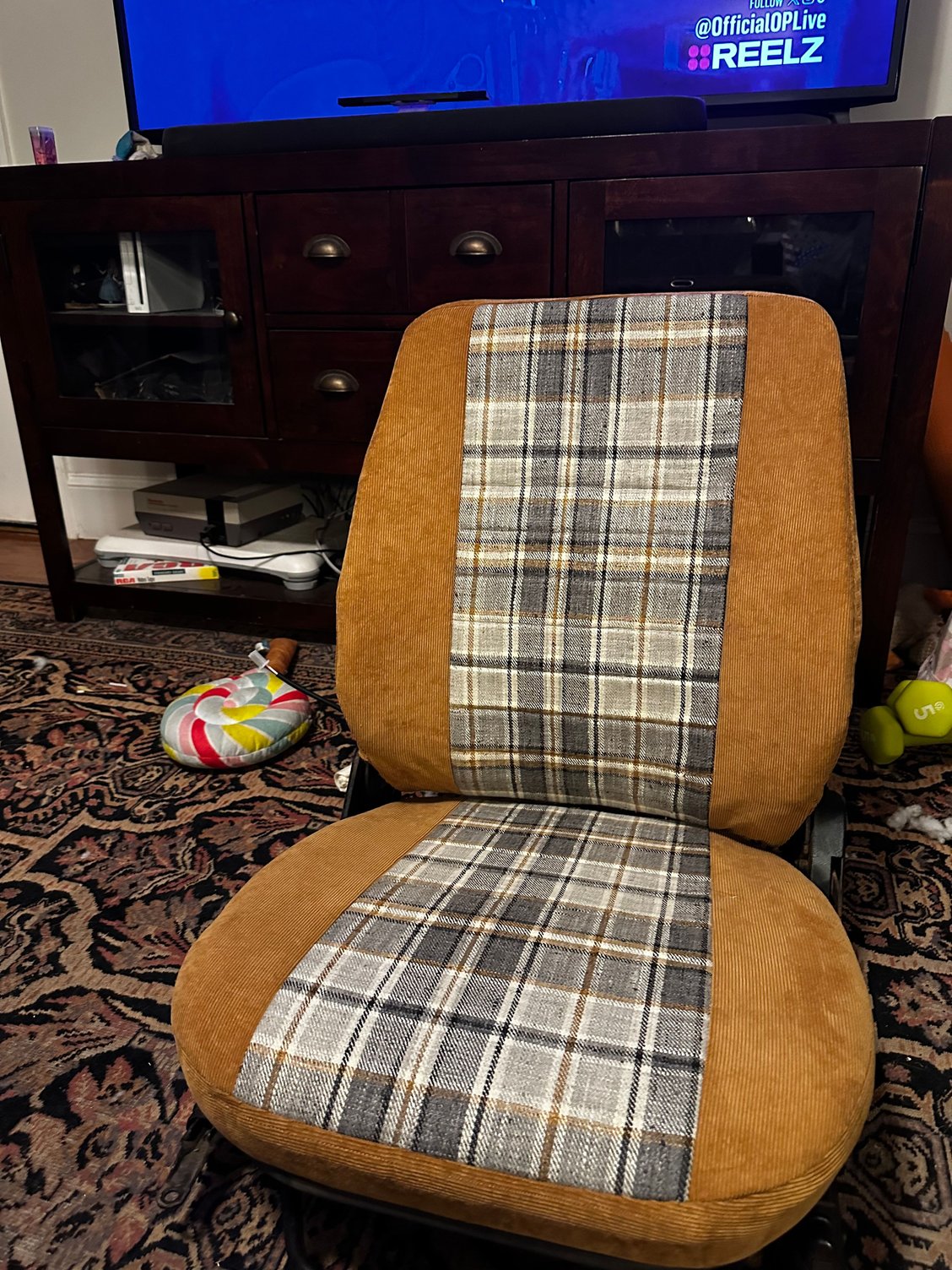

I run out of meth to quick to keep that pace up🤣. It’s exciting though seeing it come back together. Yesterday had me super excited so I had to celebrate properly
the seat is a bit of a sneak peek Mrs ArmyRover isn’t quite done yet with them but I am beyond happy with her first attempt at doing upholstery

Funny you should mention seats. #7 on my list of things learned was going to be...there is no lumbar support, at all, in the front seats! 5 hours in the saddle made for a pretty unpleasant ride. Going to check right now what is available for this. Then, back to work on Victoria.

we replaced the lower and reshaped the uppers a bit with more in the lower back. We added seat heaters as well
