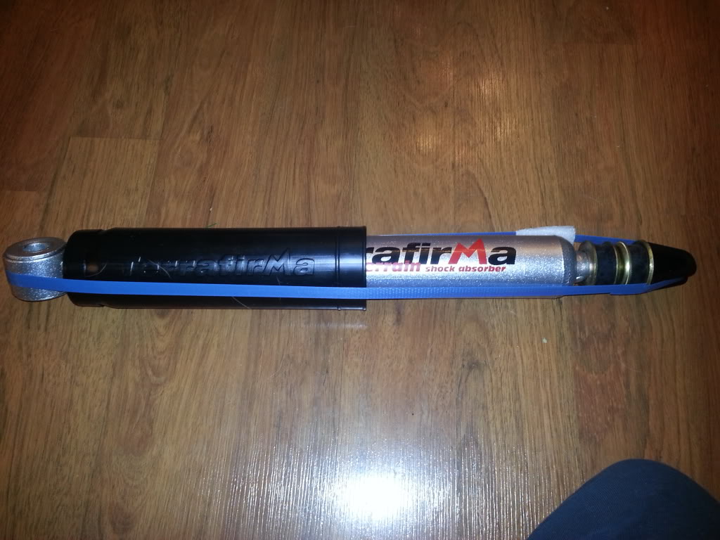

And here are the stars of the show..
A full set of the new TerraFirma All-Terrain shocks, also a new set of TerraFirma front turret rings to go with the Land Rover HD springs at all 4 corners.

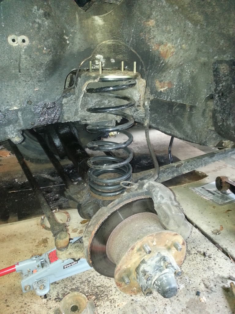

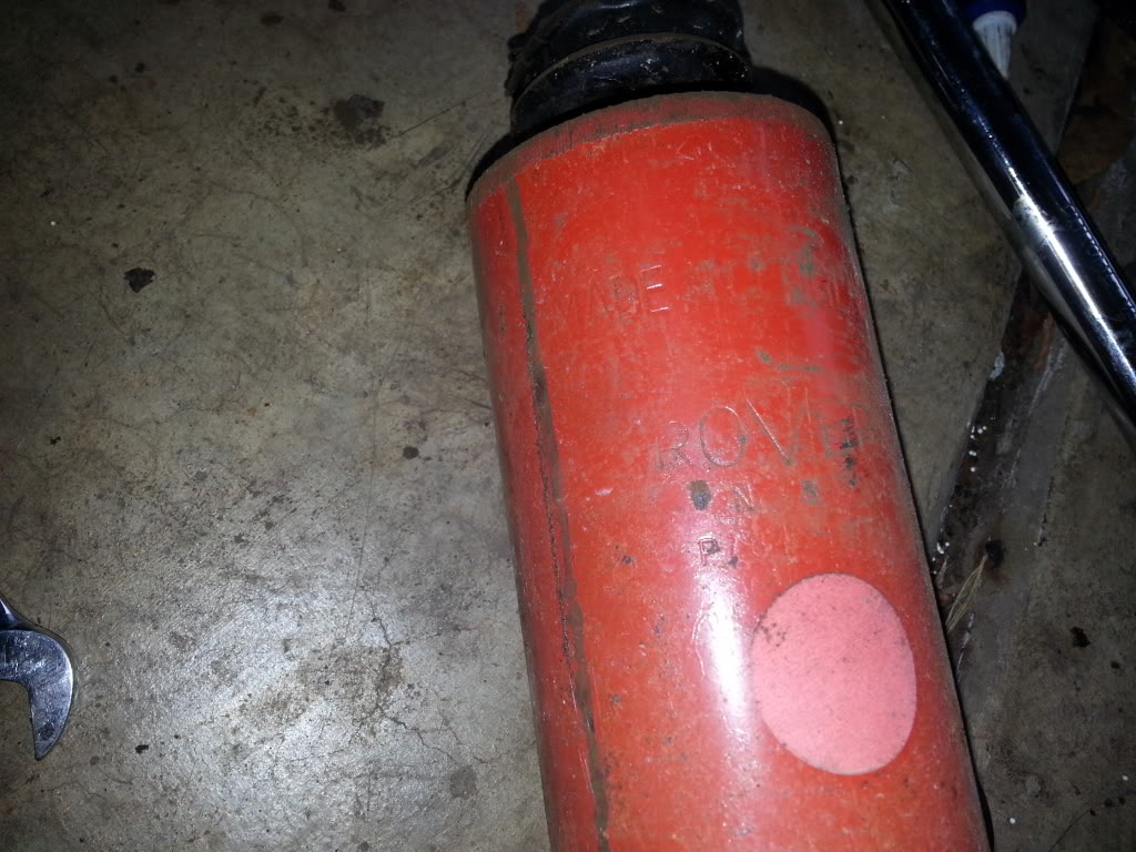

Likes: 1,753

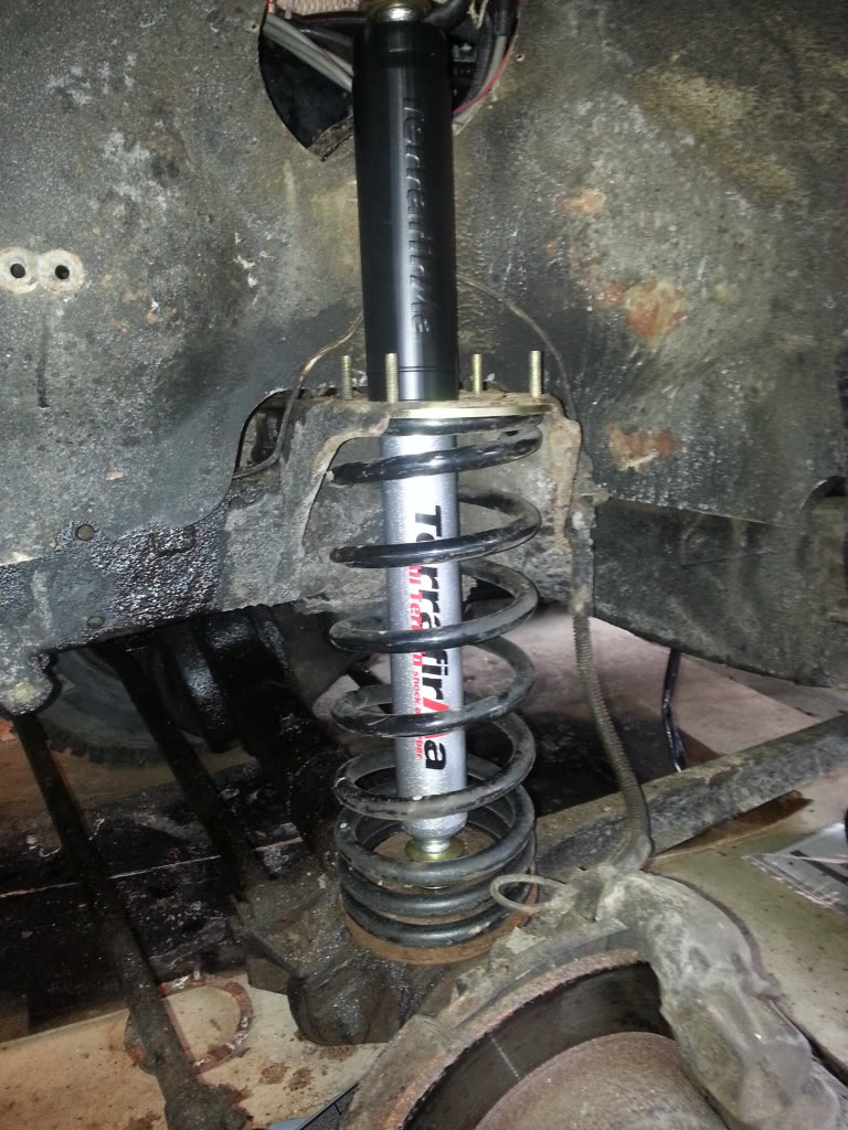

Got the fronts done today with new shocks and springs. One shock turret was rotted out lucky for me being a long time Rover owner I had 3 or 4 on the shelf. So it was a grab and go fix.
It was a definite improvement, the ride quality is good. Better than OME/Blings I've ran in the past.
Of course anything would have been an improvement over the original land rover shocks I pulled out.

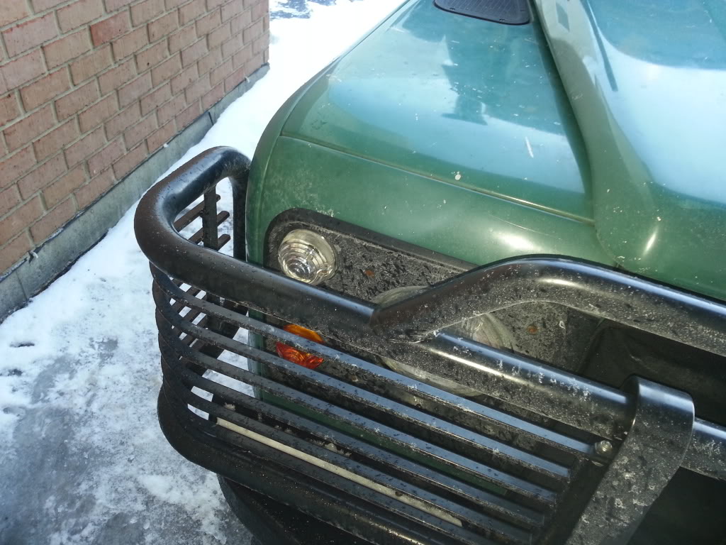

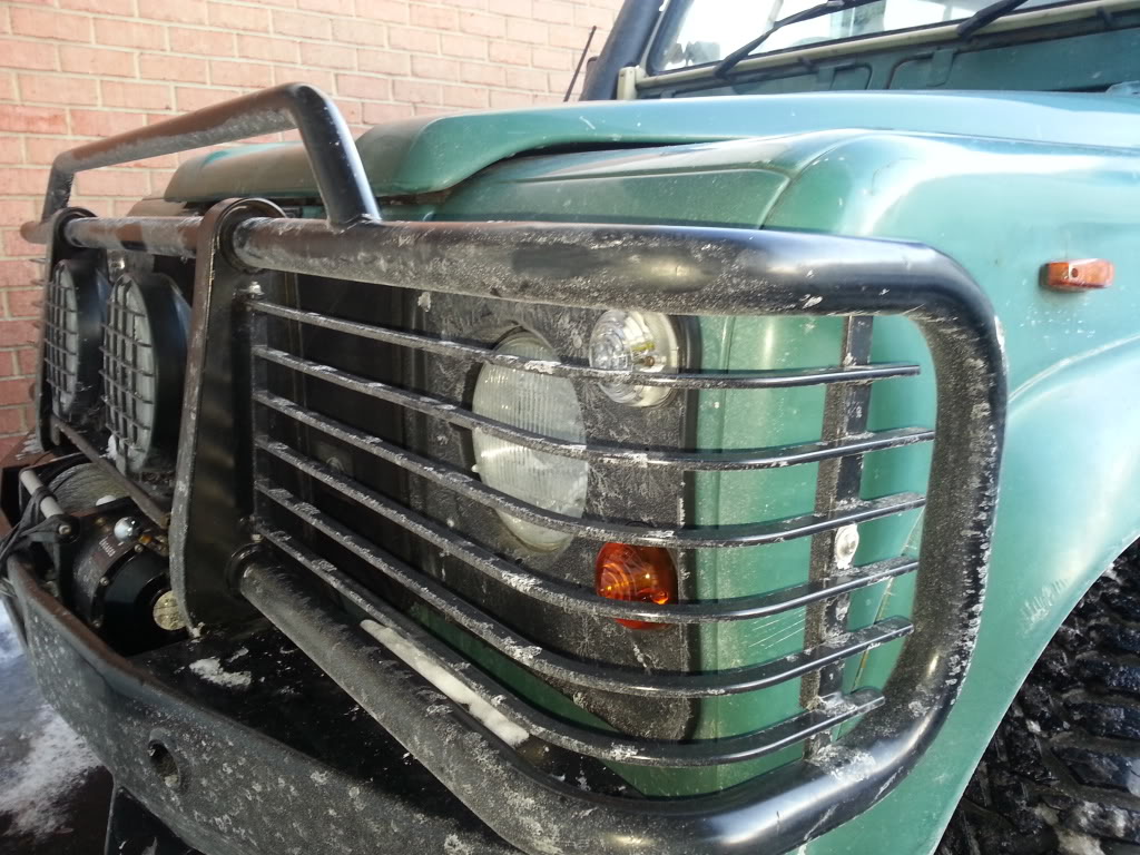

-3 and I went out to play with it a bit more. I replaced all the turn/stop/marker lights with new lenses from our friends at Lucky8. It's amazing how much the new lenses improve the look. The old ones were clouded and cracked. Now you might even see my brake lights now lol.

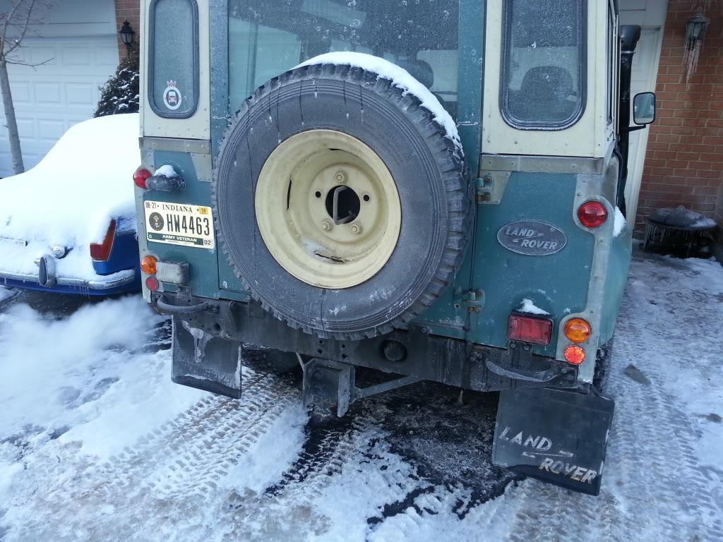

and a few pics of the new lights on the 110.
