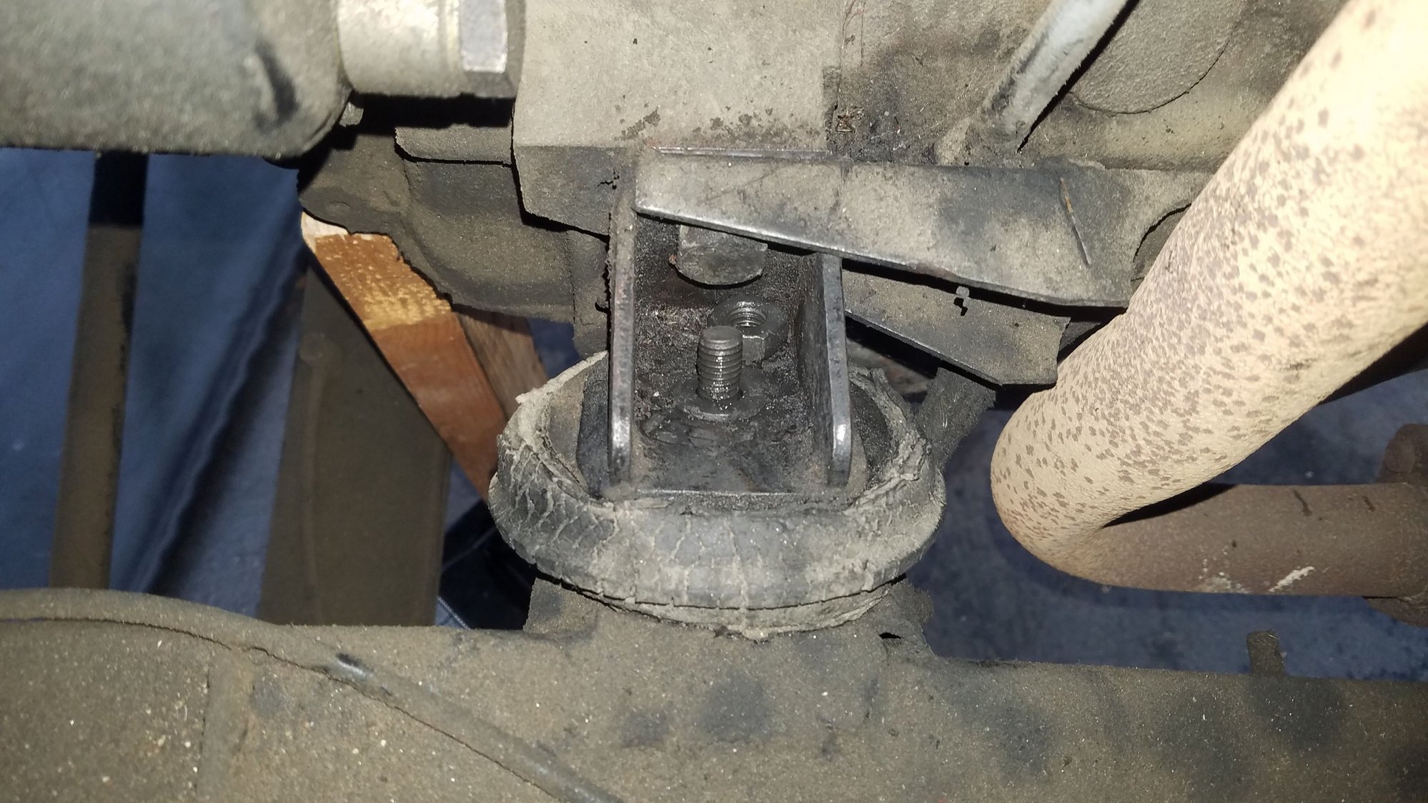

Im currently working on replacing the engine mounts on my LR 110 with 2.5 NA diesel engine .
I managed to replaced the Right side engine mount , but now Im having problems removing the Left side.
Unfortunately a socket or wrench would not fit to remove the top engine bracket bolt
the Lower bracket bolt is also hard to remove.
I been tried lifting the engine on the left side and no success getting the engine mount loose.
How much can I lift the engine?
Any advise?

You can lift engine high enough to remove motor mount, then you'll have accees to bracket bolts.
