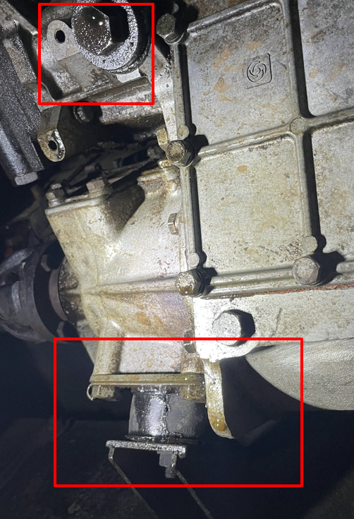

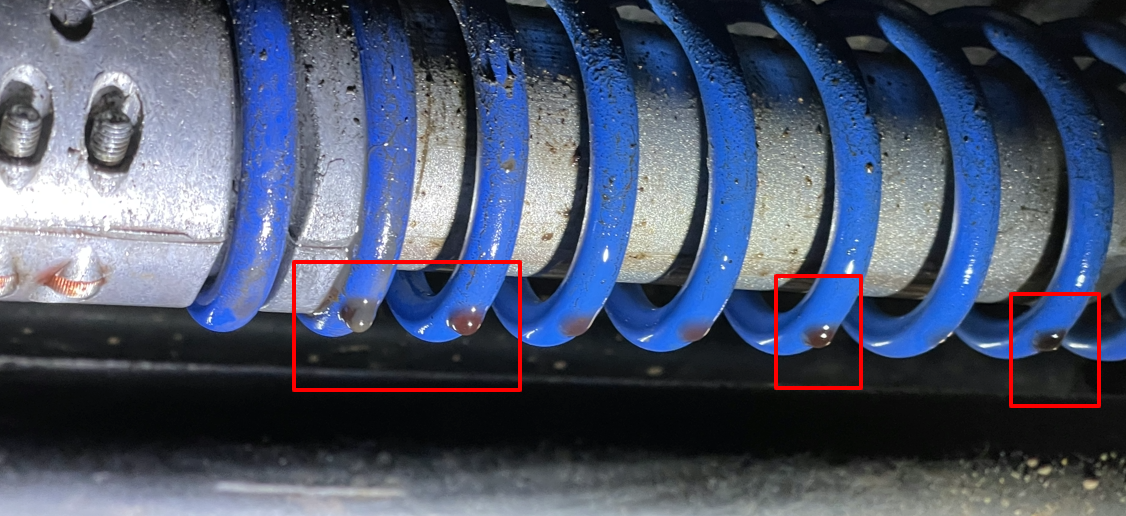

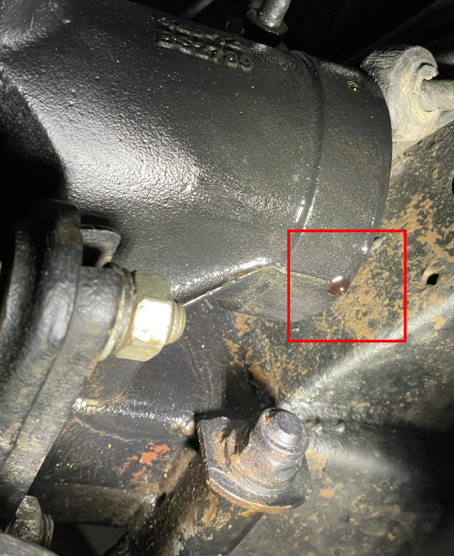

My name is Nathan. I just bought my very first Defender. It’s a 1987, 230.000km Defender 110.
I am an absolute newbie (every one needs to start somewhere, right ?).
I have read that Defender usually leaks or seeps quite a bit.
But are these leaks allright ?
It seems I’ve got one on the steering, another one on the coolant liquid tank, and on the front and rear axles.
Thanks so much for your help !

There is nothing, quote, "normal" about a leak, no matter what the vehicle brand.
Clean the areas up by degreasing and power washing, run/drive a short distance, then try to detremine where leak is originating from. After finding source, make repairs as needed. Most LR's have just been neglected and need maintenance brought up to date.
Welcome to the LR defender forum.
