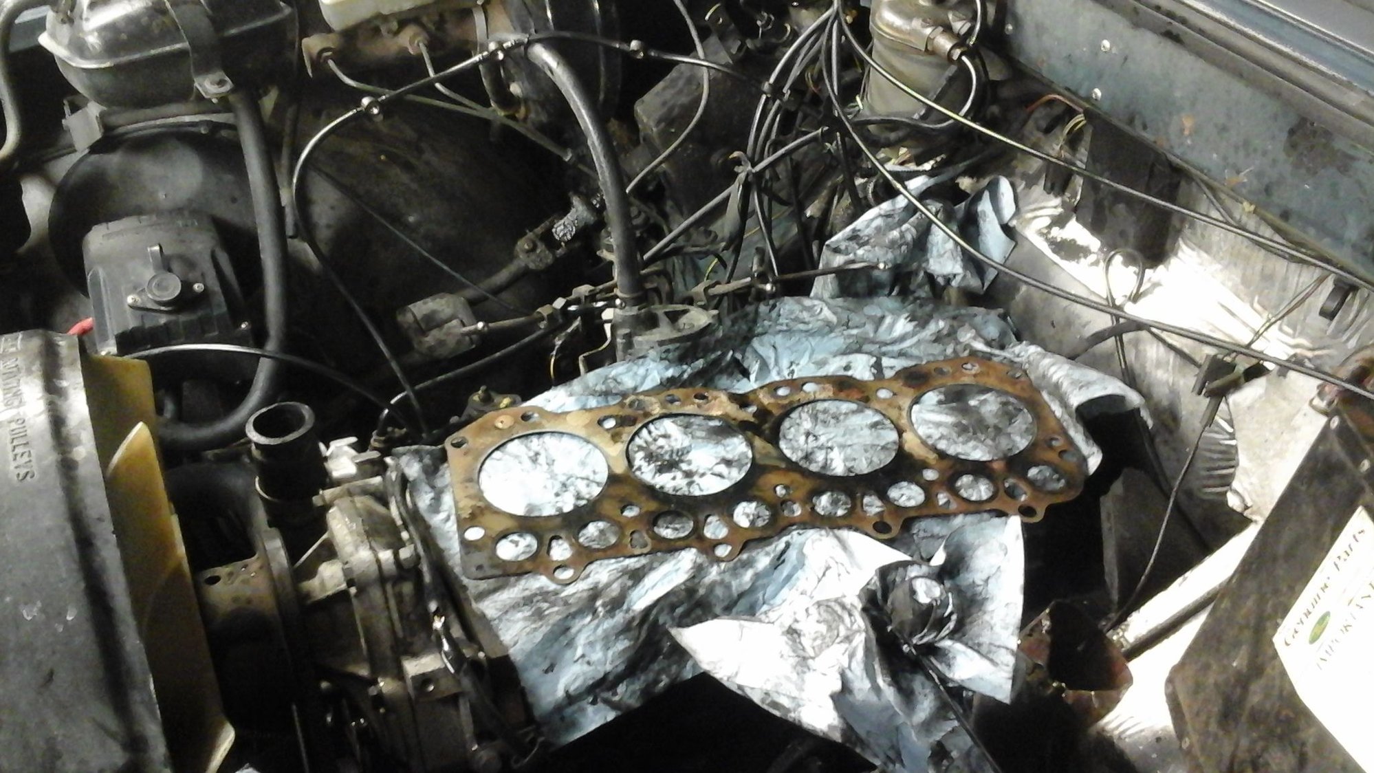

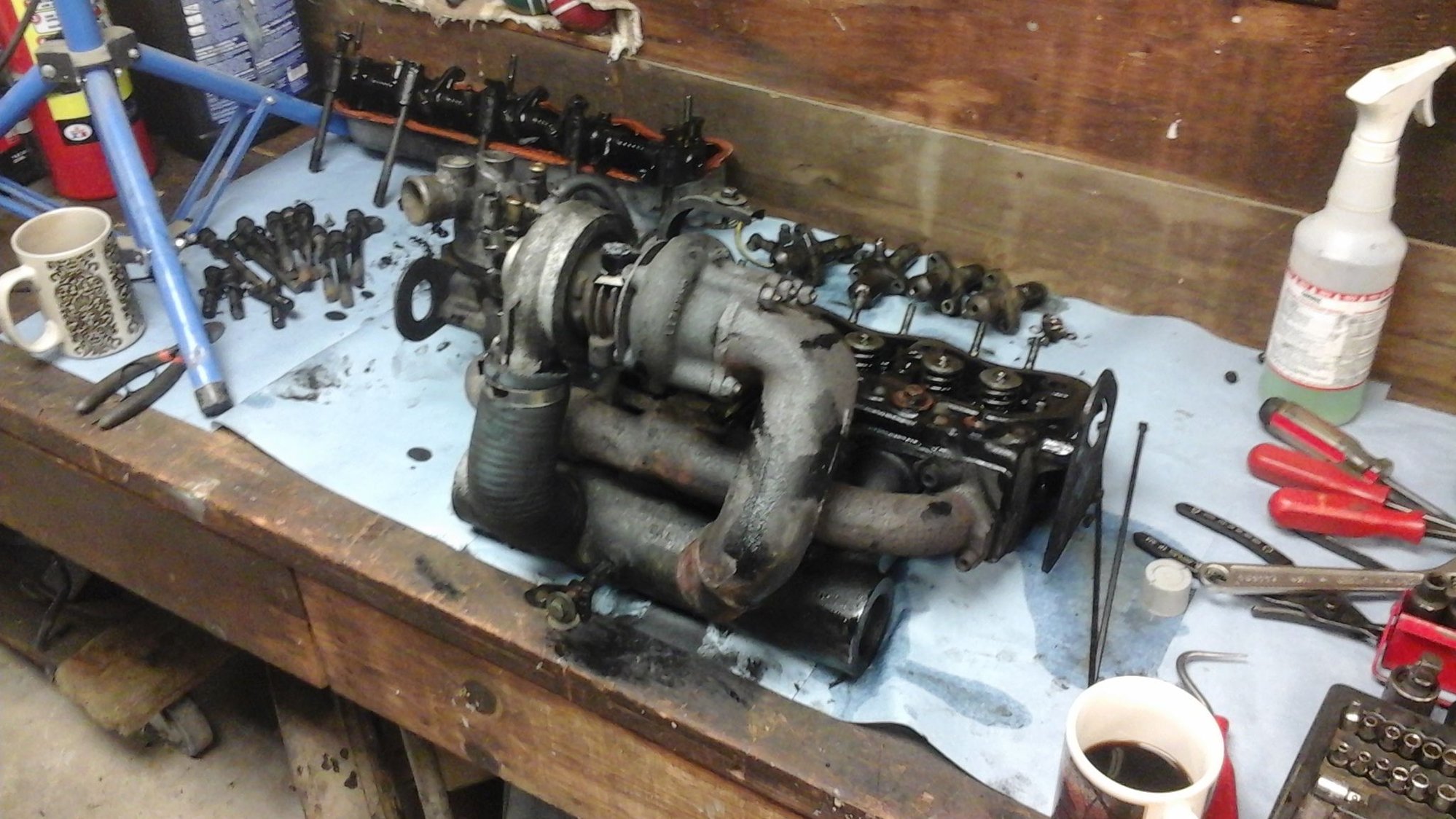

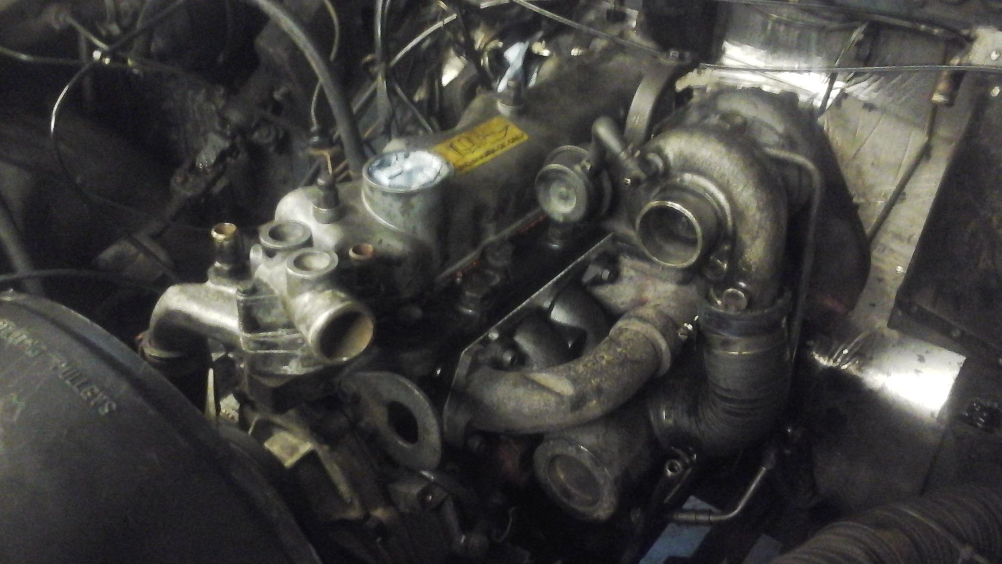

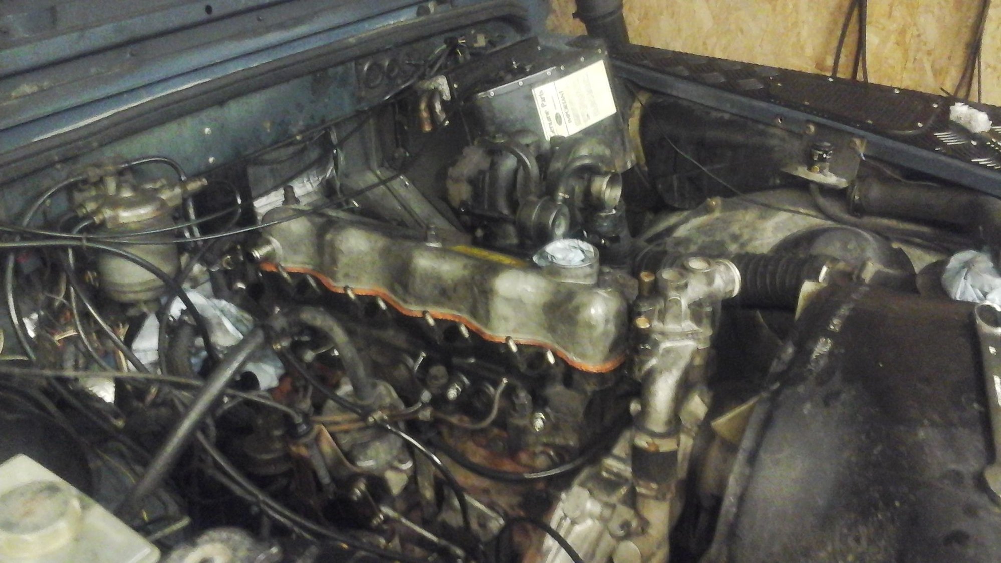

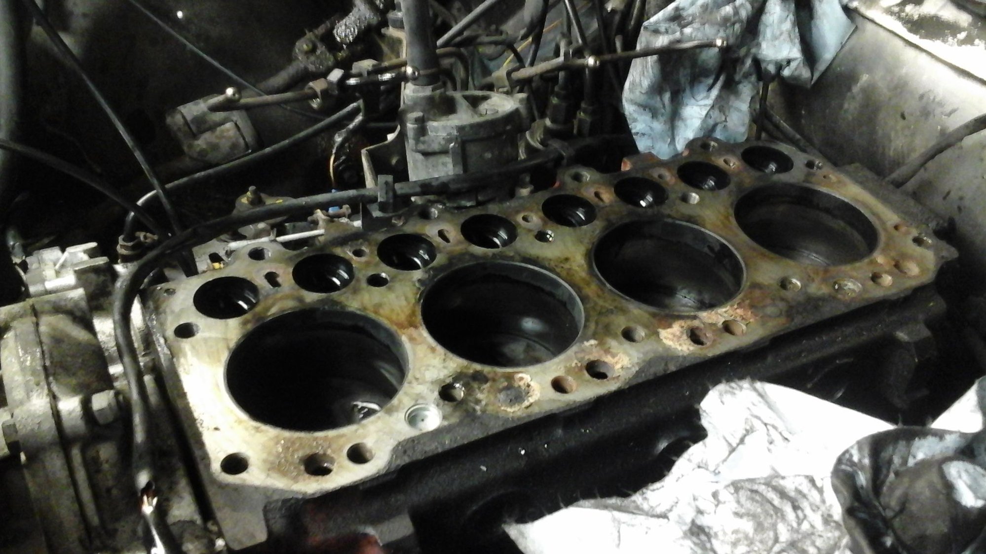

Over the last few days...
All started with a simple head gasket replacement, but after cleaning and inspecting things...noticed three of the four pistons wrre cracked.
Odered pistons and they arrived in five days from England...pretty impressive. Honed cylinders and cleaned up surfaces during that time.
Installed pistons and bearings, intake and exhaust manifolds and rocker arm/valve cover.
Hopefully tomorrow will bring good fortunes and she'll be running again.
Brian.

Is that common for pistons to crack? We do limited service on small industrial diesels and I've never come across it. What makes it happen?
Known issue with the 2.5TD, they "supposedly" corrected, issue showed up when they first added the turbo to the 2.5NA and saw the problem shortly afterwards...but, obviously...they didn't. They said it was less common in later years (more common in mid 80's), but mine is a 1990 and the last year of this engine...and l was just lucky enough to get in on the issue! Imagine my joy...lol. l guess the piston lands were not heavy enough and cracked across the center opposite of the wrist-pin bosses.
