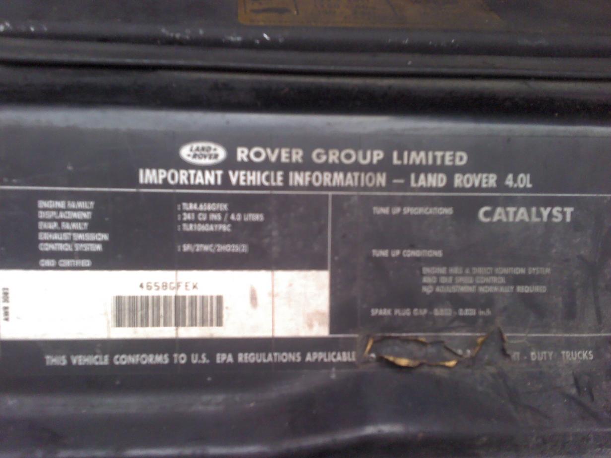

appears I have:
VLR1060AYPBC - Standard Evaporative Loss System
So that's non-AEL right?
i rapped at my cats too and they sounded good.
so 4 sensors. ouch.

If you are not positive, but still want to replace them, start with the pre-cat O2 sensors. The post-cat O2 sensors do not affect fuel trim. They only tell you if the cats are working properly.
